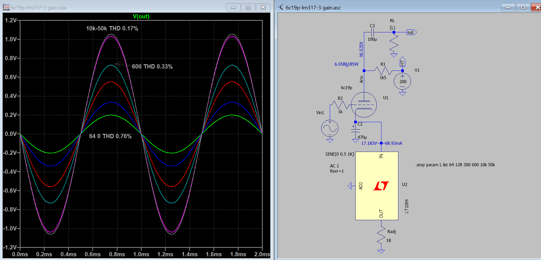

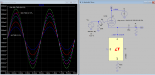

My 6S19P Linestage
Schematic image not found. So I came up with my schematic. The plate is 50V, current is adjustable (20m-60m) so as grid is biased between -5v to -8v, lowering bias reduce distortion when load is low. Zero feedback.
