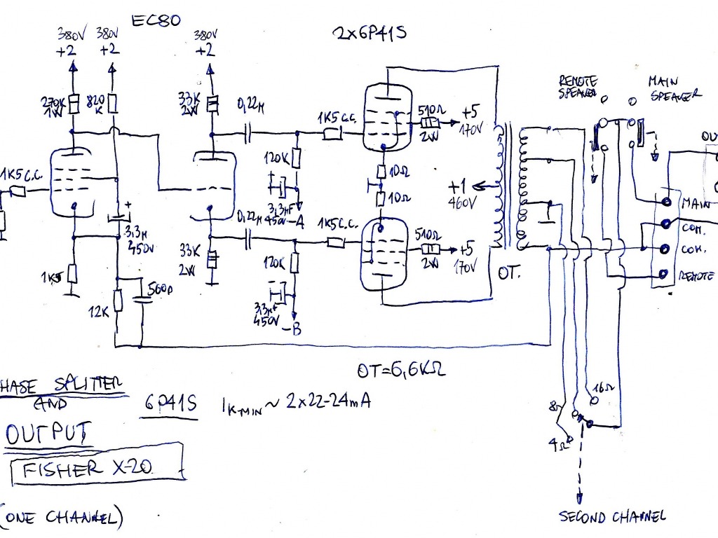

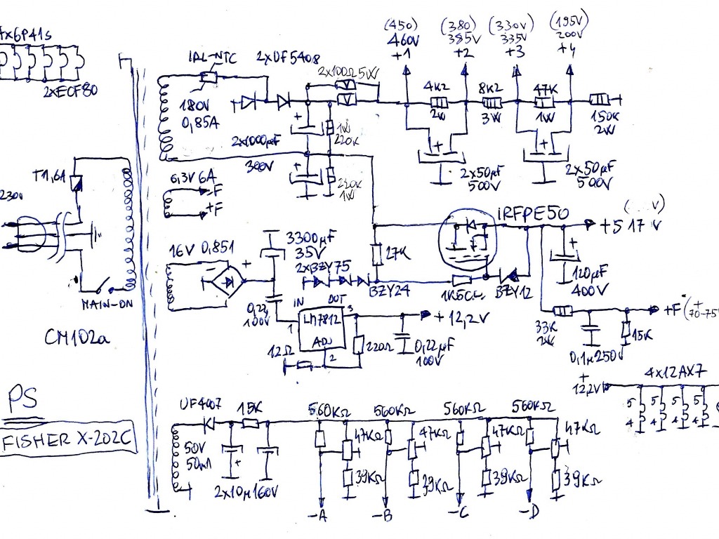

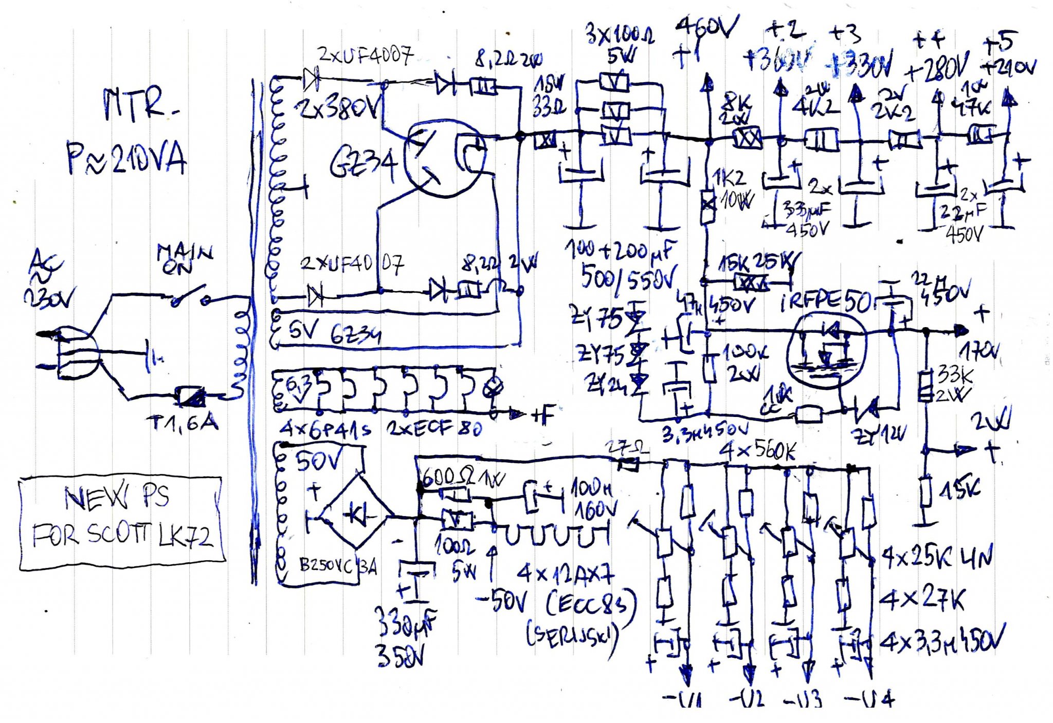

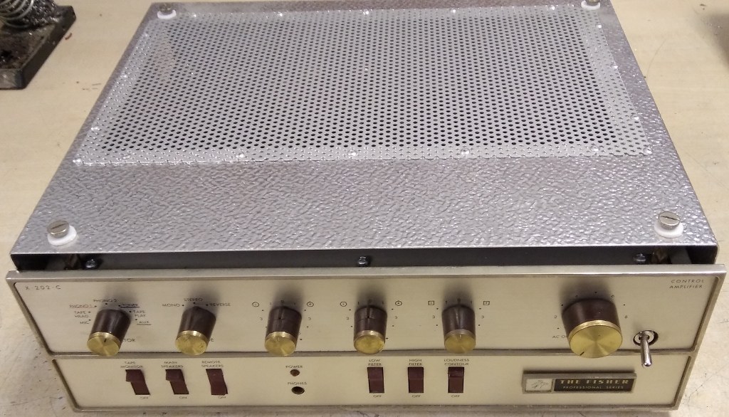

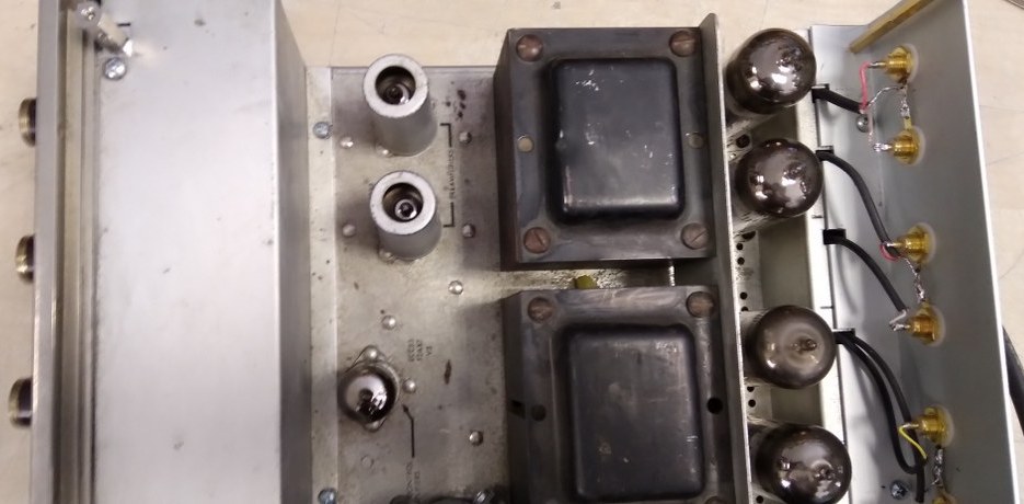

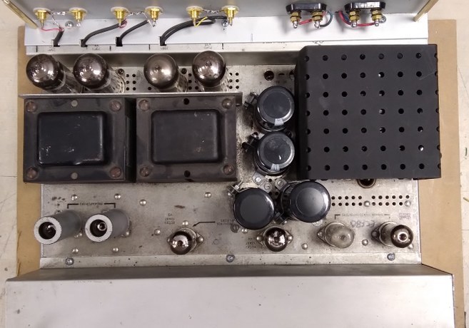

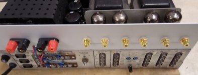

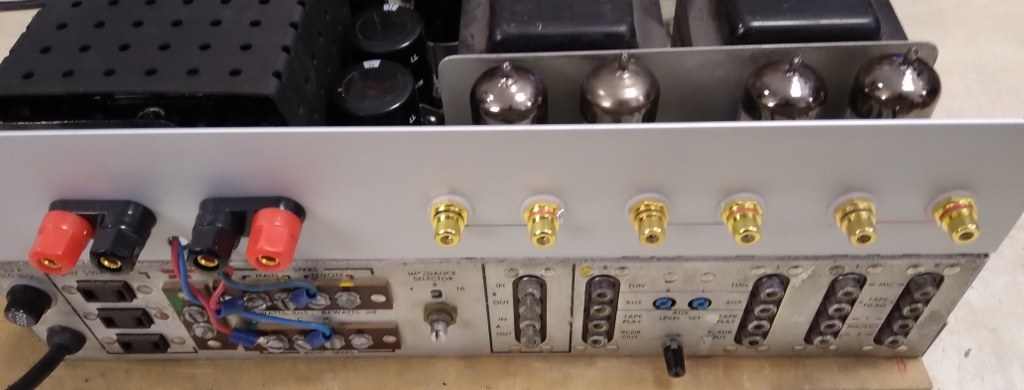

I replaced the 7591 tubes (very similar to the 7868 tubes) with 6P41S at the service of 2 amplifiers: "Scott LK72" and "Fisher X202C" where they work very well, maybe even better than the original 7591. Of course the voltage on G2 is stabilized at 150V and the negative voltage voltage G1 adjusted according to the criterion of the smallest distortions.

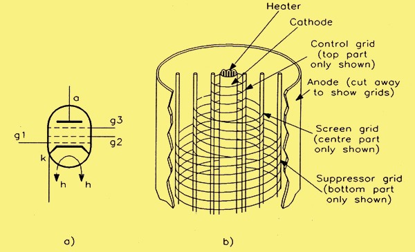

I was thinking about the “screen grid sensitivity” of the 6P41S (and even worse 6GT5 - thanks Tom) compared to the 7591/7868 family, and I am trying to understand the tube anatomy that is at play here. Why is the 6P41S not able to take the screen grid voltage a good 7591 (NOS or recent) can?
Is it purely the proximity of the screen grid to the control grid? Does that also determine the transconductance? And gain?
My question is: Since the 7591 and 6P41S have similar transconductance (IIRC) why can the 7591 live happily with 400+ volts on the screen, while the 6P41S is limited to ~170 V? I must be missing something.
A clarification: In my post #14 I used an illustration of a pentode. I should have used a tetrode, since the 6P41S is a tetrode, but couldn’t find one in my haste. The point/question is still valid, though.

I dont think that the internal construction has anything to do with it.
There won' t be any flash over in a vacuum just because of voltage as such, no gas assumed.

I think it has to do with the pitch of the screen grid - a more tightly wound grid will attract more electrons and dissipate more power. A looser screen grid winding can operate at a higher voltage and has to to get the same peak cathode current. Triode connection is easy on the scree, as the plate never drops below the screen voltage as it does in pentode mode - the highest dissipation condition for the screen.
