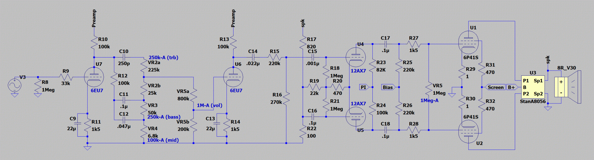

  • The preamp is basically RobRob's BlackVibe, minus tremolo and reverb. My original plan was to use an Accutronics BTDR-2 for reverb, but I ran out of places to put a pot and I couldn't figure out exactly how to integrate it into the circuit. Hanging on to that one for another future project.

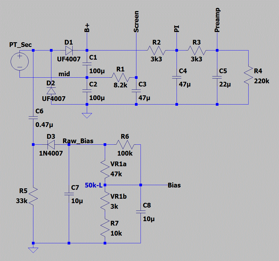

  • The power supply worked out as planned, taking advantage of the half-voltage node in the doubler to run the screens.
  • B+ is 455V, with 450V on the plates.
  • Screen is 215V.
  • Bias is -40V from a cap-coupled supply.
  • Dissipation is about 17W.

Here's the power and bias supply as built:
And here's the circuit as built:
