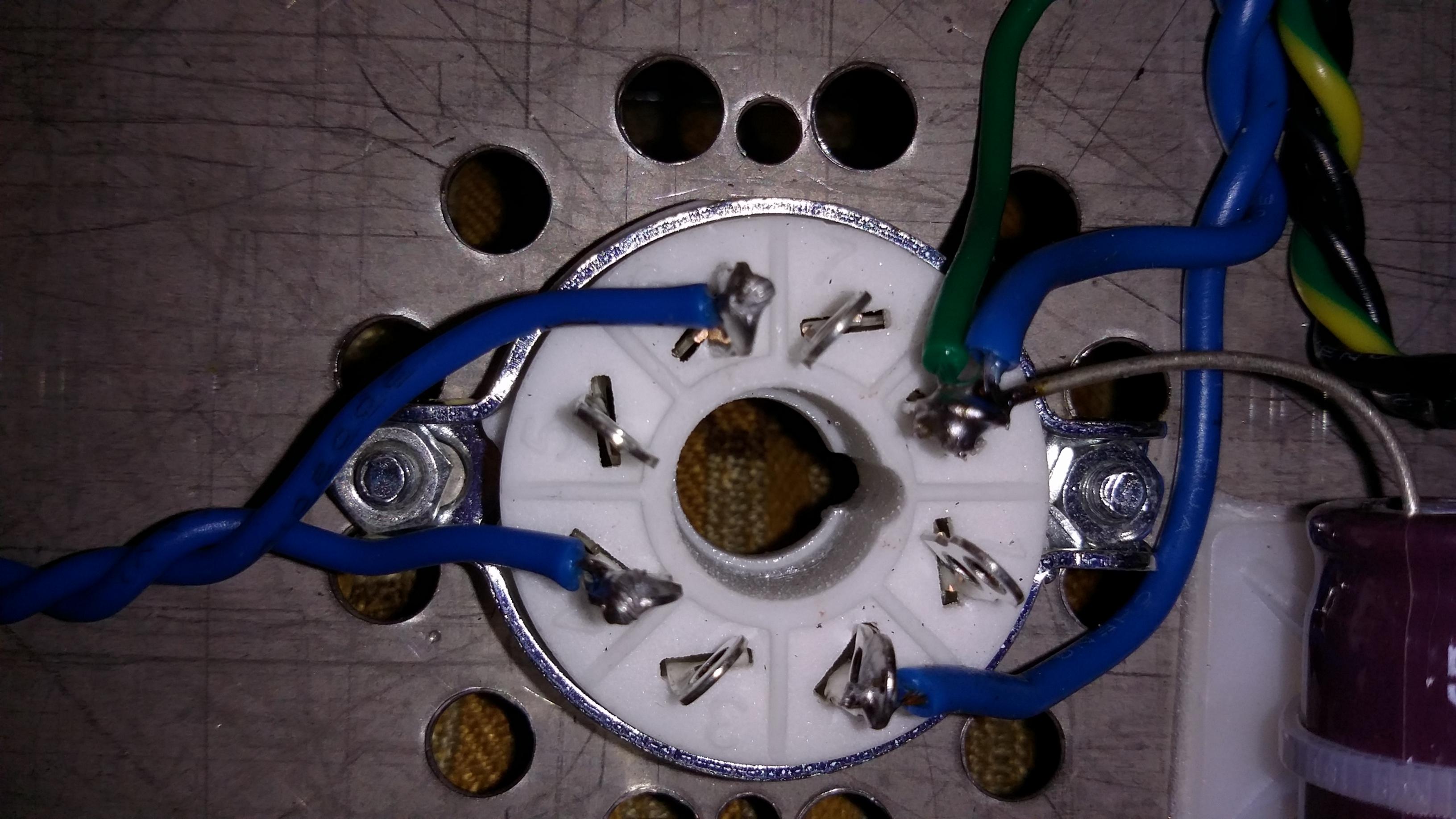

I hope you are right... I did installed based in my previous 6P3P...One of my checkings was to unmount the opt trans. and check the label underside and with google check the colors (they are in chinese) ...they state red to plate and blue to B+ so I did that. I did not try reversed because my lack of knowledge if that way was going to blow up something....
Best Regards,
Jorge
You should have a bypass cap there across the 330ohm resistor from pin8 on output tube to ground - you should have a 470uF 35v cap there - that is there to keep the amp from oscillating.
At any rate - that wont fix your low output. Check to be sure you have your circuit wired properly from driver tube to output tubes. Unlikely BOTH output transformers are bad, more likely something is loose and not hooked up solidly. Start at the RCA inputs and follow your signal wires all the way to the output tubes plate and grid connections, also double check your ground connection to the speakers on the secondary side of the OPT. You're most likely missing something easy.

Hi Bob,
Thank you very much for your help, I appreciate.
The bypass cap I am referring to is the cathode resistor of the 6N1 driver tube. In my former amp there were only the 1k resistor in pins 3/8. In the new one there is a 1k resistor followed by a 100R and bypassed the 1k with a 100 mf cap. at the joint of the two cathode resistors there is the injection of the feedback from the 10k feedback resistor and 8 Ohm sec connection.
I am going to check all the connections for another time, I hope is a human fault...😕
Jorge

Ok thanks for clarifying - I built mine without any cathode bypass cap on the driver tube. That should make the amp sound better for sure. Check signal wiring I bet something is not connected.
Bob
Problem fixed
Problem solved. 😀
OPT transformers ok. I really do not have a good idea of what was the problem, but as Bob pointed (Thanks my friend...🙂 ) I reinstalled signal wiring and ground line and voila....all ok....now.

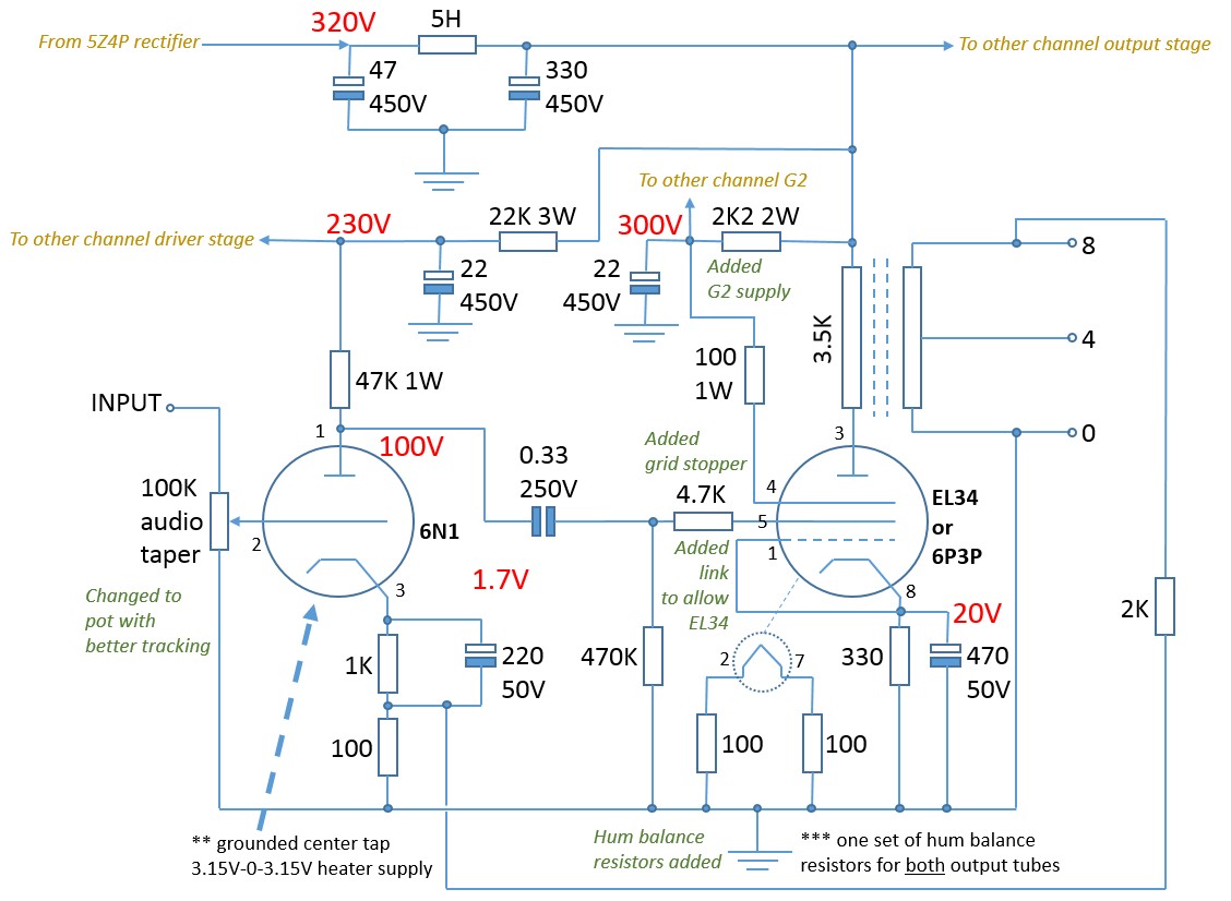

I have built the "improved" version of the amp (slightly different feedback loop design) and tested it pretty extensively. It works best as a SEP (single ended pentode); the driver stage does not have quite enough gain for triode mode unless you remove the feedback loop. The transformers are not great for triode mode; it sounds a bit boomy and slow, so I don't recommend triode. My schematic, posted below, sounds great and places the output tubes into pentode mode more safely than the original version (runs G2 at a lower voltage than the anode to avoid melting the screen grid). The original ties the screen grids to B+ and thus places them at a higher DC potential than the anodes.
It also sounds a lot better this way 🙂
I'm still not really convinced that 3.5K primaries are good for SEP mode for either an EL34 or a 6P3P, but I haven't done any calcs - just my gut tells me it should be higher.
By the way, get rid of that volume pot - channel balance is so far off it is a joke - it really doesn't cost much more to get an Alps - maybe you could offer it as an upgrade?
