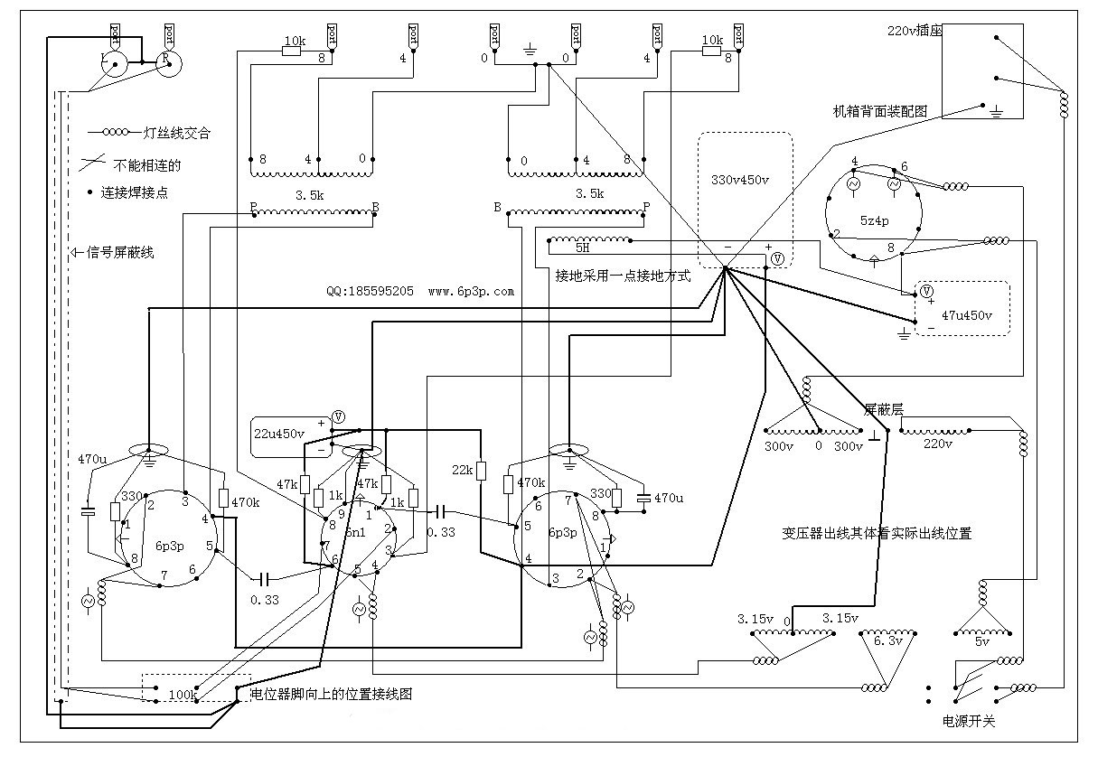

I have built the "improved" version of the amp (slightly different feedback loop design) and tested it pretty extensively. It works best as a SEP (single ended pentode); the driver stage does not have quite enough gain for triode mode unless you remove the feedback loop. The transformers are not great for triode mode; it sounds a bit boomy and slow, so I don't recommend triode. My schematic, posted below, sounds great and places the output tubes into pentode mode more safely than the original version (runs G2 at a lower voltage than the anode to avoid melting the screen grid). The original ties the screen grids to B+ and thus places them at a higher DC potential than the anodes.
It also sounds a lot better this way 🙂
I'm still not really convinced that 3.5K primaries are good for SEP mode for either an EL34 or a 6P3P, but I haven't done any calcs - just my gut tells me it should be higher.
By the way, get rid of that volume pot - channel balance is so far off it is a joke - it really doesn't cost much more to get an Alps - maybe you could offer it as an upgrade?

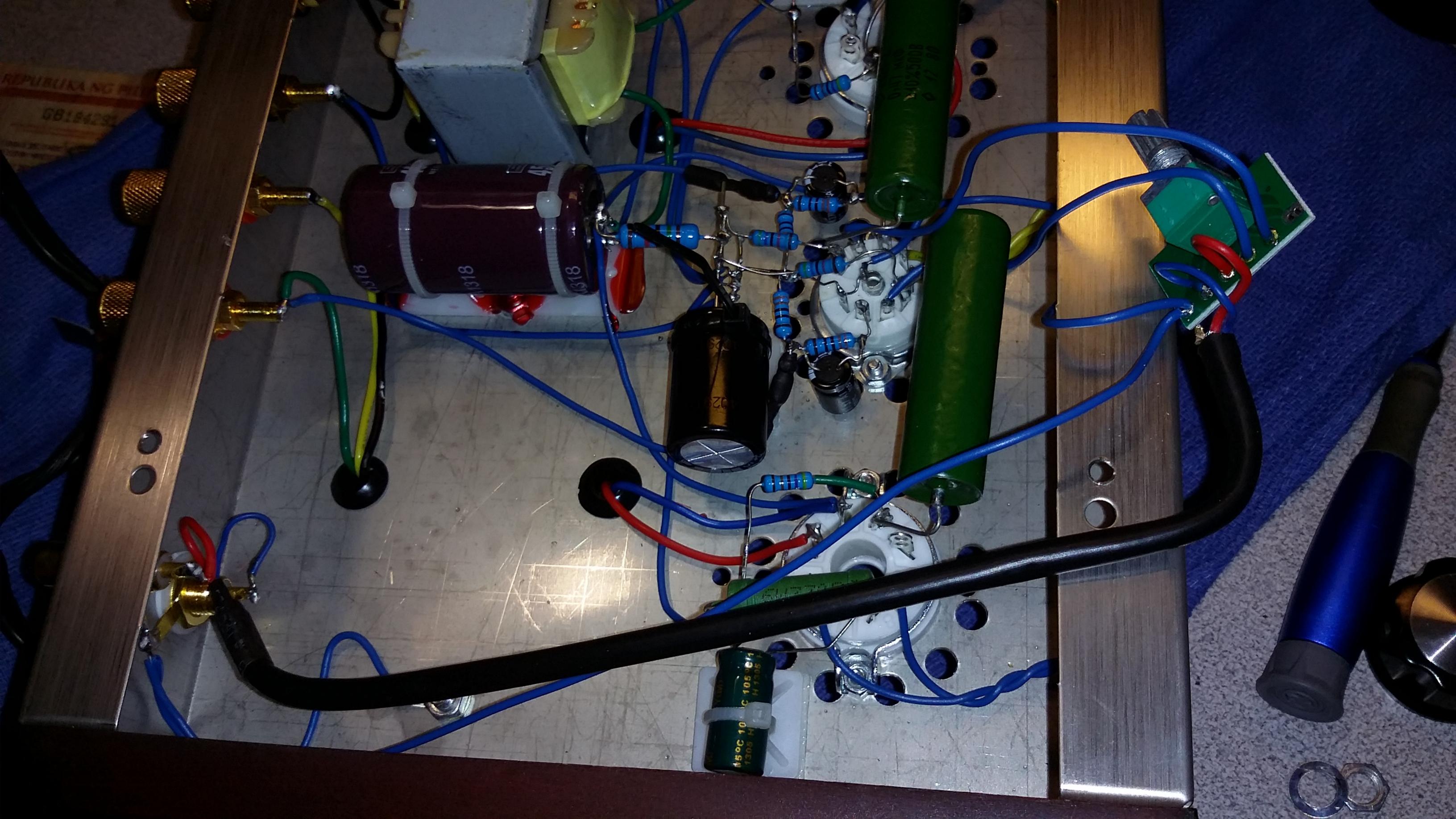

I did modifications according raindance instructions. It really sounds a lot better this way!! I use 1x6N1P and 2x6P3S russian tubes and full wave rectifier GZ32. Changed all capacitors to a better quality (Vishay, Panasonic, russian PIO). Changed volume pot to a Alps Blue Velvet RK27112. Thanks again for the good upgrade recommendations!!

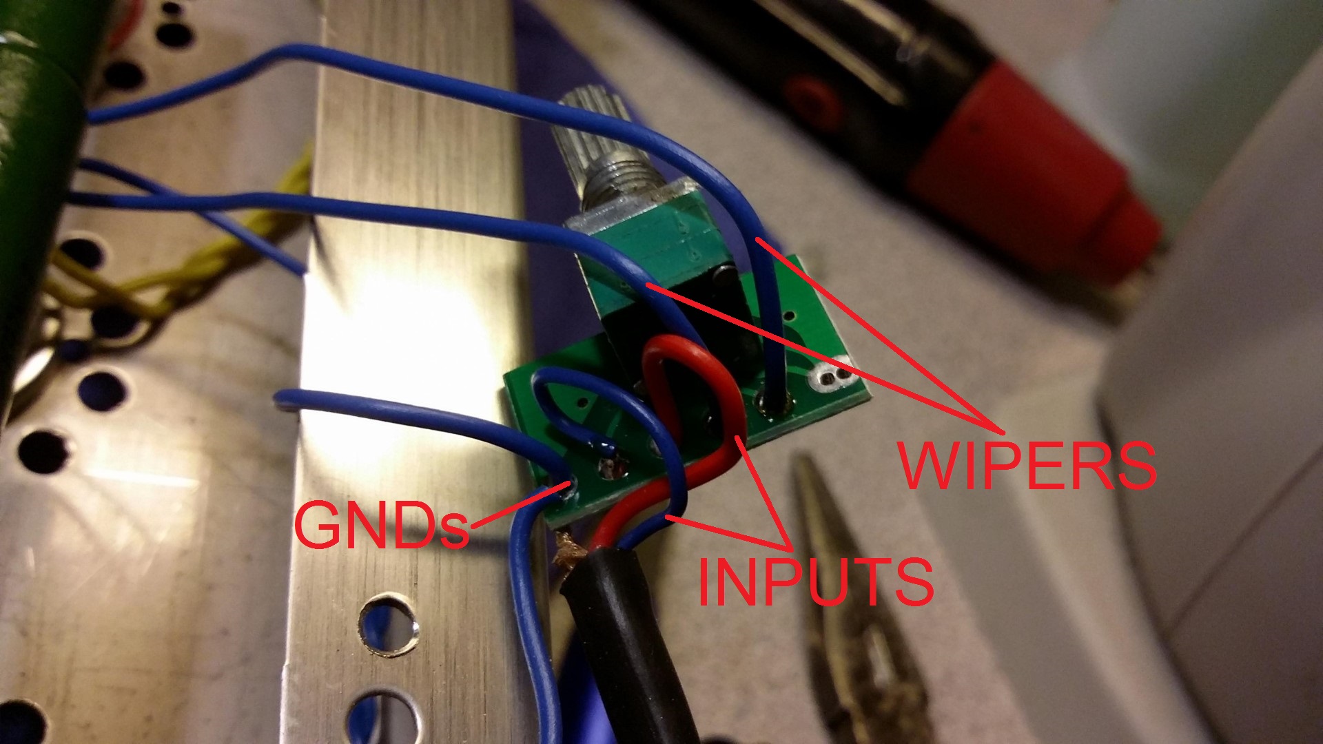

I did change my caps to PIO caps and replaced all the other caps with a panasonic caps, but that's the only the I know how to do. Can you tell me how you replaced the pots with alps, I want to do this or just replace it with a resistor but then again my knowledge is not that deep. By the way I did change all my tubes to russian tubes and the 6N1P to a 12au7.
Buy Alps RK27112 100kOHM Logarithmic POT. Remove crappy stock pot, desolder R, L and GND wires from it. Take Alps POT. Align hole diameter to fit Alps POT. Put Alps POT and fasten it. Solder signal R, L and GND wires back according image:
Buy knob for the POT: 30 25mm Volume Potentiometer Rotary Pointer Knob DIY Machined Aluminum Silver 1 | eBay
And bingo!! You have good sounding, good looking POT 😉

Hi cheehpogi,
In your case pinouts are the following:
http://www.diyaudio.com/forums/attachment.php?attachmentid=512829&stc=1&d=1446709601

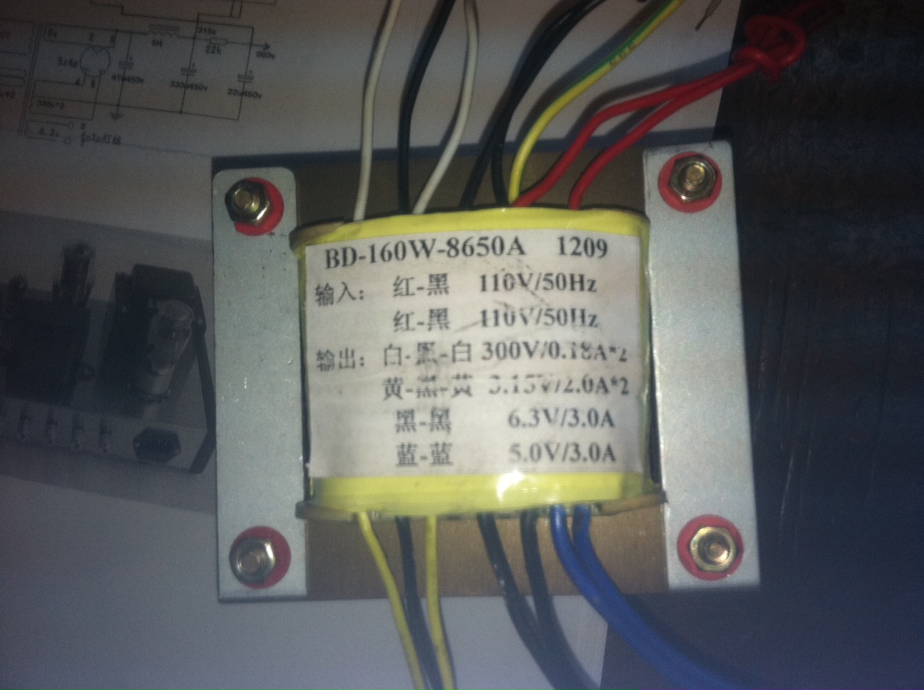

Hi I just got one of these 6P3P kits. I was wondering if I should hook up the yellow/green (center tap?) wire to the star ground. The schematic i got with the unit it looks like you possibly attach the 3.15V ground to the yellow/green center tap. (Sorry I don't have an example of that). In the wiring diagram below the 300V ground and 3.15V ground definitely go to the star ground. I have hooked up the two red wires and black wires in parallel for 110v. Thanks for any help. I have been reading this thread but have not seen an answer.
red-black: 110vAC
red-black: 110VAC
white-black-white: 300V 0.18Ax2
yellow-black-yellow: 3.15V/2.0Ax2
black-black: 6.3V/3A
blue-blue: 5V/3A
http://www.diyaudio.com/forums/atta...e-amplifier-kit-power-tranformer-6p3p-amp.jpg

If you look at my schematic, I modified it for use with EL34. I also suspect that you are calculating the bias incorrectly - it should be about 85-90% of max due to the single ended design. Did you see the voltages on my schematic?
