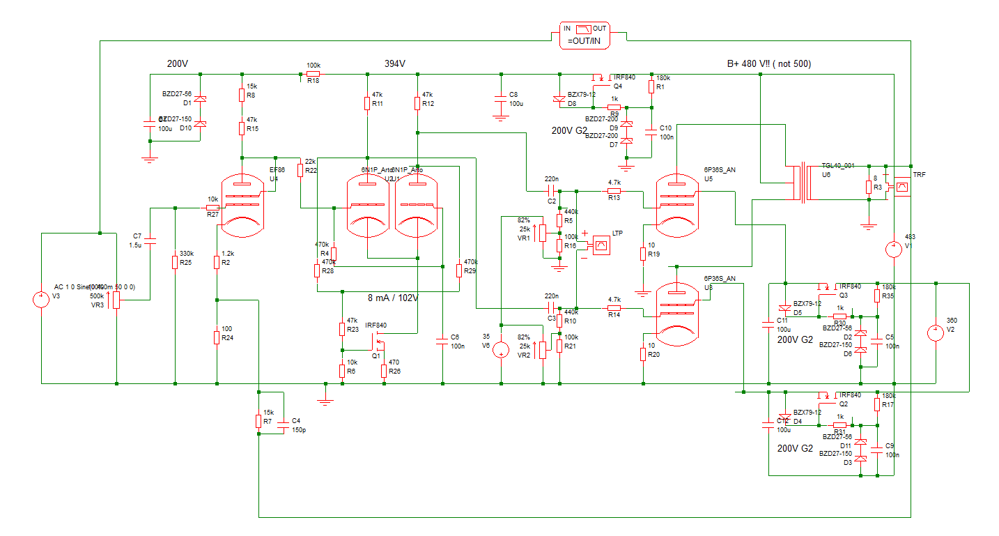

The schematic of Artosalo is suitable for direct coupling prestages without interstage cap /that will be better for sounding/, if You will adjust the mode of phase splitter /in Your place I will do it.../
That would be a good idea too! Good coupling caps are a bit more expensive, and introduce phase rotation. I need to study this option, something tells me that this would be the way to go.
Do you mean C22 ?
I don't comment about the sound at all, because it is fully subjective and definitely varies according to listener.
Technically speaking, it is preferable the optimize both, voltage amplifier and phase splitter separately. If these stages are dc-connected, this possibility is lost.
Typically the optimum operating point of voltage amplifying stage is such that the anode voltage is higher than the optimum grid voltage of the cathodyne.
Therefore dc-connection is a compromise.
I have studied this subject a lot and know how it is.
In such case when the drive voltage of the output tubes is low the dc-connection can work well. For example with pentode connected EL84 PP amplifier.

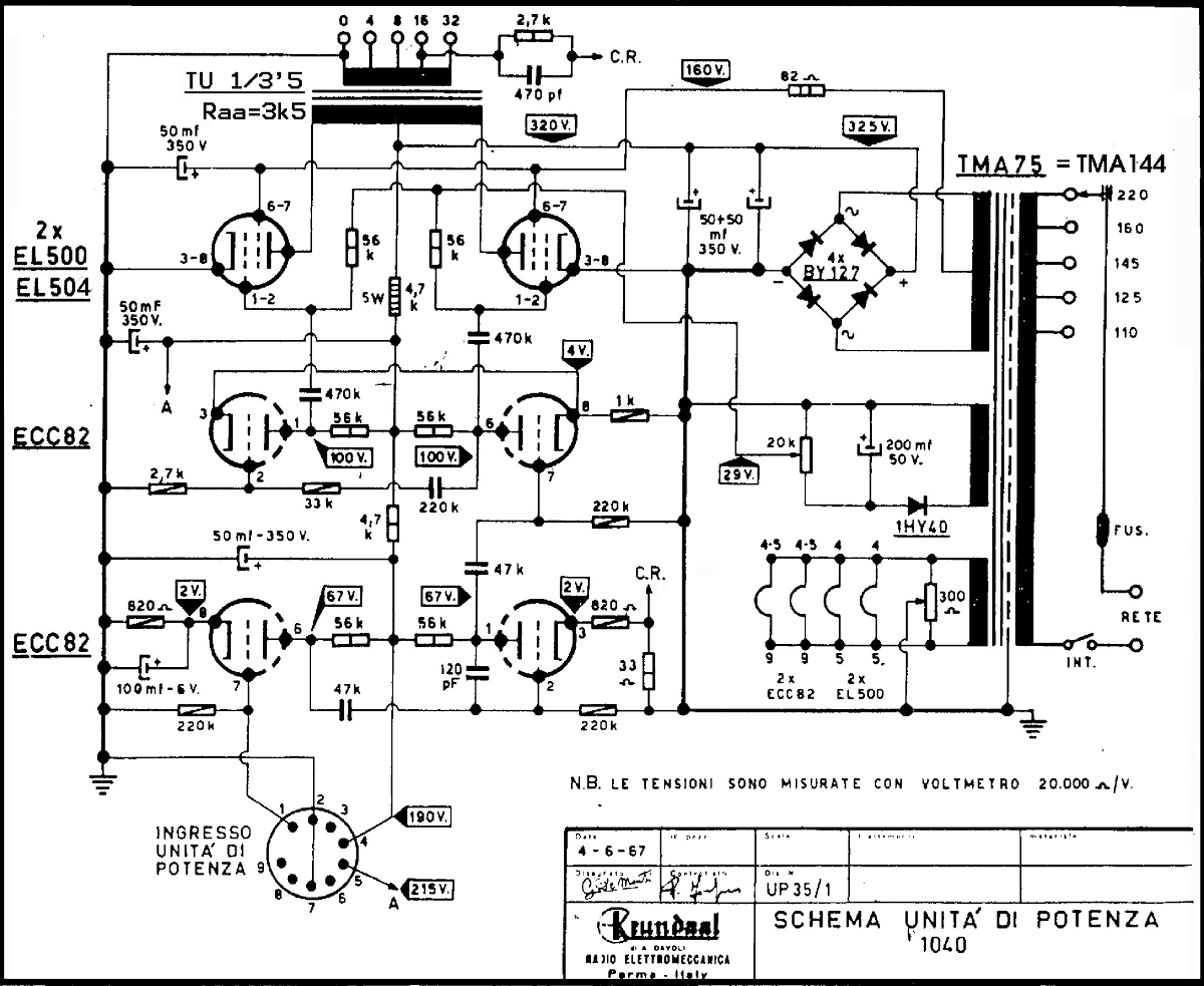

A good diagram that will not fail safe, EL500 (EL504) are equivalent 6P36S can set the 6P36S are even stronger and better than EL500 (EL504) ...

So here it is, more or less the final iteration for this amp I am experimenting since a while now.
Special thanks go to my friend and fellow forum user, Artosalo, for providing me with lots of great advices to achieve this design! Thank you, Artosalo!
It's a PP based on a pair of 6P36S, LTP phase splitter with 6N1P-VI and EF806S as input device. It's supposed to be around 75W or so in this configuration, I was not able to do any more in-depth measurements, as I don't have an oscilloscope. Anyways, I'm pleased with the result, it sounds pretty strong even so.
The OPT is an INDEL TGL40/001, 4k-to-8ohm part. Cheap and good.
The input stage is DC coupled with the LTP. The latter uses a sort-of bias servo with mosfet, inspired from the PL519 KaizerPower amp (and others), seen here, on this forum. This allows to automatically balance the splitter, without needing different anode loads. I've found that around 100V on the input grid of the LTP is a
The power supplies around the amp are all stabilized, perhaps a bit over-engineered. G2 is ast 205V, which was found to be optimum for this tube distortion and power output-wise. The tubes sit at around 38mA at idle each, this can be increased until 46mA, depending upon preference, and further study.

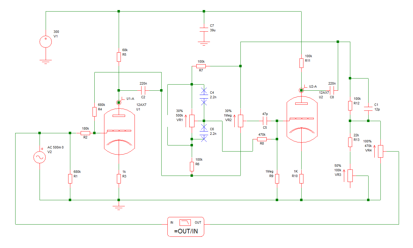

I've got a tone control hooked up at the input, it's Artosalo's design, with a couple of modifications for the tube and my personal preference for the sound of it. This is with ECC83's I've got lying around, unused.
Please comment on this!
