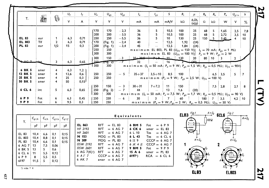

By the way, back to load lines: output resistance is dV/dI -- i.e. take small change of voltage on graphs and see which change of current it causes, then divide. It is simple. For pentode you will get huge value. That's why pentode amps always use negative feedback. Except special cases when designers want huge output resistance, for "current drive" of speakers.
Yes, Tolstoy was great writer and thinker.
6P15P is roughly equivalent to EL83 - a video output pentode. The Philips datasheet does not give any parameters for audio use.
EL83 will be better by straight parallel lines in pentode. What's good for the voltage-controlled current source.6P15P is roughly equivalent to EL83 - a video output pentode. The Philips datasheet does not give any parameters for audio use.

I didn't think of looking in the Vade-Mecum, but it often has useful snippets of data.davorin said:Here is data for audio amp (ClassA-SE) for EL83:

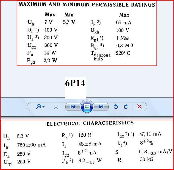

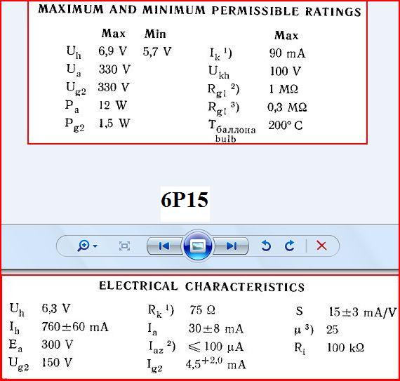

У 6П15П ветви смещения выгнуты посередине наружу, это значит, что приращение тока от приращения напряжения нелинейное, уши это чувствуют. По линейности она проигрывает EL83. Халява в очередной раз не проходит. Бесплатный сыр только в мышеловке.
In 6P15P branch offset dished out in the middle , which means that the increase in the current from the voltage increment nonlinear , ears, feel it.By linearity, it loses EL83.
