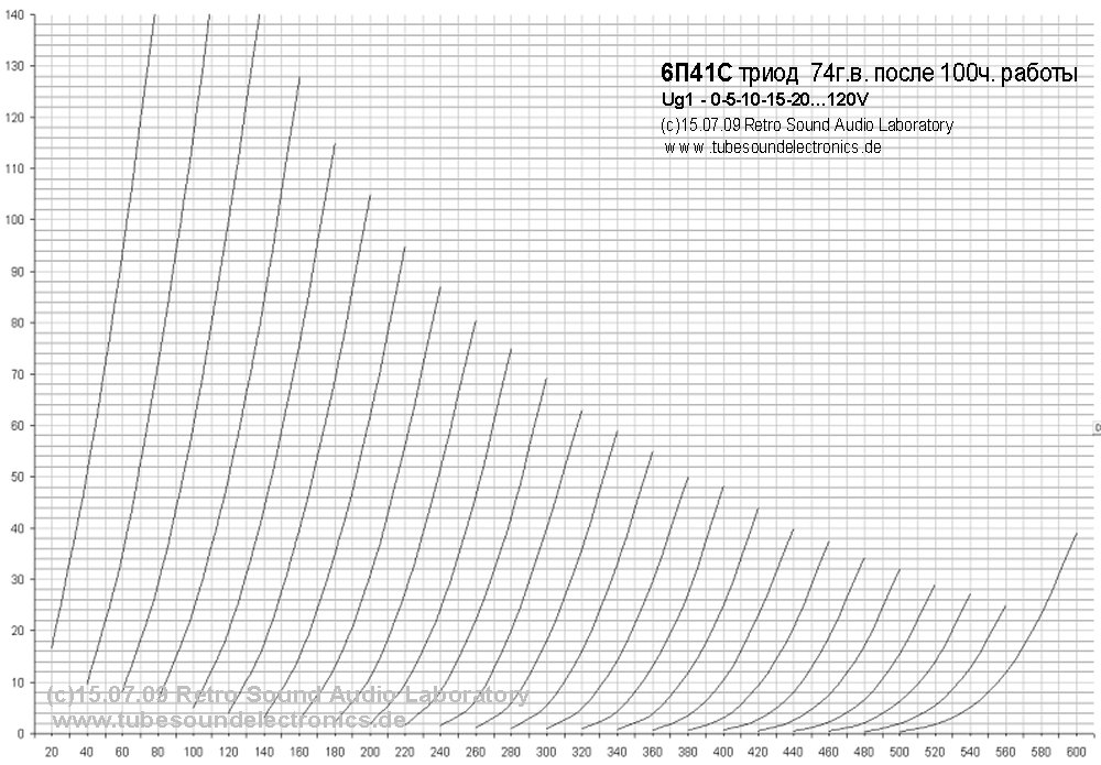

Mu > 20, rp < 1k5
Thanks very much. Eyeballing your curves (midpoint) mu is about 20 - high as I would expect, so a typical Ra is about 1.2k. I guess you'd have to run them quite hard then Ra would be below 1k.
A very nice valve I'd say. And in parallel push-pull triode mode, an easy-to-drive output stage for a high-quality ten watts or so.
Paul
Right. I used them to drive Gu-50 in Pyramid-VII amp, to drive MOSFET stage in Tower hybrid amps, now I use one more Russian TV tube, 6P41S. One more sleeper, more powerful. Pentode curves have relatively high 2'nd order error, but trioded it is nice, and pentode with local feedback it is much better.
The reason I was suggesting not applying voltage to g2 was to bring the power down to levels the output transformers can handle < 25 watts.
about power handling, that is a function of the B+, lower it and you get lower power......
power is also a function of turns ratio or reflected primary impedance....say your OPT has and 8k a-a resistance at 8ohm secondary with a pair of output tubes....now using 2pairs, the same OPT can be used to reflect 4k a-a load using the secondary's 16ohm tap to connect an 8ohm load...
i wouldn't worry about the output transformers, though rated for 25 watts, they can handle much more....read the post of tubelab.com and you will see...
