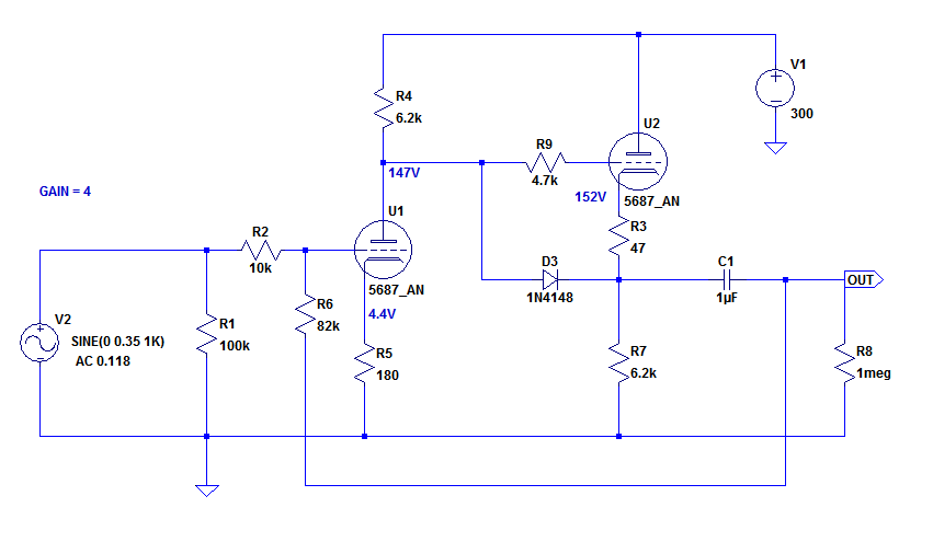

Marco audio Member Joined 2019 2022-01-13 12:32 pm #62 2022-01-13 12:32 pm #62 Hello,82k feedback loop resistor value is fine. No phase shift looked. Gain is 6. Attachments IMG_20220112_195936_8.jpg 383.8 KB · Views: 59 D dreamth Account Closed Joined 2010 2022-01-17 10:07 am #63 2022-01-17 10:07 am #63 What was the circuit of your choice? Marco audio Member Joined 2019 2022-01-17 10:40 am #64 2022-01-17 10:40 am #64 Hello,i will use a simple CCS for each triode, with the feedback loop , it seems to me ok. Prev 1 2 3 4 First Prev 4 of 4 Go to page Go You must log in or register to reply here. Share: Facebook X (Twitter) LinkedIn Reddit Pinterest Tumblr WhatsApp Email Link
