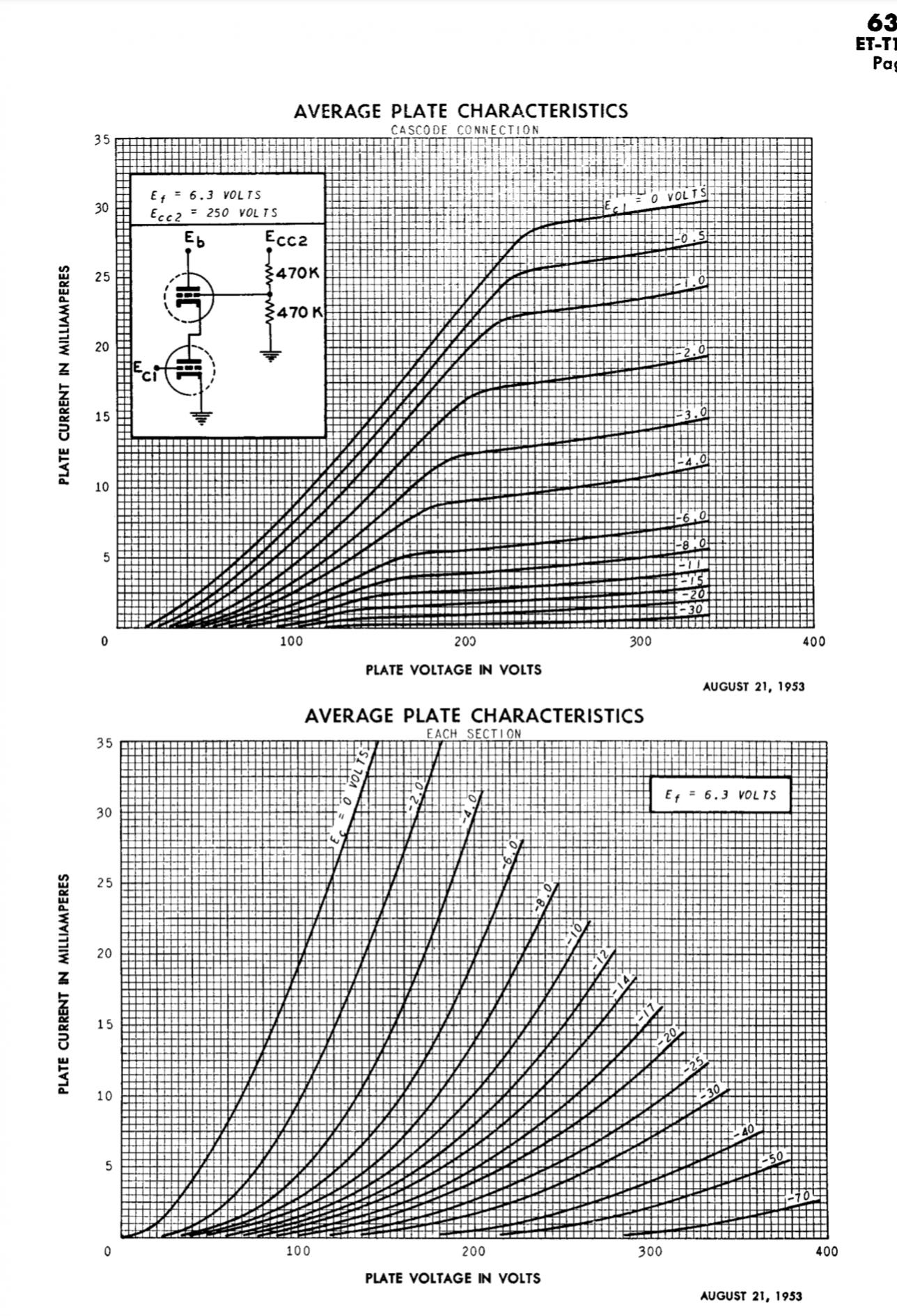

The curves I was looking for were from Tube Tester Files - 6N24P - 6H24P
Unfortunately, my results didn't match. For example at -5 volts 10ma my plate voltage was 175. . I don't have anything written down, but I did just get home and have a small bit of time before my weekend starts. I will try to get some concrete data to share.
Those almost flat lines at high negative bias are an indication of variable mu tubes . If you calculate the gain there should be very small .

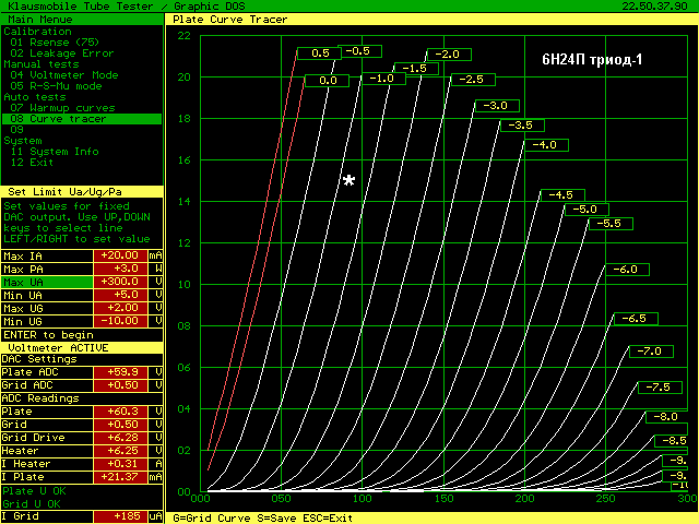

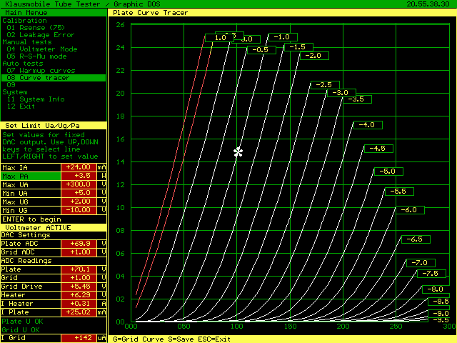

OK , if you say so ... then I don't think a curve tracer can "see" the true variable mu ... it is not static , you have to use 2 signals AC and DC .
Anyway it would have been nice to show both 6n23p / 6n24p characteristics with the same tracer , not to claim that are similar
All the info and data was already posted but since some people can't follow a link, here are traces of 6N23P and 6N24P. Note the scale is slightly different.

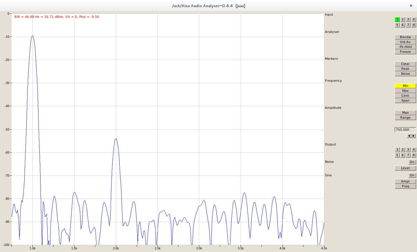

Hopefully the image attached. I got up early and DC coupled a source follower. The best operating point I found at 60Vpp was at 10mA -4volts bias. At this point the 3rd harmonics dropped into the noise floor, but only at this point. Otherwise they were typically -15 dB below the 2nd. I tested all the way into to cutoff with current as low as 5mA. Mu was consistent throughout.
This is the only one I have measured recently. I measured a triode strapped 6p15p a few years ago for a spud headphone amp. I ran into the screenshots of the measurements this morning, and the operating point I used measured (from memory) about -45 dB as well. But the operating point was selected for high current to overcome parasitic capacitance in the toroidal transformer I used for the output. Distortion was a secondary concern. 3rd harmonics where very much lower in the case of the 6p15p (again from memory). In Morgan Jones's 4th edition, there are some measurements for a number of tubes in the 6sn7 family. I took a gander this morning, and (from memory) the 2nd harmonics for the baseline 6sn7 at around 60Vpp (I think that was the level he measured at, don't quote me on that) were at -50dB. Not much difference there, however the 3rds with the 6sn7 and kin were 80 dB down.
With such a narrow window for keeping the high level of 3rds down on the 6n24p, I don't think it would make a good driver swinging 100 volts or more. As a cathode follower, or low level gain stage, I imagine it would perform just fine.
