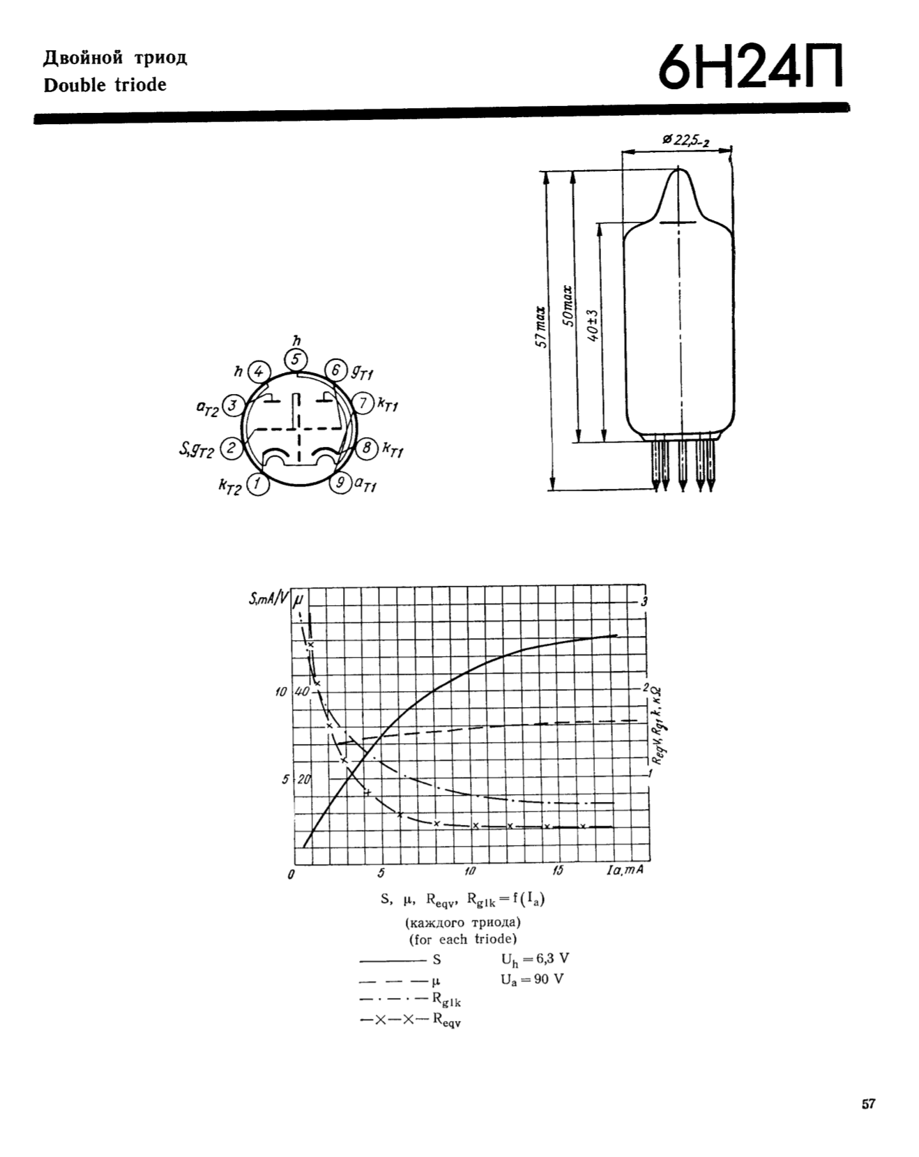

Does anyone have any experience with these tubes? I just bought a handful for a decent price and had some time to play around with one doing some distortion measurements before I needed to recharge batteries. The measurements came out with 2nd harmonics roughly -45 db under fundamental and 3rd another 5 db behind that. That was pretty consistent through the small amount of points I tried. One thing that struck me was that the operating points don't line up with any of the current data available online especially at higher voltages. I originally planned to use this tube as a driver for a 6a3, but I am going to move on to other options and save them for shunt cascode experiments given their decent gm. Just curious if anyone has any experience.

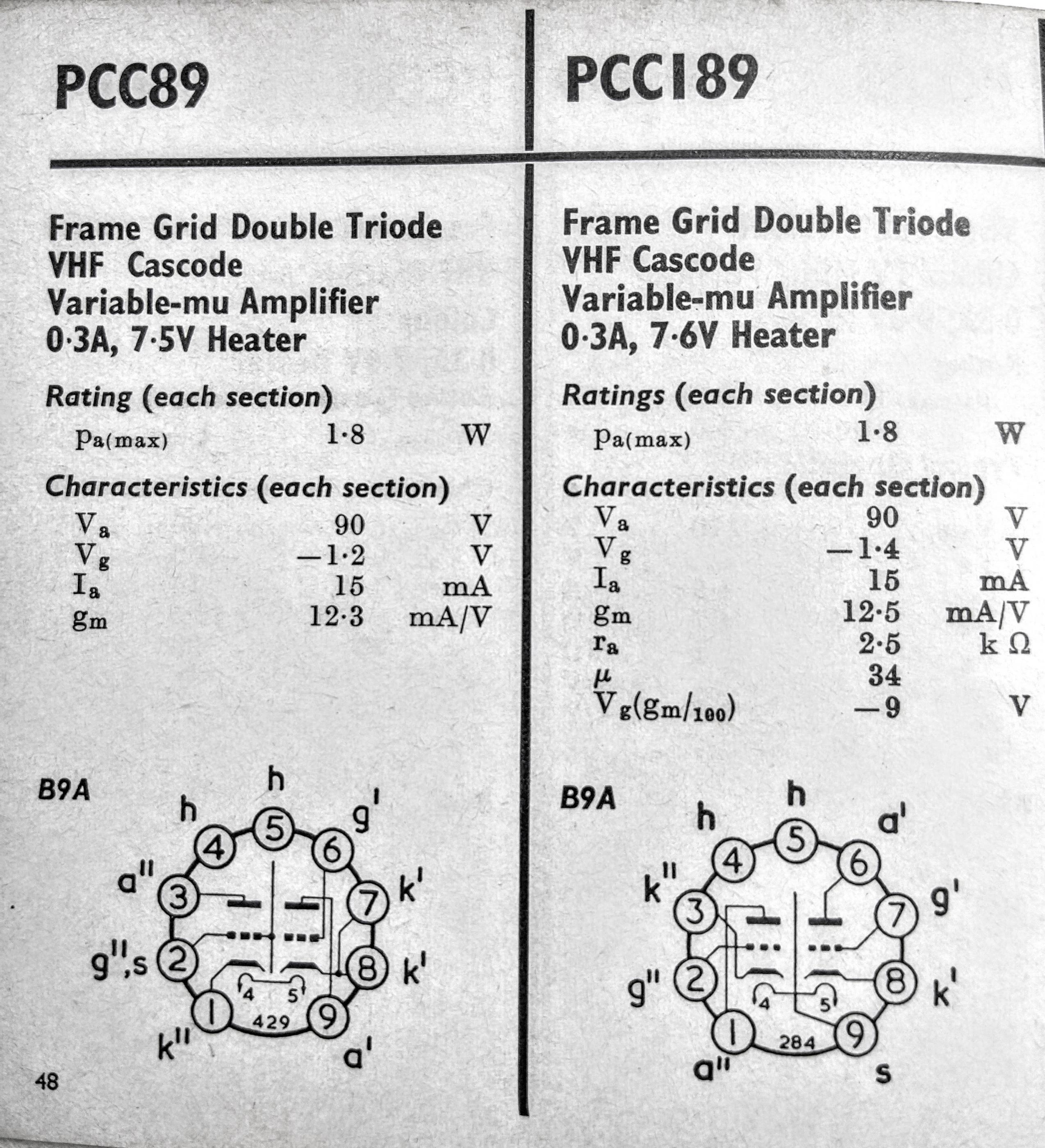

> I can't find any data saying ECC89 is variable mu
the PCC89 is the series-string version of the ECC89
Attached pic is from the Mazda (AEI) 1970 short-form data book, with the frame grid 189 for company.
Full data:
https://frank.pocnet.net/sheets/129/p/PCC89.pdf

The curves I was looking for were from Tube Tester Files - 6N24P - 6H24P
Unfortunately, my results didn't match. For example at -5 volts 10ma my plate voltage was 175. . I don't have anything written down, but I did just get home and have a small bit of time before my weekend starts. I will try to get some concrete data to share.

Ok, did a quick and dirty... All points measured at 10ma.
-1 volt grid 60 volts plate
-2 volts grid 94 volts plate
-3 volts grid 125 volts plate
-4 volts grid 150 volts plate
-5 volts grid 177 volts plate
-6 volts grid 200 volts plate and over dissapation
