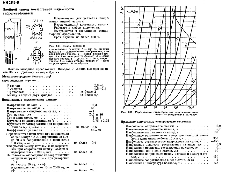

Good point. The pin-outs of the 6GM8 and the 6N16B are quite different, and the data sheet of the 6N16B is rather cryptic. What B+ have others used for the 6N16B? Certainly looks to be quite a linear tube...
This is one option.
Resistive loaded with B+ of 200V.
Vak = 100v
Ia = 5mA
Vgk = 2V-ish
Ra = 20k
Rk = 400R

I use 6n16p with 140v, very linear and very little distorsion.
The 6n28p i use with 48v.
I can't find a record of the 6n28p - can you link a datasheet?
48v would obviously be an easier supply to arrange for this board....

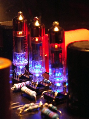

If you are building with a PCB/Veroboard,--why not use an 8 pin DIL socket and another on the board, in addition to a normal valve socket....
Solder the 6H16B into the first 8-pin DIL then simply plug into the other fitted on the board.
--If valve to first socket is wired correctly--It doesn't matter which way the valve is plugged into the board....
Its what I did......
Yes--Like that, but closer to the sockets--and no LED's! I used rolled-pin sockets as the round section leads from the valve bulb are easier to work with the central and even spacing of that type socket.
A little high temp epoxy over the socket to the glass is optional, but Ive found that with as short a wire to socket and soldered into the socket pin holes, they are pretty strong. anyway...
I'm using one in my modded Yaqin EL84 amp as phase-splitter in replacement for its transistor splitter stages. Nice little valve the 6H16B....
Consensus seems to be B+ of ~150-200v for the 6n16b, probably too high for Broskie's board. The 6n28p would be perfect but it doesn't seem to be available anywhere, even on fleabay....
If you're getting a set of new tube, why not get the tubes the board is meant for? ECC99 should not be too expensive and works with 48V, 100V is even better.
6N16P can work with B+ of 100V. Eyeing on the curve, you should be able to get 2mA of current with Vgk of -1V at Vak of 50V.
