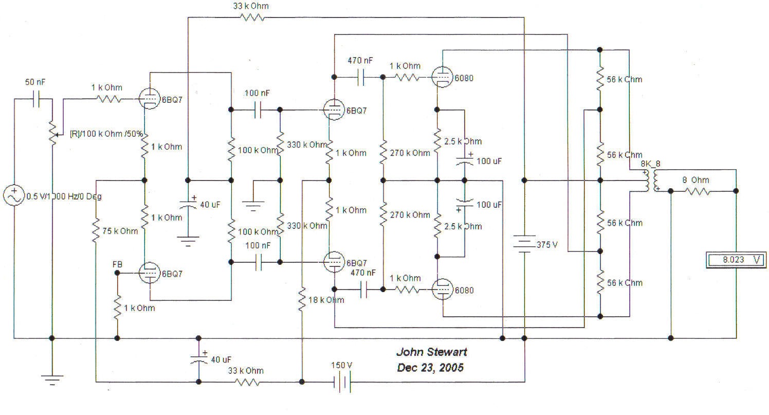

6N13S/6AS7G PP Amplifier schematic
A while back I installed cathode resisters that are heat sinked to the Aluminum chassis,
I've more recently installed two pieces of extruded aluminum to better dissipate the heat.
And here are some recent IMD measurements taken at a lower B+.
All the conditions are listed on the scope screens,
Like all my amps over the last 25 yrs, this amp is strictly experimental for me, not to listen too or a thing of beauty.

HV is regulated 380Vdc. Pout before clipping is about 11.5Wrms with approx. 0.8% THD+N. Bandwidth 20Hz - 20kHz +/-0.2dB at 1Wrms. For the measurements I have used QUANTASYLUM QA402.
If there is something to complain about, it is that H3 is quite close to H2 percentage. In the meantime I have built another amp based on the same schematic, with very similar results.
