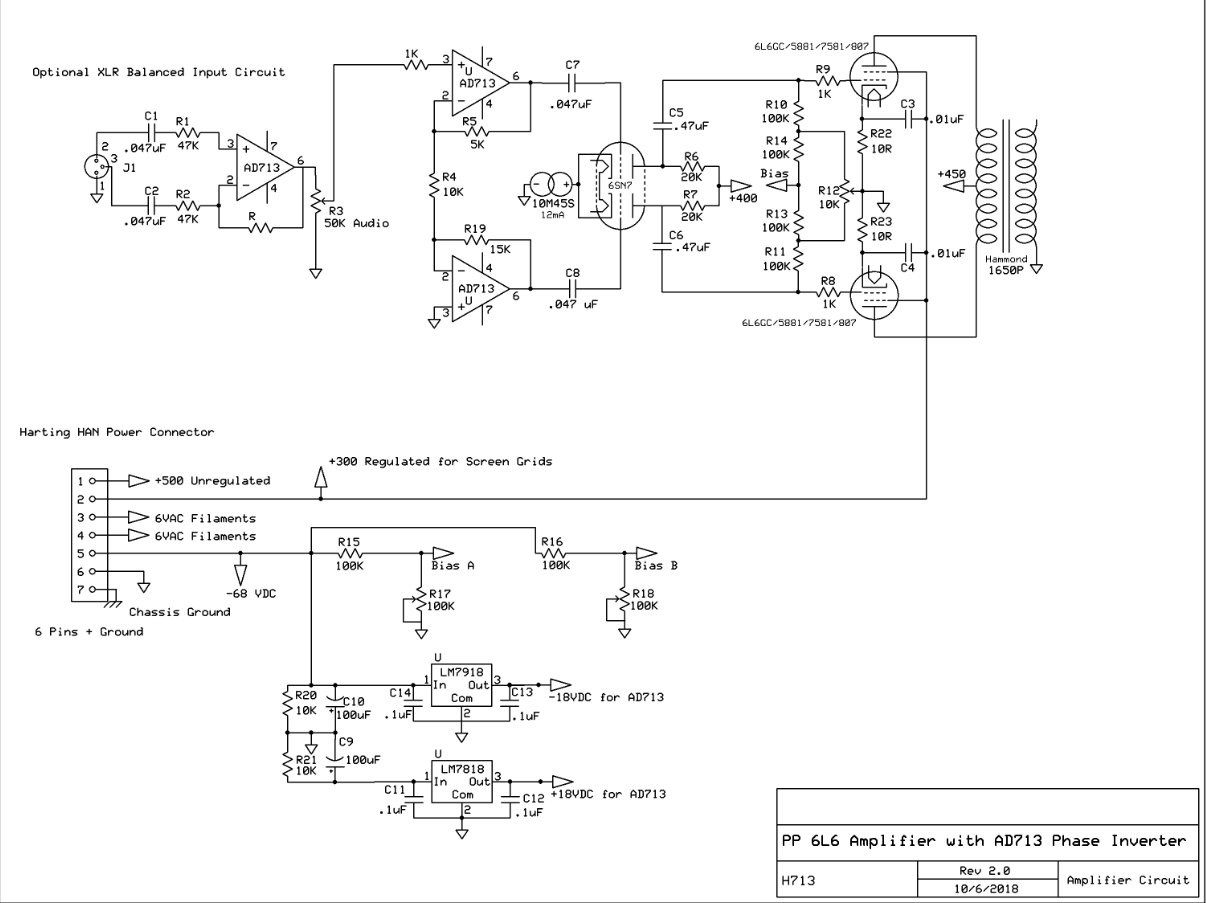

6L6GC PP amplifier with SS phase inverter
The distortion from the voltage amplifier (being an op-amp, and a good one at that) is lower than the rest of the amp. I have not measured the distortion coming from the phase splitter itself. Spice simulations suggest it's pretty low- about .05%, but I'm not sure how much I should trust this. The J112 is not really designed for linear operation like this- it's a common input switch (hence why I have it in stock).
I may try the differential feedback from the OPT secondary to the driver tube cathodes- could work quite well. I would assume that the feedback resistor would then become the ground reference for the OPT secondary.
I definitely am not a huge fan of how many coupling capacitors I'm wrapping feedback around. I spent considerable time trying to figure out a way to DC couple this, but didn't have a lot of success. I've never seen this sort of JFET concertina phase splitter employed in an amp before, so it would be quite interesting to see how it would perform without feedback around it. I will say that the few JFET-based designs I've heard sound quite good.
As I mentioned earlier, the distortion numbers look promising. 0.2% is pretty good, and if I can get around this LF instability then I should be able to apply significantly more negative feedback, since I haven't run into HF instability issues yet and I suspect I could get away with about 15 dB of feedback with the Hammonds. If anyone has past experiences with how much feedback they could get away with using these transformers, I'd be very interested to know. I've seen some projects where people have worked in 15 or 16dB of negative feedback around a Hammond 1650HA, though I'm not sure how well this will translate to the larger 1650P.

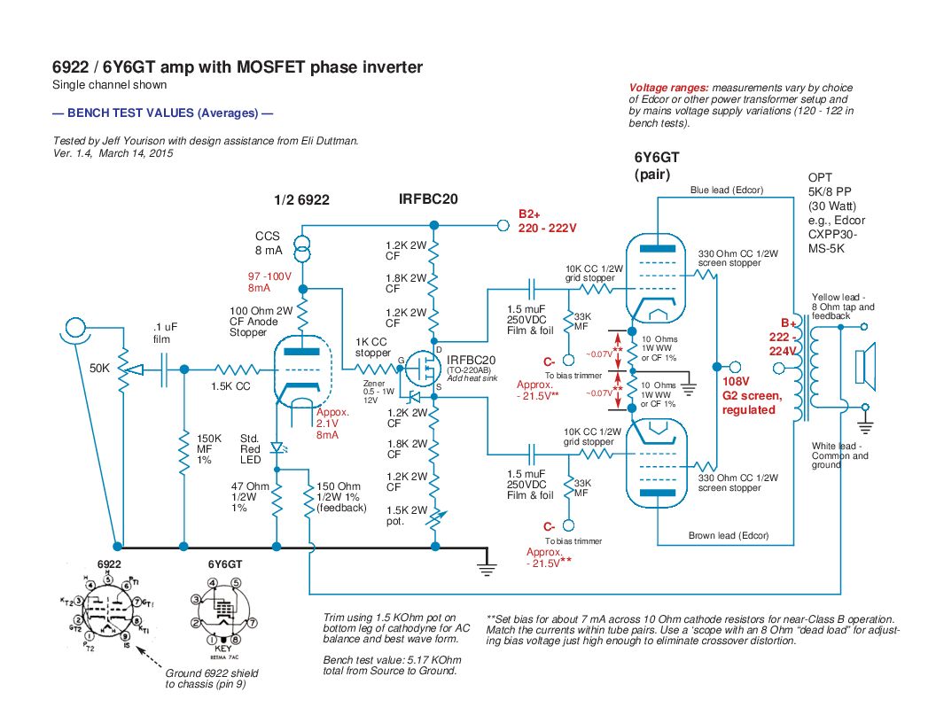

My amp has a mosfet concertina phase splitter directly coupled from the preceding triode voltage amplifier, and driving the output tubes in pentode mode, so only one pair of coupling capacitors in the loop. Because it is essentially operating as a source follower, distortion is very low due to local feedback. The JFET should be similar.
I have used the differential feedback before, it worked fine (yes the ground reference is through the feedback resistors). Only hassle is that you need a two channel scope with differential mode to measure the output properly, otherwise you can only look at half the signal. Can make setting HF compensation capacitor problematic with only a single channel scope.
Time for an update.
I think I took care of the LF stability issue. I tried the differential feedback, but I was not happy with it. Distortion seemed to go up. I'm not completely sure why this is, but my guess is that it's got to do with the rather odd secondary configuration of the Hammond output transformer.
The thing that kept bugging me is that I should be able to make this work with the three coupling capacitors. I tried replacing C1 with a 22 nF capacitor (I calculated a rolloff at around 22Hz for this), but low and behold, oscillation still there. Took a break, walked the dog, etc. I redid the math I should have done prior to building it, and realized that with .22uF capacitors between the driver stage and the output stage, my cutoff was at around 7.5 Hz. I had a couple of 68 nF 715P caps on hand that I replaced them with- this yields a cutoff around 23 Hz. This seemed to kill the LF oscillation, and the feedback should ultimately widen my response curve significantly so the amp will be flat down to 20Hz.
I've got about 16dB of feedback applied. Open loop gain is around 80, closed it's around 13. This may be too much feedback.
Amp is rock-solid into a resistive load. Good. Let's put it on the AP and look at its noise and dist- oh. Just connecting the amp to the AP box through a not-so-short cable was enough to cause parasitic oscillation when driven. I tried putting a .22 uF capacitor in parallel with the dummy load, and even with no input signal applied we have about 5-10 watts of RF power. Not exactly the best thing on Earth for a tweeter. More work to follow. I have a feeling I might have to drop my feedback down a few dB. Haven't gotten an accurate noise floor measurement yet, but it looked mostly like white noise on the scope- nothing that suggests grounding issues.
Now to figure out how to kill the HF oscillation- I wasn't trying to build a transmitter here. Any capacitance in parallel with the feedback resistor seems to make the problem worse. I'm thinking about a zobel network right after C1 could help.

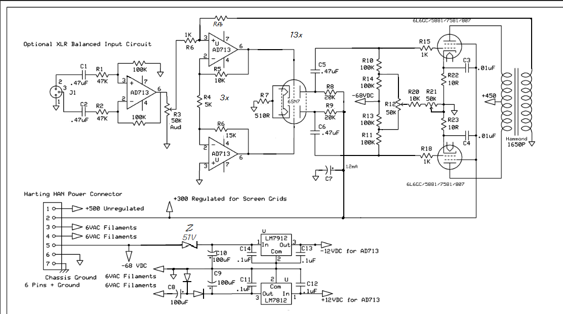

Alright, I have two brand-new driver board ideas that could solve the problem.
The solution that doesn't involve cheating is what you see in the attached schematic. One op-amp handles the input (and GNFB connection), while the other two are configured as a traditional balanced line driver. The op-amps can be whatever you choose. A TL074 is shown in the schematic, but the AD713, NE5532, OPA604, or whatever will work fine. I ran the simulations with an AD713 because the model is bundled with LTspice. I haven't tried any original API 2520s, but I suppose those would work as well if you're willing to spend about $1200 on the driver board...
If you want to cheat, the second two op-amps could probably be replaced by a THAT1646 to split the phase.

(Theoretically) done. I neglected to take pictures of the underside before I closed it up, but it's not that different from the last pics aside from some nicer lead dress.
There's about 17 dB of negative feedback, and the amp has about 25dB of gain- probably a bit more than necessary, but given that noise isn't an issue, I'm not going to touch it. I was surprised by the fact that the feedback resistor didn't need a capacitor in parallel with it- I couldn't find any value between 22 and 900 pF that didn't make the amp less stable. It is rock solid into a resistive dummy load. When I put a 100 nF capacitor in parallel with the dummy load, it remains stable. It does not like having a 220 nF cap in parallel with it, however, the 3.3uF is just fine.
All that said, I could not get it to oscillate into a speaker. I tried three different test speakers, and while I never went to full power with them (even wit earmuffs it's too loud), I got pretty close and the output was clean. Any other stability tests you guys like to do?
So what does it sound like? IMO, it sounds pretty good. It's a tiny bit on the bright side, but even with my rather bright Elac 510s, it's not bad. It sounds very accurate and clean. I still need to make a 1/8" purpleheart plate to cover the screws on the left side of the front, and I still need to decide what knobs I want to use.
And the noise? Depends. The AP tells me that one channel is -75 and the other is -65dB, but I can't see a difference on the scope. With 87dB efficiency speakers, I can hear a tiny bit of noise if I hold my ear up to the tweeter, but it's more than quiet enough for me. Distortion is about .35% at 2kHz, and drops to .15% at 20kHz. At 30Hz, it's around .35% as well. Not half bad. The schematic above is not correct- the feedback resistor is an 82.5k, and there's a mistake in the phase splitter design. Attached is the correct drawing in LT Spice.

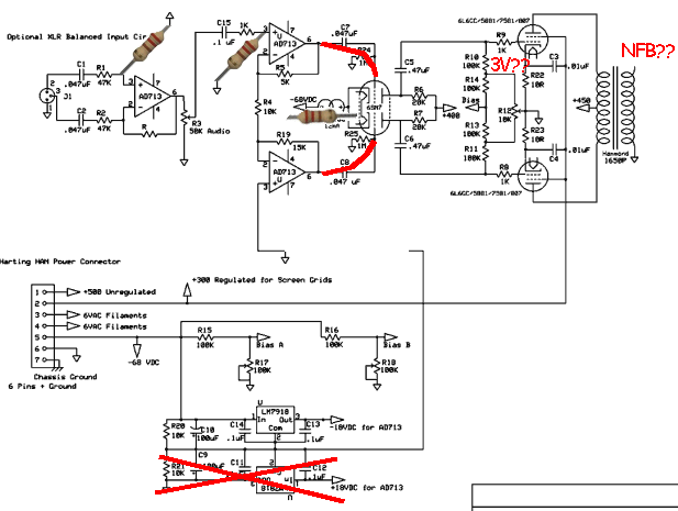

H713,
Your experience mirrors mine with Hammond output iron. When secondary is configured for 4 and 8 ohm outputs, I have never been able to pull feedback from the 8 ohm tap for more than about 10 dB feedback or else amp goes unstable easily. I have had much better luck pulling feedback from 4 ohm tap and in that case I can apply up to 18 dB with no problems, but still there was some significant HF phase shifting up above 15 KHz that required fairly aggressive HF step filtering to keep the amp stable.
Did you try a Zobel and what was the result? Where was the 5 pF cap connected? I'd like to see the overshoot a bit smaller on those square wave tests.
Attached is an updated schematic of both the power supply and the audio stage. 5 pF cap is in parallel with the feedback resistor.
I did briefly try a Zobel on the output consisting of a .1uF cap in series with a 150 ohm resistor- didn't calculate this, just as a test. I didn't notice much difference. I may revisit this later.
I agree that the overshoot isn't awesome. I'd like to get it better. I'm all ears if anyone has suggestions.
IMO, the Hammond iron is pretty good. When I built my last amp, I found that the Edcors didn't allow for nearly as much feedback. That said, I made a real mess of the grounding and wire dress (first big point-to-point layout), so that may have been the real problem.

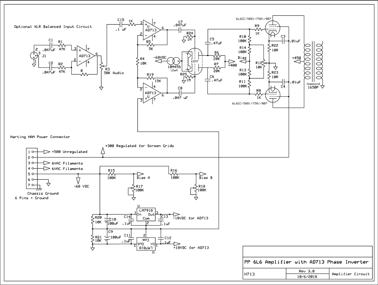

Grid stoppers might help with the 12SN7, I could try it. There is, however, a 3K grid stopper on each of the power tubes.
One thing that isn't visible in the schematic (my mistake) is a 50K linear volume pot. Somewhere I have some 10K linear Allen-Bradley pots I'm going to put in there eventually, I just need to find them. Really, since they're individual channel controls, they're more useful as a mute switch than anything.
This amp is remarkably quiet with an open input- quite nice. It is not a high input impedance, but I'm working on a transformer balanced buffer preamp to drive it (matching color scheme and everything).
I know the noise figures I stated aren't truly amazing, but you pretty much have to have your ear up against the speaker drivers to hear it at all. I suspect both channels are realistically about -75dB, perhaps better. I might try to quiet it down even more if I was going to use it with some 105dB sensitivity Klipsch horns, but if I had a set of those I'd be building a SE amp.
OK, still it is advisable to add a RC low pass filter just to avoid problems. You can expect issues (for certain with high bandwidth devices) if you don’t limit.
Of course I noticed grid stoppers on the power tubes but that does not compensate the lack of grid stoppers on the 12SN7.
