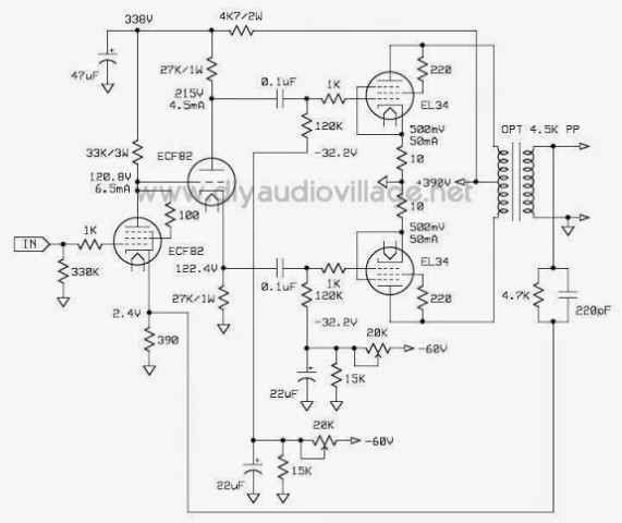

Ok, maybe another dumb question but here goes.
What would lowering the resistor to say 100r do? I noticed upping it made the amp sound duller. I measured the 200r that were in there and they measured anywhere between 191 and 212 so I do want new ones in that closely match
