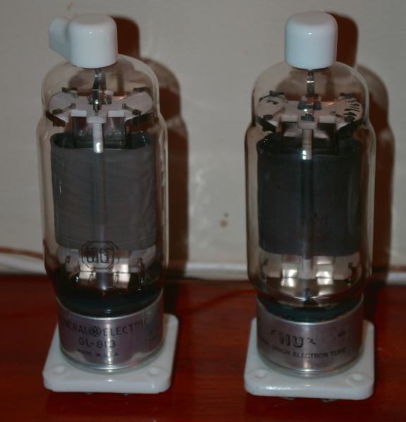

On the other hand, I also thought of these 814s as an output stage.
Do you think they would make a good guitar amp?
The 813 pair would be my final choice,
but that would require an entirely different power transformer,
filaments, and even topology.

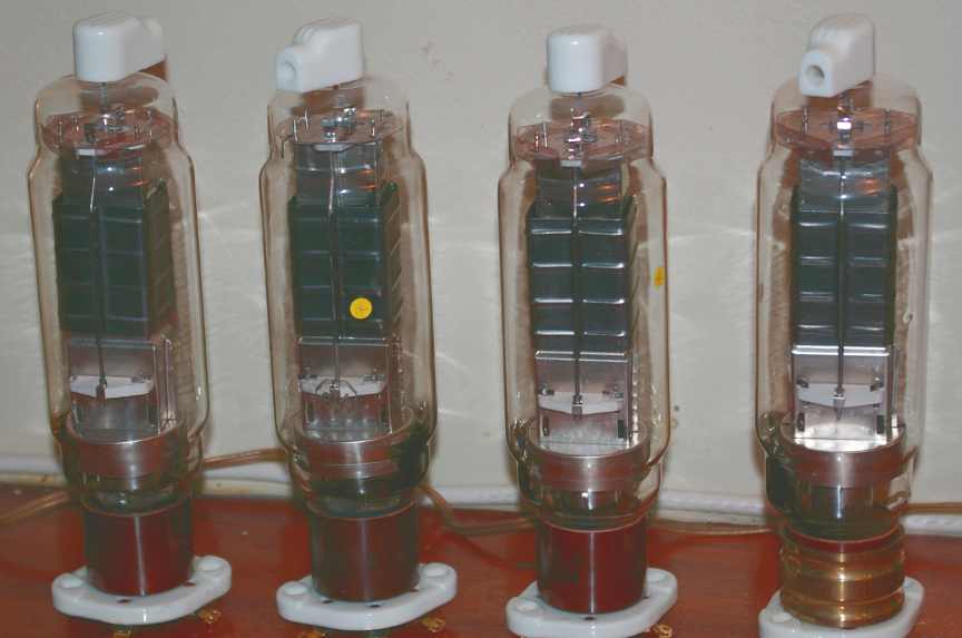

There have been a few links to this mentioned in this forum (why use just two 813's):
Champ 1000 Watt Tube Amp
One of them is from this thread which outlines a few big amps. Some are guitar amps:
http://www.diyaudio.com/forums/tube...r-tube-amps.html?highlight=champ+1000W+guitar
I don't have any 814's. I do have some 813's and 828's but I now think that the high voltages and impedances needed don't make for easy designs. I also have a bunch of 833A's and even made a little practice amp with one just to see how it sounds. None of this is really practical and all of the tubes and associated transformers will get sold.
The 200 watt practice amp:
The 833A SE Amp Prototype
Wow I love this: It looks like the bench could kill a rhinoceros!

This is the kind of mad experiment that all tubaholics must live vicariously through,Observations so far:
The 10 amp filament puts out a serious AC magnetic field that gets into everything. Hum is evident in the speakers and on the analyzer BEFORE you turn on the power supply. As soon as you plug in the filament transformer the hum appears. Moving the transformers or the tube around has no effect. The hum balance pot has no effect on this hum. DC filaments WILL be required.
The low frequency response is outrageous. Roll off starts around 25 Hz and 3 db is 11 Hz.

Yes, I saw this monster amp already.why use just two 813's
But it looks like I'd have to roll my own 80 lb transformers,
or else have industrial power trannys brought in by forklift.
I have already committed to using a light and inexpensive
switching power supply for the 10 volt 10 amp heaters with
just two tubes....
But the High Voltage problem I was going to solve multiple ways,
starting with using lower voltages than the max possible...
and running class A.
I'm going to use both types of power-tube clip on these amps,
because they are hanging upside down.
