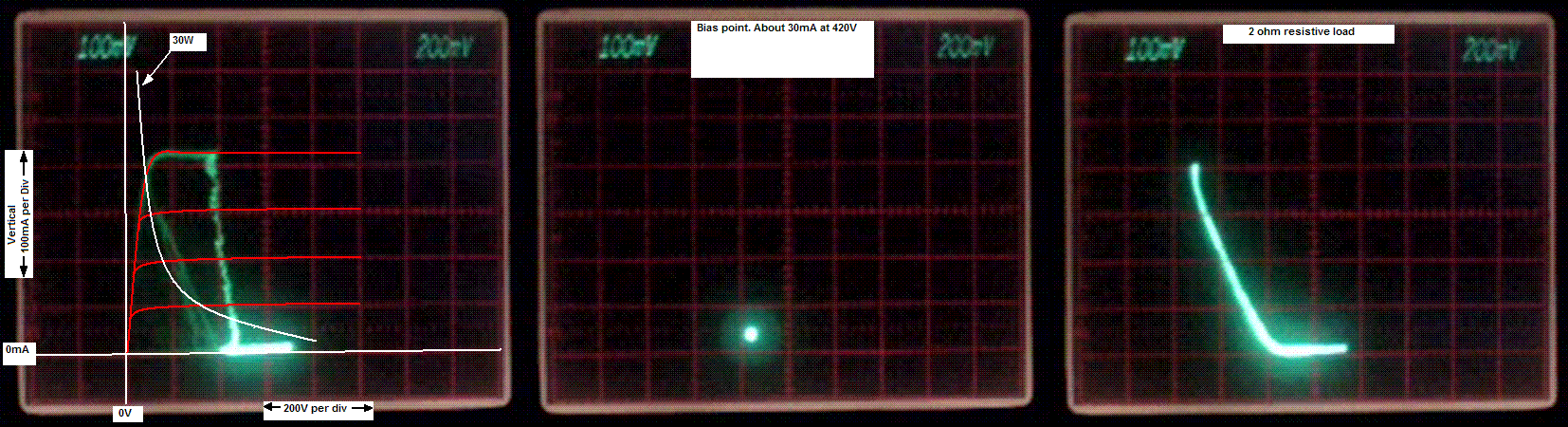

In the diagram above, we have the usual 6L6 curve family, where we are supposed to draw a load line.
Trouble is, the output stage doesn't have a resistive load, so the normal facts don't apply.
With an ordinary resistor load, the tube acts like a variable voltage divider,
and naturally, we can draw a load line by taking the extreme points:
(1) Tube off - complete current shut down (resistance = infinity): now the full power-supply voltage appears across the tube (sort of). Since there is no current, there is no voltage drop across the plate resistor, and the full B+ is at the plate (to ground). This is where the tube goes into "Class AB/B" and turns off for part of a cycle with a big signal swing. The danger at this point is arcing inside the tube, or surface traces/flashes across the pins/socket, if the voltage is too high. or the sockets are dirty or the air is too humid.
(2) Tube full on - minimal resistance, maximum current (resistance = remaining load): now there is no significant voltage across the tube, and most of the voltage appears across the resistor load. For a tube with a plate-load, the plate reads zero volts relative to ground, and the voltage drop across the resistor is the full voltage (minus any voltage drop across a cathode resistor in series with both the tube and load). The danger here is overloading thin wires (usually the grids) with too much current, red heat, meltdown, and tube death. Another potential danger is tube wear: cathode-stripping from over-current and over-heating. Nonetheless even when fully conducting, there isn't really a full short-circuit, since the resistive load (and any cathode resistor) is still in series with the B+
These two extremes serve to provide end-points for a load line, drawn as above (from highest voltage across tube /no current over to lowest voltage / max current). The tube voltage and current is assumed to follow Ohm's Law (a straight line on the chart between the points).
Normally, we would pick an appropriate HV (B+) which fixes one end of the load line,
and then pick an appropriate load impedance (Z-primary) that nails the other end down.
However, we already have a power transformer (fixing choices of B+),
and an output transformer (fixing maximum current and the angle of the load line).
The only question remaining, is where the tube will 'idle' (i..e, its quiescent current), that is, what resistance will it present, and what current will be flowing through it when there is no other signal on the control grid (g1) other than the DC Bias voltage. This idle point is what WE get to set, by picking an appropriate Bias voltage.
We do it by picking an appropriate mid-point on our line, and a modest idle current, then reading (or estimating) what the BIAS voltage will have to be to hold the tube there.
For Class A (full operation) usually we want a good (equal) swing in both directions that stays in safe range and keeps the heat dissipation below the maximum ratings.
The same basic procedure is used for pentode, Ultralinear or Triode modes.
But with pentodes, we want the load angle to avoid dipping into the 'elbow'
and with triode modes we want to follow more conservative ratings and watch screen current, but its the same idea.
In our amplifier, we can't actually pick our own load line, because we already have the transformer, which is fixed at a supposedly 5k ohm impedance.
We can still pick an 'idle' point however, just as with a car we can't change the horsepower or torque, but we can adjust the 'idle RPM' to save gas but keep from stalling.

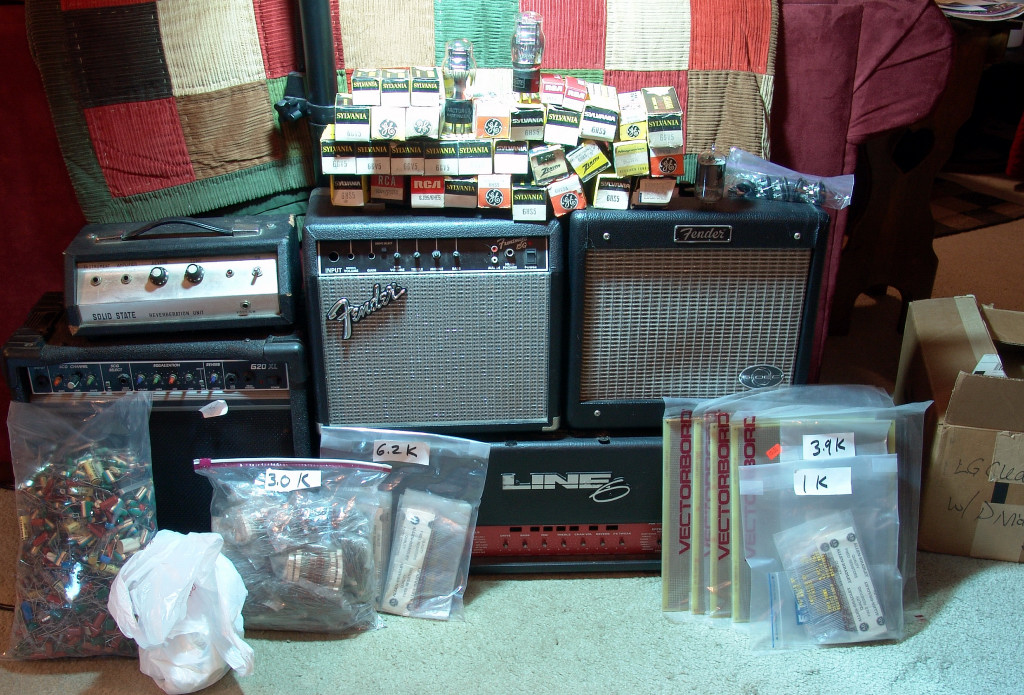

My philosophy for this project was/is:
(1) Use what I have on hand, as much as possible.
(2) Build the best amp I can performance wise, constrained by very limited budget.
(3) Learn and share the experience-curve so others can benefit.

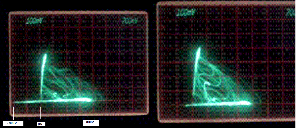

But we still have some problems with the 'load line':
Although we treat the reactive transformer and speaker-load as if it were a resistive load for purposes of drawing the load line,
the premise is basically false, and the real tube behavior will be nowhere near what the load-line suggests:
(1) Suppose we pick an idle-point of 50 mA, which would require a bias of 50 volts, and according to the load-line would leave 300 volts on the plate (dropping a vertical down to the x-axis).
(2) Of course we all should know that the transformer is not a resistor, but only a 'nominal A.C. impedance' of 5k. Its actual (measured) resistance is only 50 ohms per side (on mine anyway).
This means that with 50 mA coursing through it on idle with no AC signal, its only dropping about 2.5 volts, leaving 538.5 volts from ground on the plate! Of course, our self-bias cathode resistor takes up about 67 volts (at 1350 ohms), leaving 471 volts from cathode to plate. Thats safe (while idling) for a 6L6, but not a 5881.
(3) All this suggests that any AC signal at the plate is really riding on a 471 volt D.C. offset voltage (relative to the cathode), and we should really shove our load line over to the right about 171 volts! (or move the scale 171 volts to the left).
(4) A 50v +-, or 100v Peak to peak input voltage, on one tube grid would swing the voltage at the plate about 360 volts, or from 290 to 650 volts + relative to the cathode. Only the 6BG6A will be able to handle that kind of spread.

When drawing load lines for push pull amps you use 1/4 the plate to plate impedance. In this case 1.25K. This is what each tube sees on it's side of the output transformer to B+. Also, plate voltage can reach twice the B+ voltage when the tube on the other side is conducting hard.
To take a step away from the theoretical, I am posting X-Y plots of a 5881 in an actual guitar amp driven by a guitar. Sorry it's not an ultralinear output stage, but I don't expect one to be much different. The amp is a 5F6A re-issue from the 90's with GZ34 rectifier. Current is sampled by a 1 ohm resistor in series with the cathode. Plate voltage is measured by a 1000x probe connected to the scope's horizontal. (Don't try this at home unless you have the proper equipment.) In the first attachment, left most pic, I have sketched the plate curves and the 30W plate dissipation line. Note the screen voltage is such that plate current can reach over 400mA. The second pic shows the bias point. The 3rd pic is the load line with a 2 ohm resistive load. (The 5F6A drives four 10 inch 8 ohm speakers in parallel.) The second attachment shows what happends when playing guitar through the speakers. Note instantaneous plate dissipation can be well over 30 watts, plate voltage easily reaches 800V and can go negative several hundred volts.
This is the kind of stress that a guitar amp puts on it's output tubes.
Yes, I'm aware that a 5881 is only rated at 23 watt plate dissipation. These tubes are marked "5881 MADE IN USSR" re-branded "Ruby 6L6GCRI/5881 Made in Russia".
This is great stuff!
I love the wild and woolly voltage/current excursions in your photos. Looks like a reflection of the reactance/phase effects of the speaker-load, and the lack of a stabilizing high resistance in series with the tube.
The point about the actual impedance seen by one tube on one side is a great note.
Also, the fact that the plate-voltage can swing as high as 2 x B+
is a real warning that shouldn't be ignored.
I was actually being conservative in my concerns about voltage and internal tube-arcing.

I hit the local (and some not so local) hamfests to sell my junk, and shop for rare treasures. I look for dead guitar amps for cabinet reuse. The picture below shows the haul I brought back from the Orlando hamfest in February. I was looking for tubes when I got a phone call about a guy selling a Marshall 4 X 12 cabinet loaded with Celestions for $100. I ran to the location to find a friend buying it. The seller had several dead guitar amps that had been tweaked to death by an "expert". Some were missing parts. I purchased them ALL for $25 total.
I traded away the reverb unit at another hamfest. Got a Stratocaster in that deal. I have often found and sold audio and guitar equipment at hamfests. The interest is low, so are the prices. Rare pieces have high prices and don't sell. There was a Gibson SG at Orlando with a $600 price. That was a good price for that guitar, but people don't go to hamfests to spend $600 on a guitar.
I dragged them home and autopsied them all.
There was a Fender G-DEC (Guitar Digital Entertainment Center). I was curious enough about it to fix it. It is like the guitar equivalent of a Karaoke machine. It is unique enough as a TOY to keep me interested for now. I will sell it when it loses my interest.
The other three have been judged to be certified cabinet donors. The speaker in the Crate might be a keeper. The Fender Frontman speaker didn't like being fed 125 watts of tube amp scream and it has been permanently silenced!

Great haul!I hit the local (and some not so local) hamfests to sell my junk, and shop for rare treasures. I look for dead guitar amps for cabinet reuse. The picture below shows the haul I brought back from the Orlando hamfest in February.
Nice score, even if you didn't get the 4x12.
At least its in the family so to speak.
Sounds just about right.I traded away the reverb unit at another hamfest. Got a Stratocaster in that deal. I have often found and sold audio and guitar equipment at hamfests. The interest is low, so are the prices. Rare pieces have high prices and don't sell. There was a Gibson SG at Orlando with a $600 price. That was a good price for that guitar, but people don't go to hamfests to spend $600 on a guitar.
I find that too. If I go to a non-musical pawn shop,
sometimes they underprice.
"I dragged them home and autopsied them all. "
I love this quote!
You make it sound as fun as it must have been.
The Crate ought to be good.The other three have been judged to be certified cabinet donors. The speaker in the Crate might be a keeper. The Fender Frontman speaker didn't like being fed 125 watts of tube amp scream and it has been permanently silenced!
I'm not surprised the Fender speaker died.
A brand name ain't gonna make up for lack of an adequate wattage rating.
