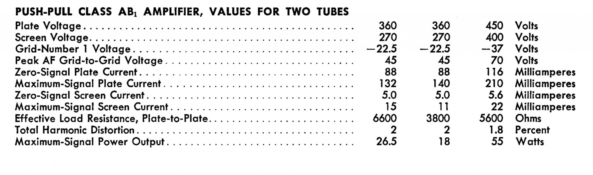

I don't see 100 watts coming out of a pair of 6L6's. 40 to 50 watts I can see from a pair of them.6L6 Power Amplifier - A grandmasters unfinished dream

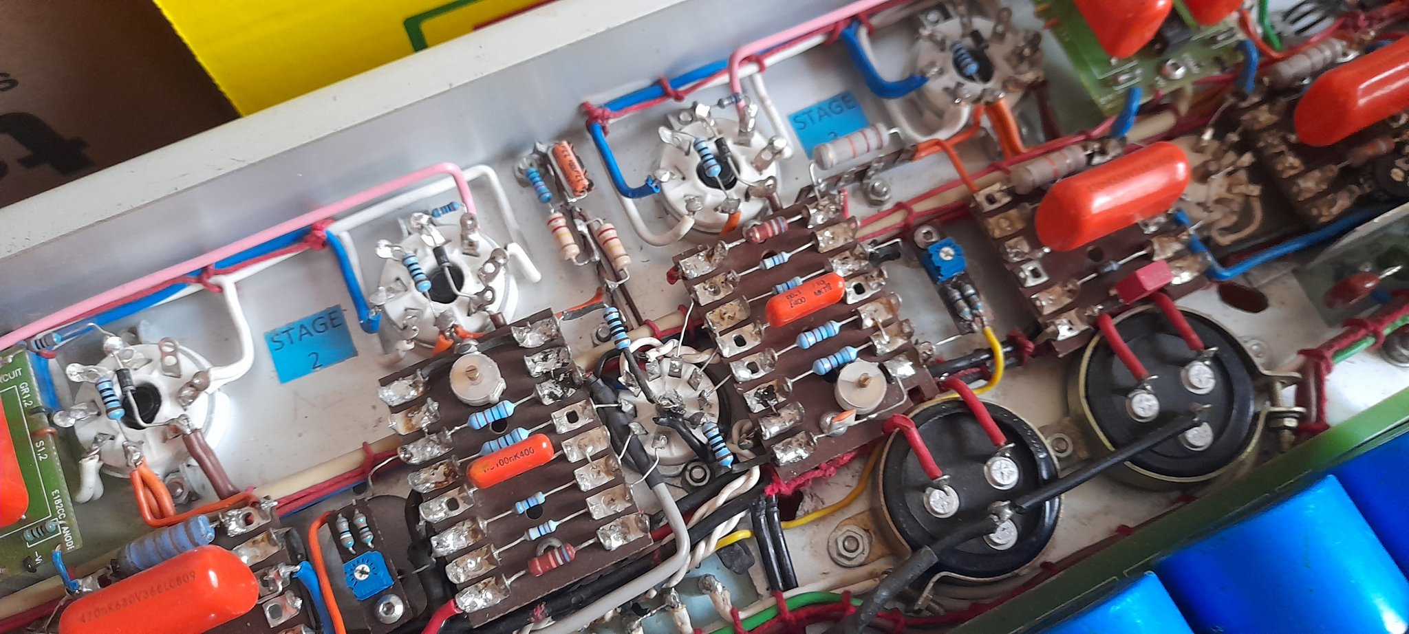

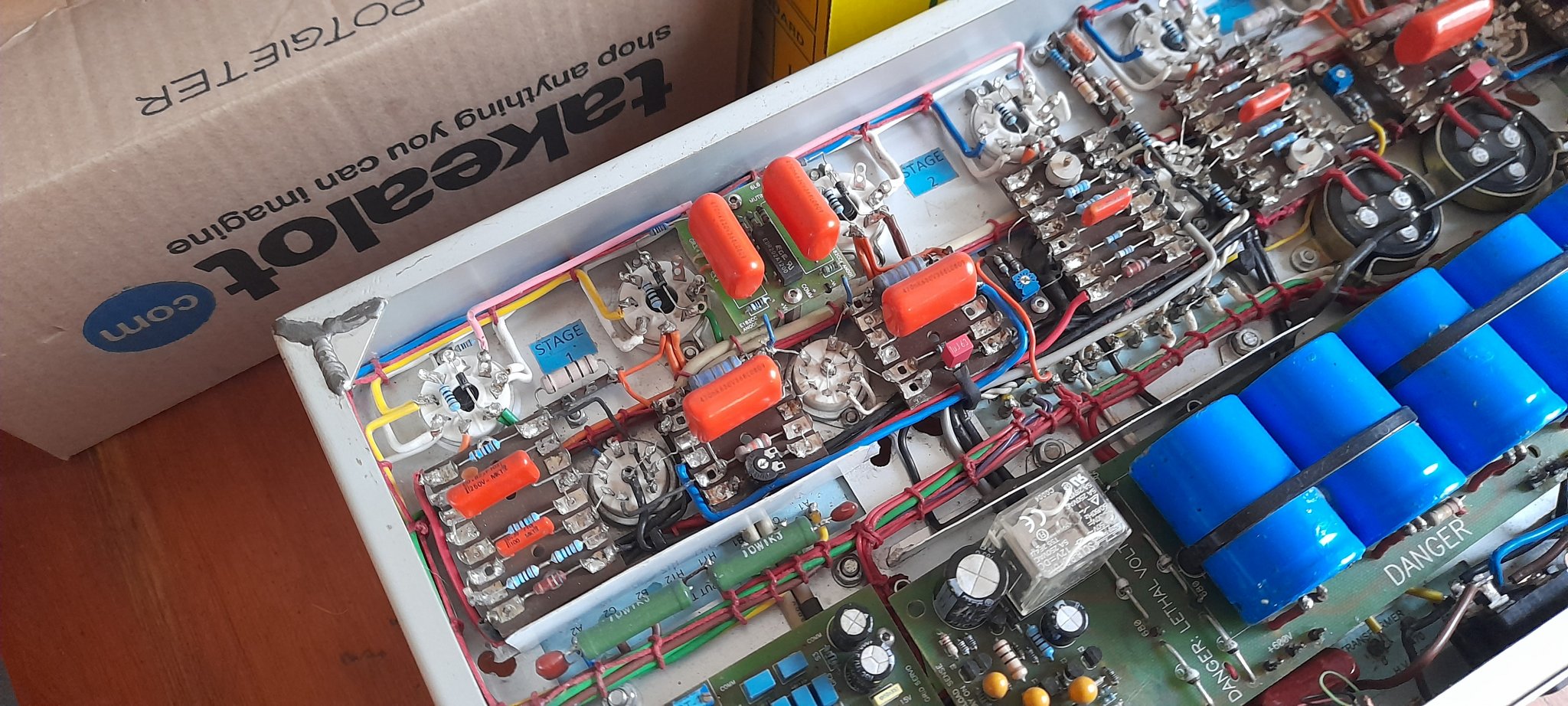

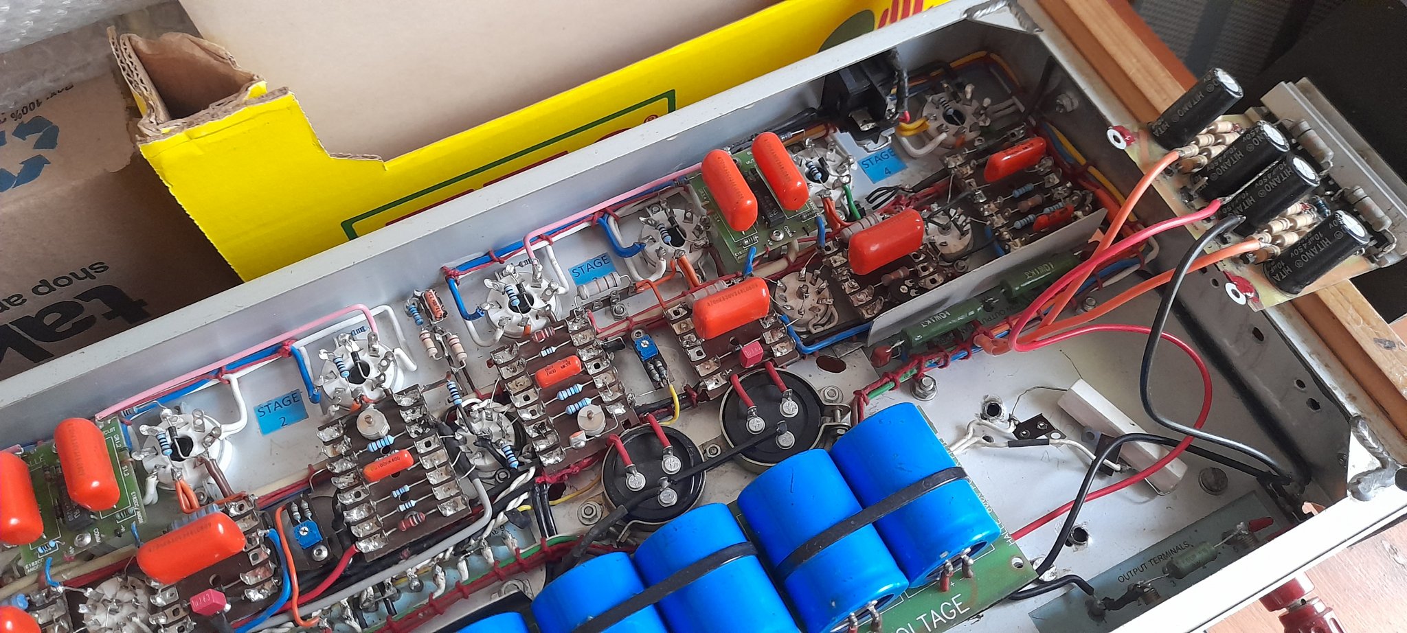

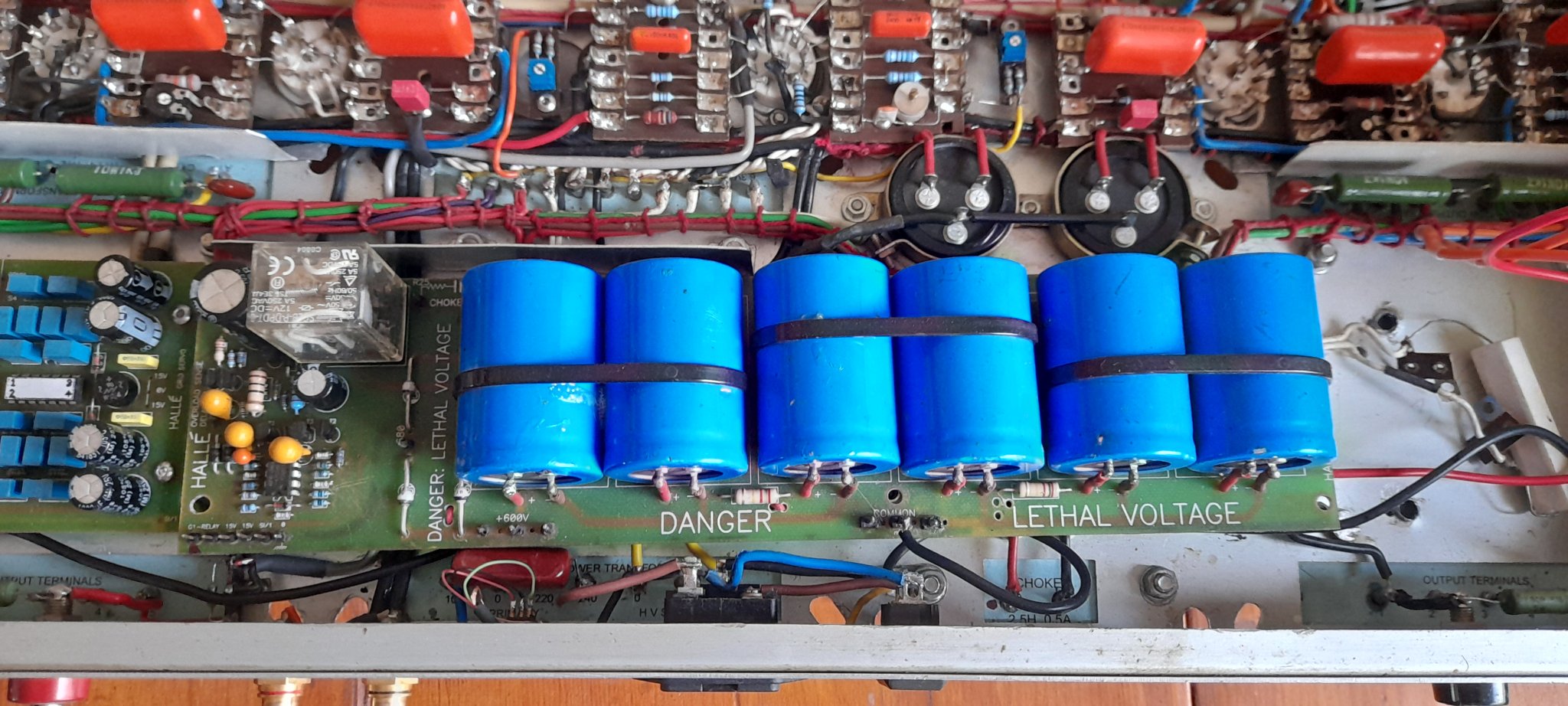

I have been approached by the son of a local electronics engineer who passed away last year. He was still working on his ultimate valve power amplifier system.
All the parts and schematics were collected and I am now trying to make sense of it all. It is a difficult task to take on since the man who designed it is not available anymore for any comments.

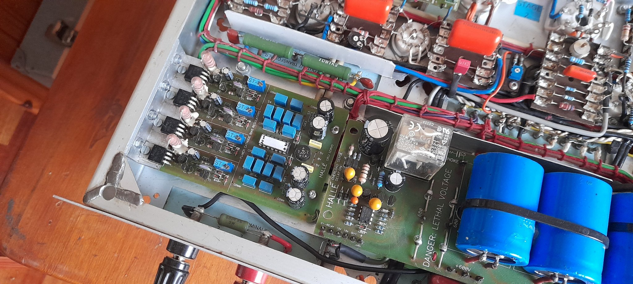

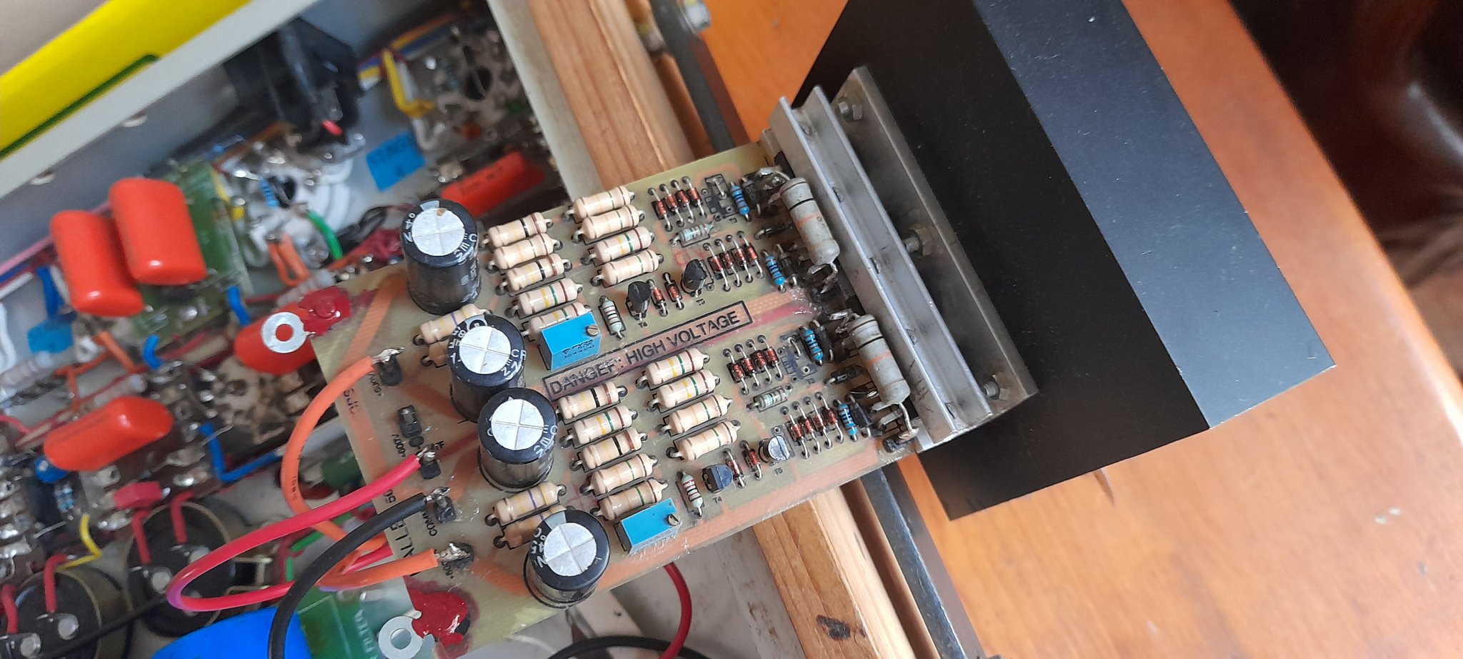

The amplifier is quite elaborate. 100 watt per channel, servo bias control, overload protection as well as grid drift compensation and cathode windings in the output transformer.
In the notes the man stated that he battled with the overload that reset itself after a short while - he wanted it to stay latched when it tripped. Also, there is a spike pulse on the 500 vdc regulator.
If any member here is keen to cast an eye on the schematics, I would be very grateful.

Yes it is terribly high600V on the anodes of 6L6GC seems terribly high . What do you think ?

As @6A3sUMMER mentioned earlier , one needs to know DCR of transformer windings . I would assume each half anode winding is far over 2k with R24/25 bringing it back down to ~1k-1k2 "seen" by anodes of either push or pull side .
What do you think is the purpose of C16 & R24 ?
Are the currents not indicated the wrong way round in this GE 6L6GC datasheet ?

Start with 600V B+, drop 10V in a good output transformer plate to center tap.
590V quiescent at the plate. All is OK for now.
Then, apply a very large musical transient signal, one plate goes down from 590V to 50V (A 540V change).
At the same time, the other plate goes up from 590V (590V + 540V) = 1130V, due to the tube that is at cutoff, and the the plate to plate primary windings are coupled and headed in opposite directions; one down, one up.
Now, the voltage in question is not 590V quiescent on the plate, it is 1130V transient volts on one of those plates.
