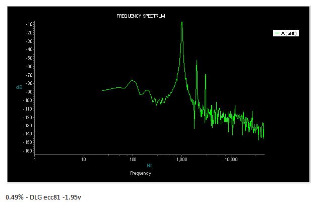

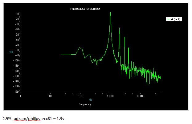

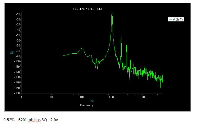

Lets look at the Spectrum Analyzers output. I have five pictures of measurements.

The second is the Philips/Valvo 6201 SQ. This is the "brilliant" tube; Sibilance is horrible! Sound is overly bright. 0.52% thd. Spectrum identical to the General electric.

Fourth is a DLG ecc81. 0.49% thd. Spectrum similar (unexpected) to first 2 tubes. Sounds OK; better than Philips ecc81, worse than GE 6201.
Fifth is an Adzam (Philips) ecc81. Construction similar to standard Philips ecc81. I threw this one in as extra reference. Spectrum similar to standard Philips ecc81. Didn't listen to this one. Although similar spectrum, even more thd; 2.9%.
All these measurement where done at speaker output of amplifier at approx 1 watt output power.
Most relevant to the discussion are the first two pictures. These valves sound very different, but have almost identical spectra.
First and second tubed do NOT have identical spectrum. Second tube has higher upper order harmonics and noise floor. This can be seen by toggling between the two.

I said similar or almost identical. Differences are very small, almost all below -100db.
Your summation was that all were similar, however your statement at the end of the fifth paragraph was that the second tube had "Spectrum identical to the General electric."
I submit that the near 3db difference in 4th harmonic and difference in noise floor may be sufficient impact listening impressions.
I disagree. If this difference was responsible for the perceived sound, then tube 3 should be much worse. Here is a clear difference of much higher 4th and more higher harmonics. However tube 3 sounded just fine, worse than ge 6201, but without the sibilance problems.
But you agree with me that there is sonic difference between similar tubes? Because some people in this thread claimed there was no perceivable difference between similar tubes of different manufacterers. Hell they even claim there is no perceivable difference between totally different constructed powertubes, like el34 vs 6l6.

I have an older dual core windows XP laptop with an EMU 0202 USB soundcard. The EMU has class A inputs/outputs with very low (0.003%) distortion. In loopback mode I measure 0.003% so that seems accurate.
On this laptop I run Visual Analyzer: Visual Analyser
I made a simple attenuator (which i didnt use for these measurements) 1:1 1:10 1:100 1:1000.
VA has a build in signal generator, but for this measurements I used a 24bit/96 Khz wav (1 kHz) I mathematically generated with some software. (dont remember which)
Setup was Squeezebox touch -> Dac/Preamp -> poweramplifier -> speakers.
Measurement was directly connected to speaker outputs, so distortion measured is of all components combined.
