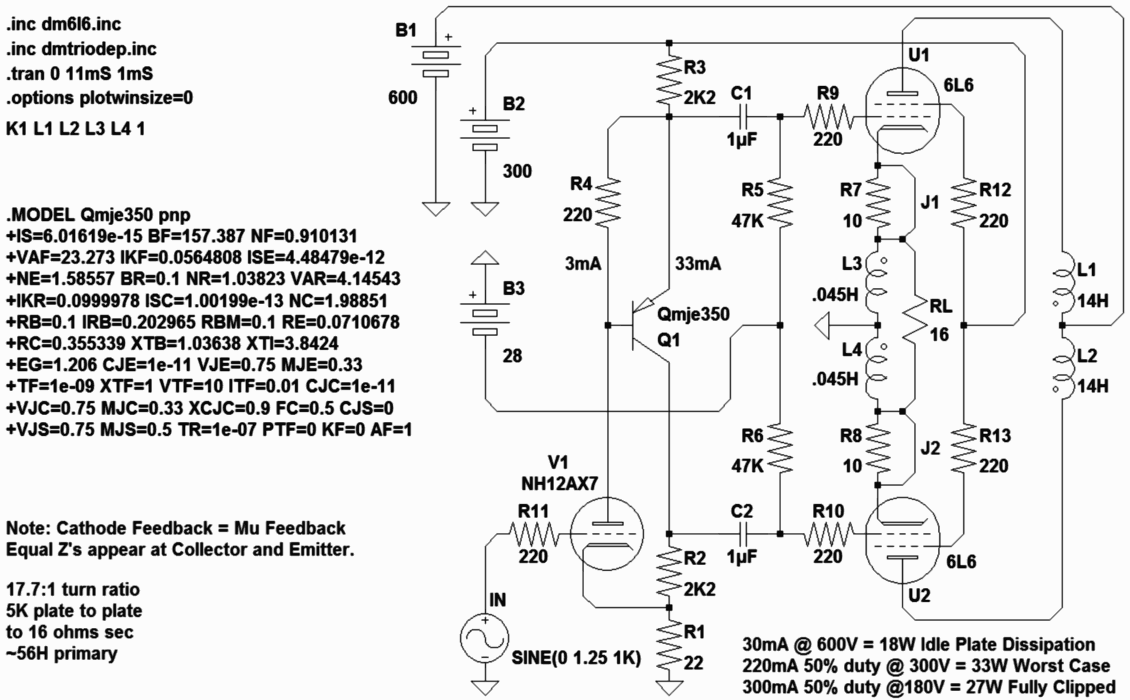

6L6 amp with unique phase splitter - check my math
A little more complicated here than clamping 2*vbias reverse blockage.
The forward conducting cathode voltage is a moving target that climbs
with the output level.
Do we risk a situation where bias runs away in the positive direction?
