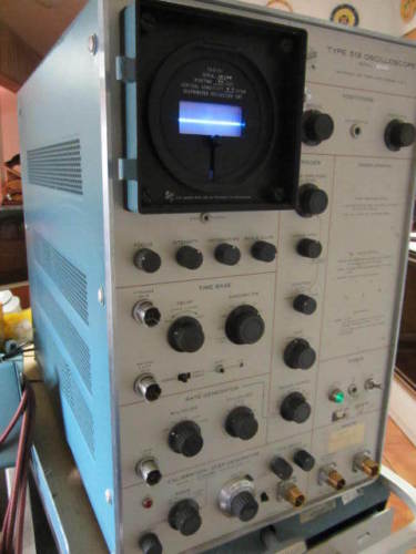

That 1 GHz model would be the Tek 519.
There was a later Tek 519C with 3 GHz bandwidth.
519 - TekWiki

A buddy of mine has a few Tek 519s. The crt is a unique blue shade and super crisp.
