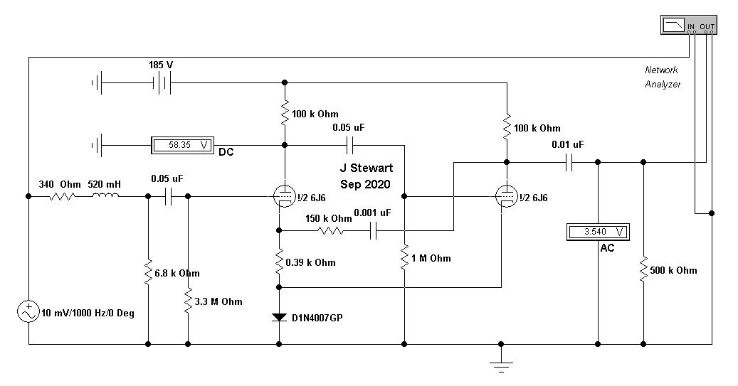

In it's book Valve Amplifiers Morgan Jones describes a LTP phase inverter using a 6J6 and a transistor CCS in it's tail. Hence it is useful also for AF applications, at least for line level ones, I'd say.

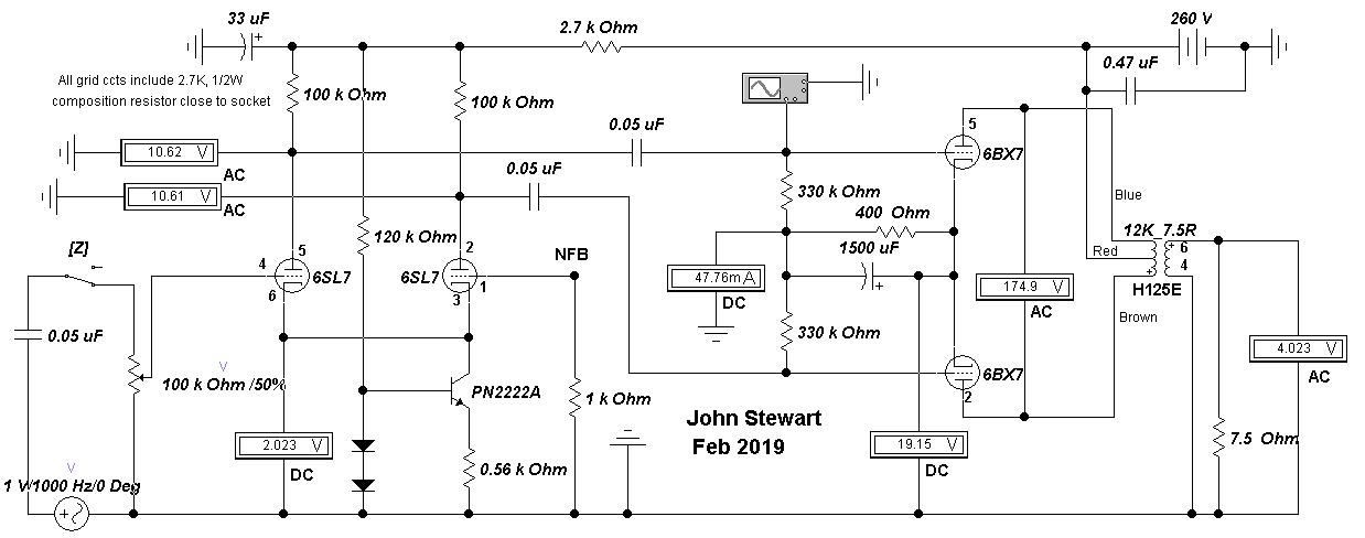

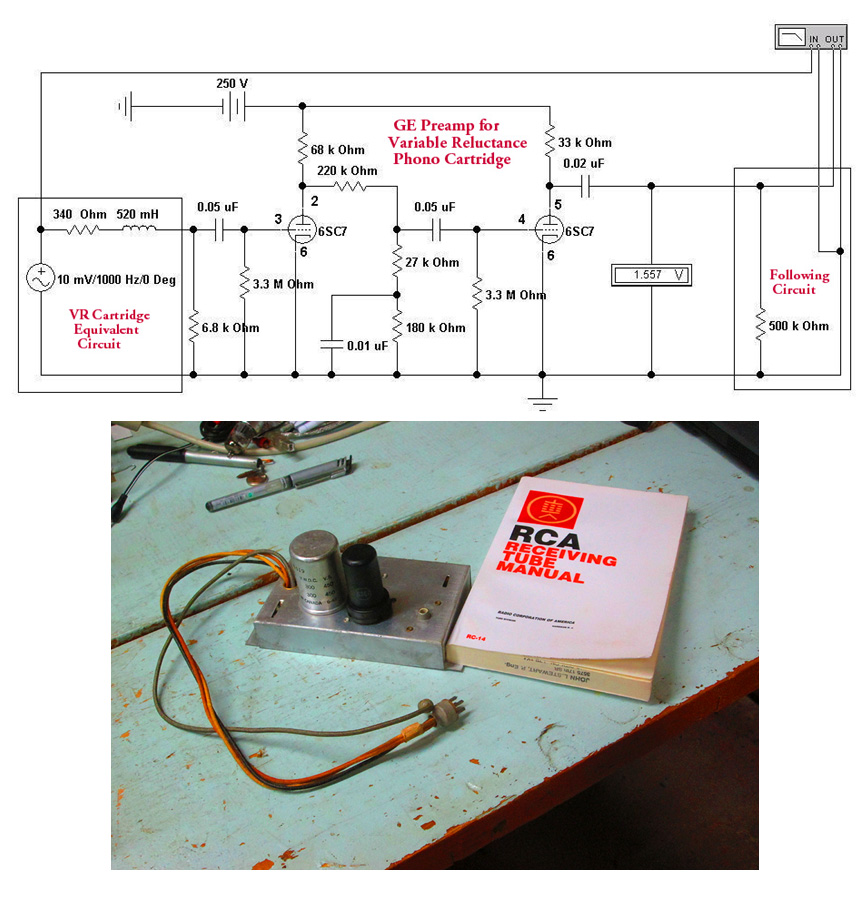

@ jhstewart9: Both your preamp drawings show a MAG. PHONO IN. But where's the RIAA equalization with it's two time constants, at least?

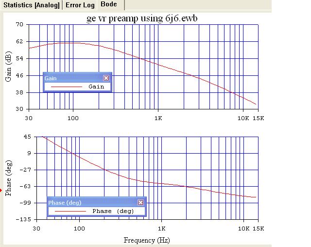

The amplifier front end was used primarily with a GE Variable Reluctance pickup, very popular at that time. Part of the equalization curve is got by running the pickup into 6.8K. The other part of the curve results from the NFB from the 2nd plate to the first cathode, the RC network rolloff is ~1000 Hz. The other example posted here was marketed to users who already had a compatible amplifier. I recently gave this piece away, still working.🙂

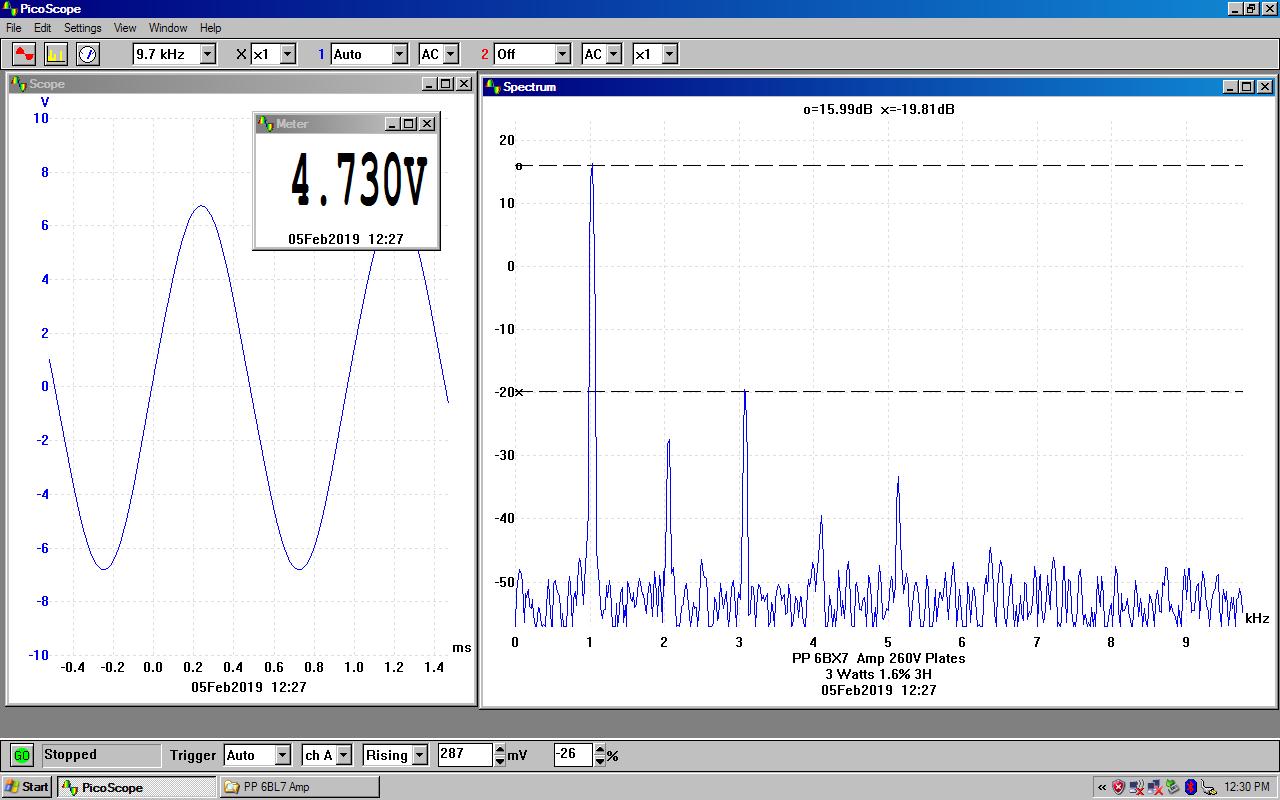

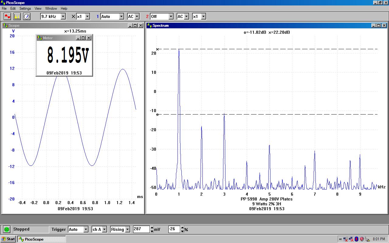

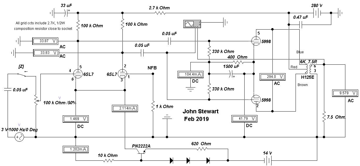

The Electra Print SE 6BX7 amplifier is unlikely to deliver 4 Watts of audio. Early in 2019 I did a series of tests on several octal twin triodes in PP configuration looking for best possible performance without NFB. The tubes tried were 6SN7, 6BX7, 6BL7 & 5998. They all have the same socket connexions. The 6BX7 managed an honest 3 Watts in PP just below clipping, without exceeding the plate dissipation spec. SE amps are normally not as efficient as PP amps. Your 6J6 would sub right into this circuit & drive any of these tubes to clipping.
Here are the Results for the PP 6BX7 version of the amplifier.doc23.5 KB · Views: 137

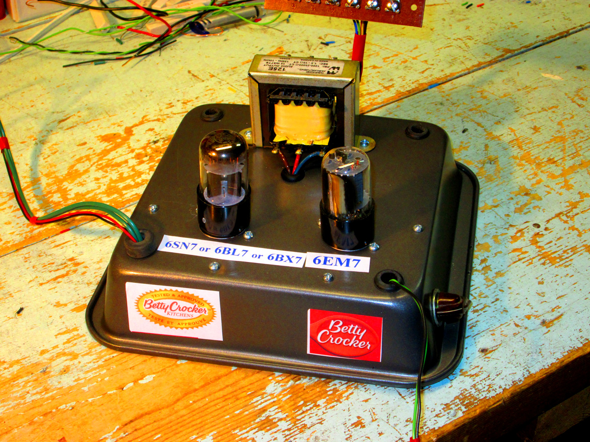

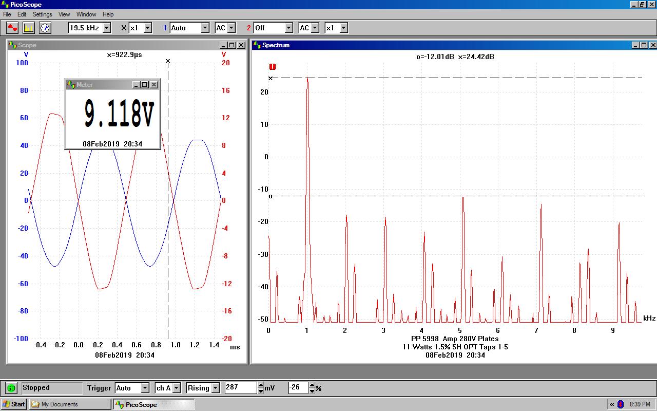

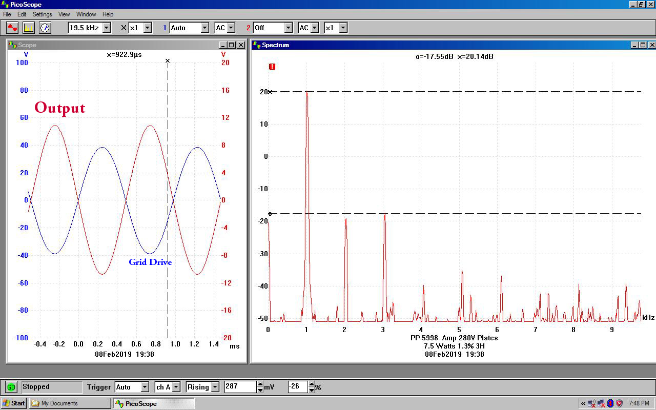

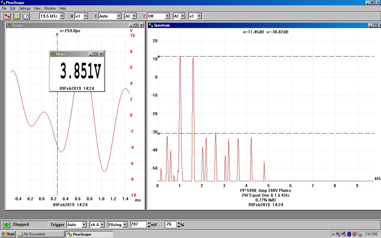

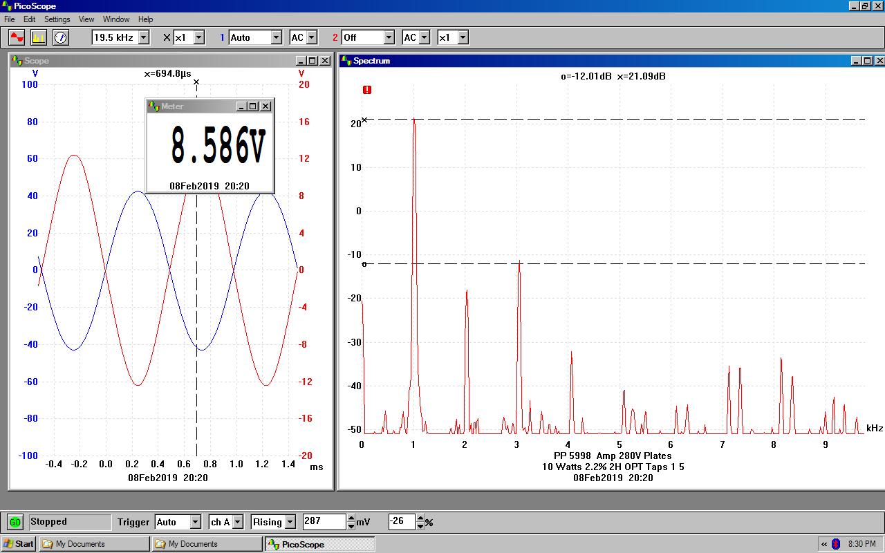

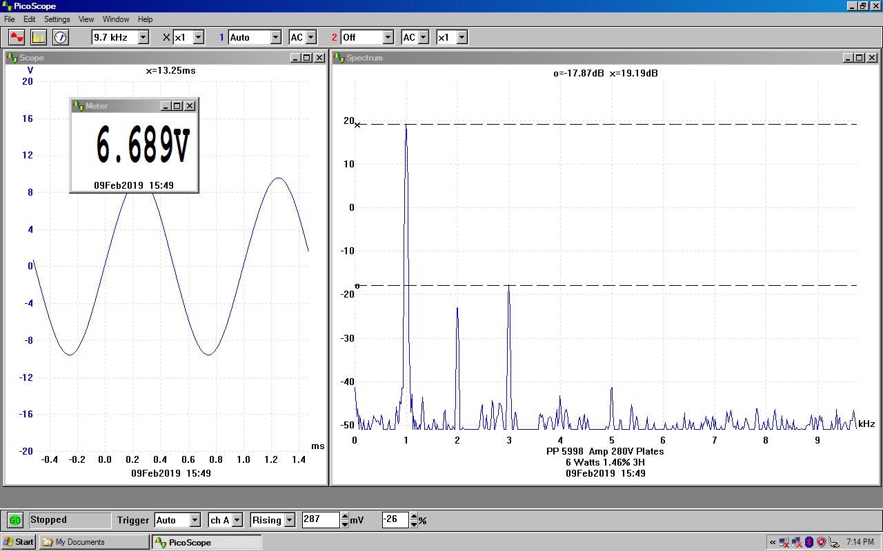

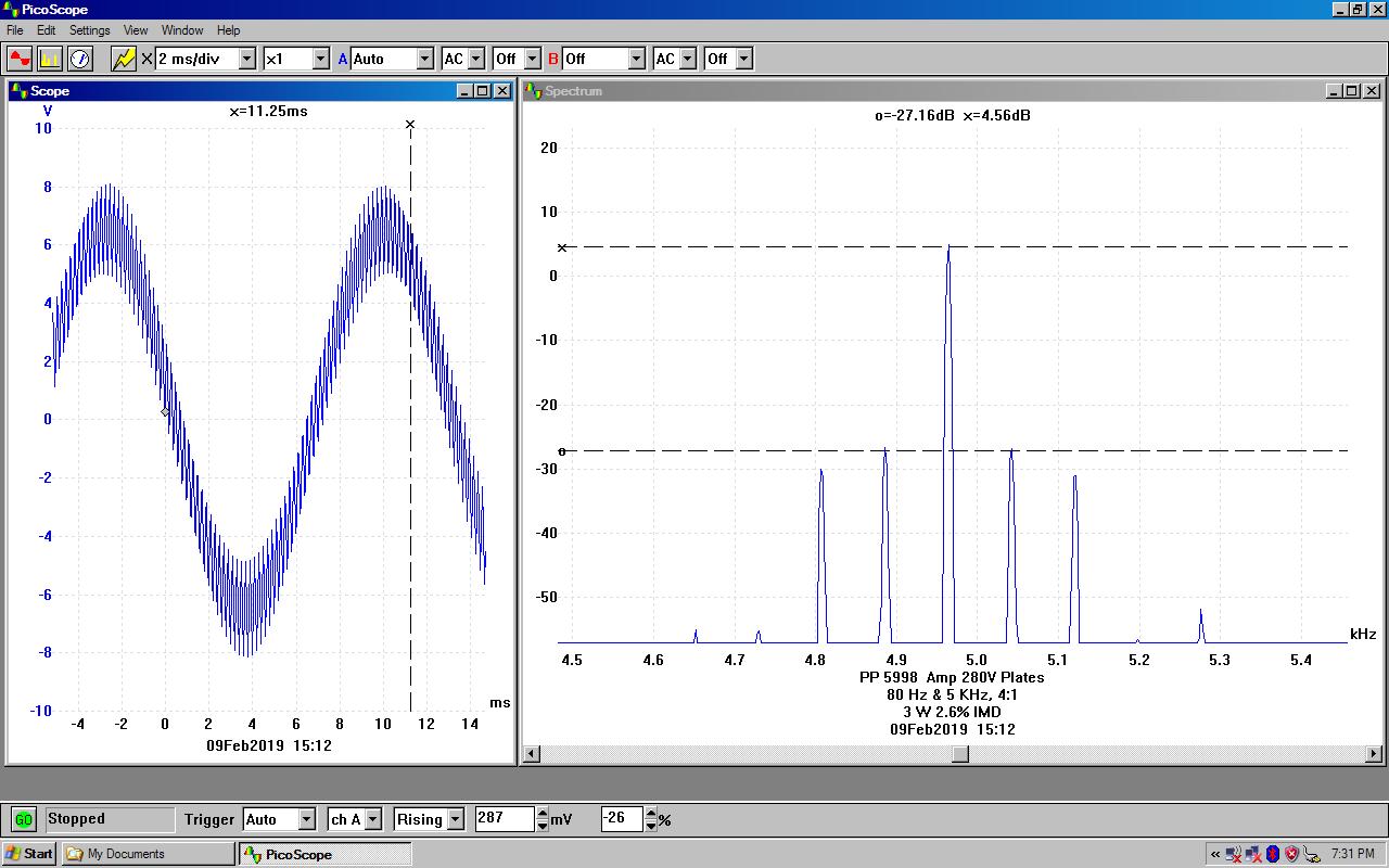

The THD is read by HP 334A. IMD & D traces by PicoScope 3224. Power Watts by MetraHit 29S Precision DVM & Wattmeter. I used 80 Hz in the IMD tests so that any 60 or 120 Hz from heaters would appear separately. The power is provided by a home grown regulated PS.

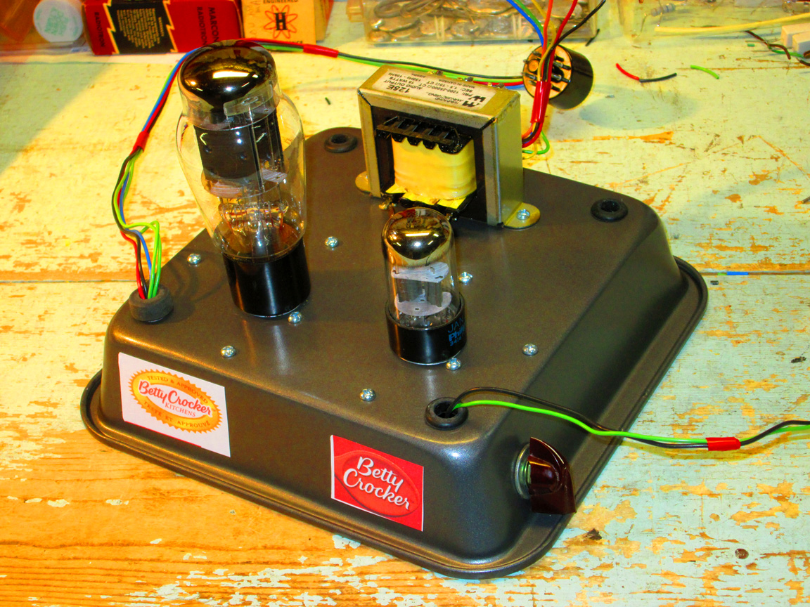

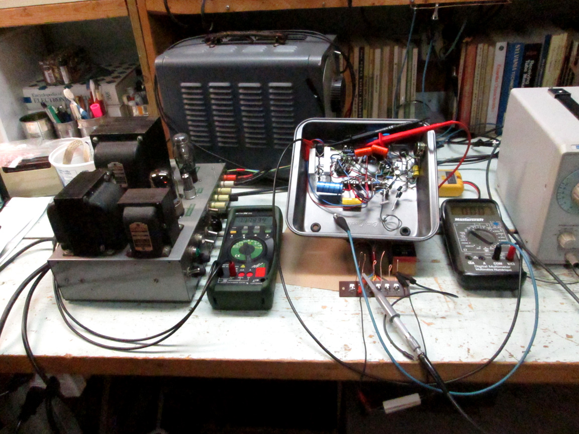

GE Variable Reluctance Pickup Response Curves

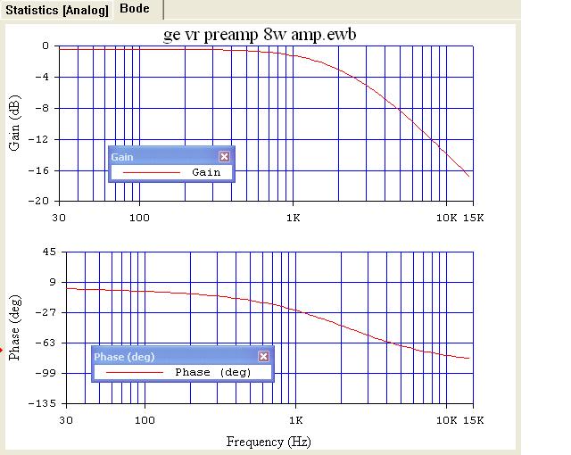

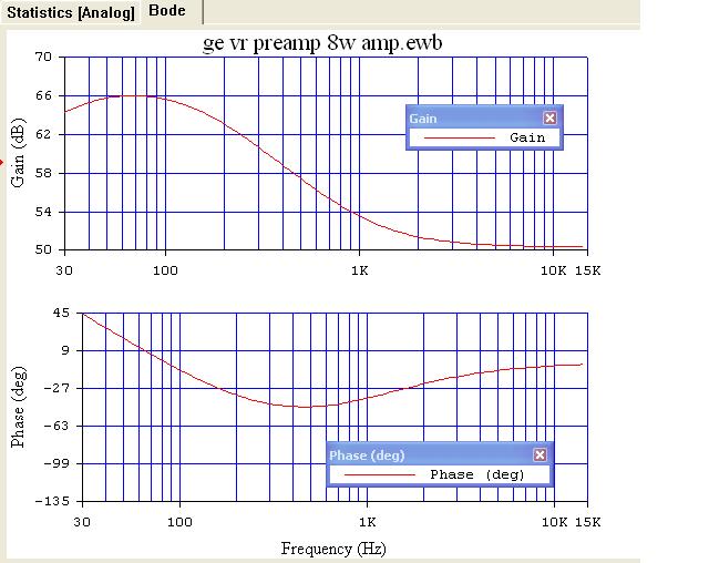

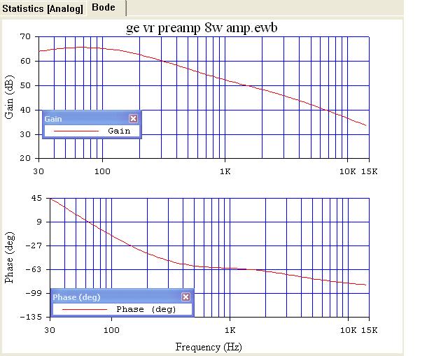

Out of curiosity I ran a simulation on the phono preamp in my very old 8W amp. There are three curves, one shewing the pickup & its 6.8K load resistor, then the response of the following 2-stage 12AX7 amplifier. The final curve is the entire path. Don't know how close this comes to the correct equalization but it sounded OK at the time it was used. Especially after a couple of alcoholic beverages!😀

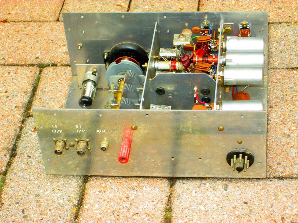

I never did anything at 2m but did build a crystal controlled 6m converter. This one had a broadband 6m front end using a 6CB6. The oscillator convertor is a 6U8. The IF is another 6CB6 covering the broadcast band. So the BC receiver tunes the 6m band directly. It hasn't run in many years, the correct crystal is lost.🙂
During the 50's many amateurs & others used the 6J6 in home grown small transmitters & receivers. They were useful as oscillators & mixers in many frequency convertors shifting 10m, 6m & 2m signals into the broadcast band.

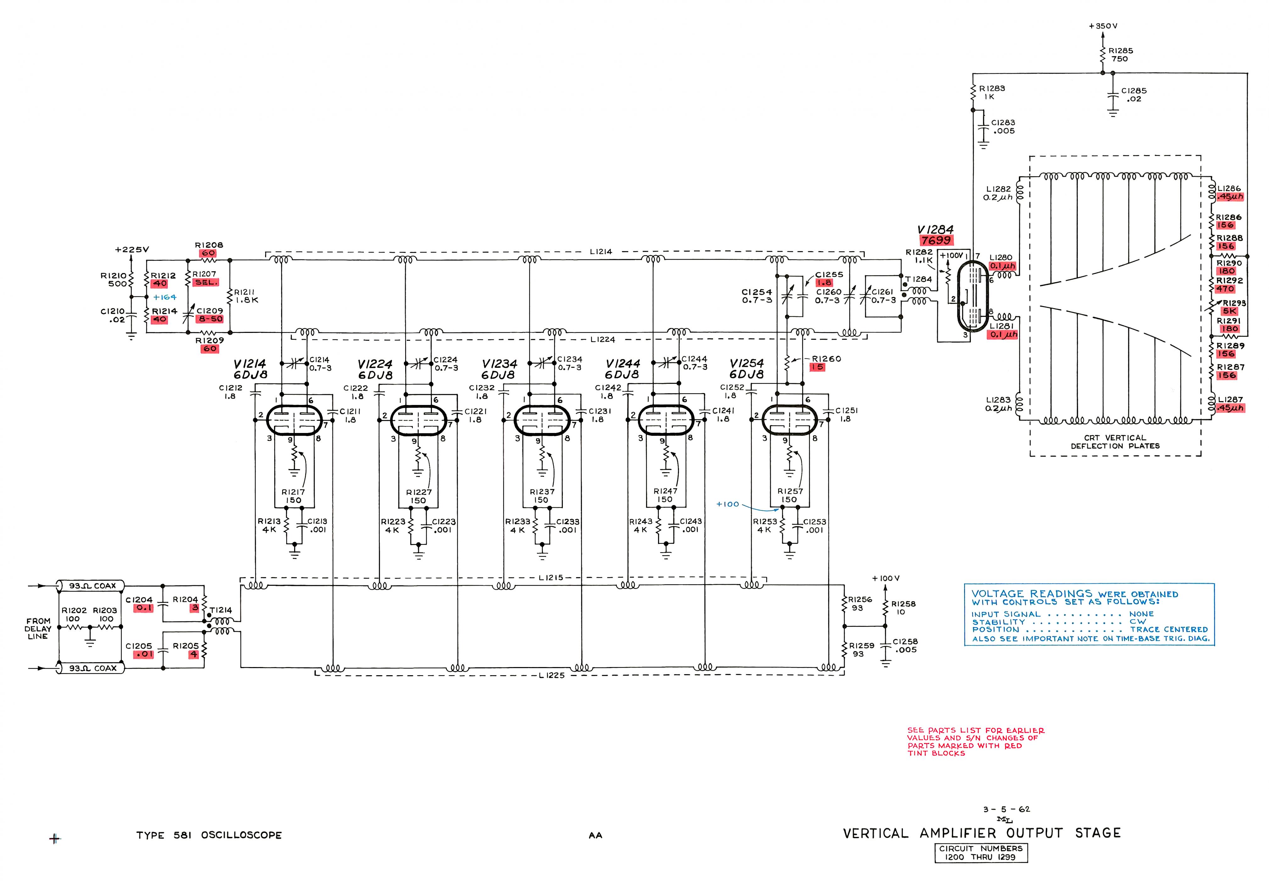

It was used in the Tektronix 581 and 585 Oscilloscopes as the vertical deflection output stage. The 585 was a 100 MHz Scope. The 7699 tube is rated on the Amperex data sheet as good to 500 MHz.
(the beam plates are connected to the cathode internally, not shown on the tube diagram, and internal capacitance neutralization is provided)
https://frank.pocnet.net/sheets/201/7/7699.pdf
I'm not too impressed with the linearity of the curves on the data sheet, but somehow Tek got 1% without N Fdbk.

The distributed amp & transmission line CRT, making gain where there is none!! The HP 180 Series was also nominally 100 MHz but all SS. A compact delay line that would fit inside the box was one of the challenges.😱
Each 6DJ8 is in balanced mode. That means the 2nd order distortion is partially cancelled.
And, then the distributed amplifier topology used to get more gain was a great engineering solution.
Later, distributed amplifier topology was implemented in both BJT transistors, and even later in GASFETs (the GASFET distributed amplifier was done by Tektronix subsidiary, Triquint, that later spun off).
The 7699 was in differential mode, even though the common cathode resistor was only 1.1k Ohms. That means the 2nd order distortion is partially cancelled.
Even without the common cathode resistor (and with more complex biasing), the circuit would have been balanced, and the 2nd order distortion would be partially cancelled.
Yes, cancellations are only partial, but 1% accuarcy was both a noble goal, and tough to achieve.
Perhaps the greatest engineering feat on this amplifier is that it is all DC coupled, with 5 6DJ8s in parallel, and driving the 7699.
But even more than that . . .
It is DC coupled all the way from the input connector, to and through the preamp, to the delay line, and then to the 6DJ8s and on to the 7699.
