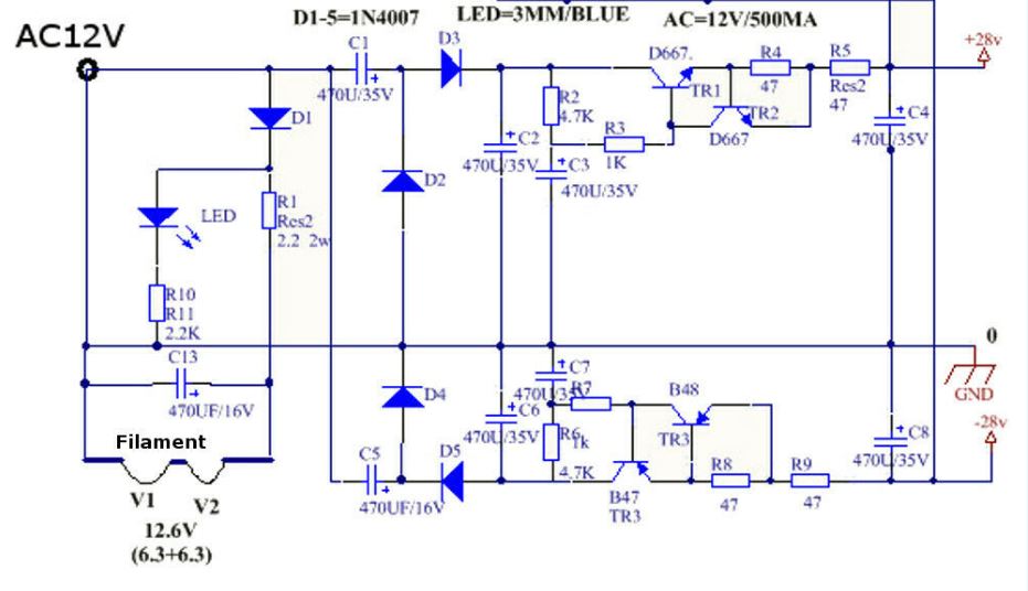

Note that this requires a 12V 0.8A AC power supply
Hi thanks ! a transformer then ... no problem at all
I will buy one. But i guess the real issue is the power supply for the plates
The schema looks good ... but i am not an expert

From the pictures in post #11 I can make out that there is a load resistor of 4K7 and that the cathode resistor is 220 Ohm. So it is indeed more a preamp than a 'true' buffer ...
Hi i understand that this power supply (ref. post 21) of the Fever design is less than optimal
Are you thinking of any mods maybe ? like increasing C2 and C6 value to 2200uF ?
I can't help you with that because my knowledge of semi-conductors is very limited. Beside diodes, the occasional zener, and LM317's for feeding the filaments of low-level stages (phono preamplifiers), I don't use semi-conductors in my projects. Furthermore I never use voltage doublers (I prefer to use the right transformer for the job).

Hi ! i am trying to understand what is wrong with the Fever power supply design just that. I like it a lot. But i have got opinions that say that the FX audio is the better unit. It uses what looks like a dc-dc converter to generate the plate voltage.

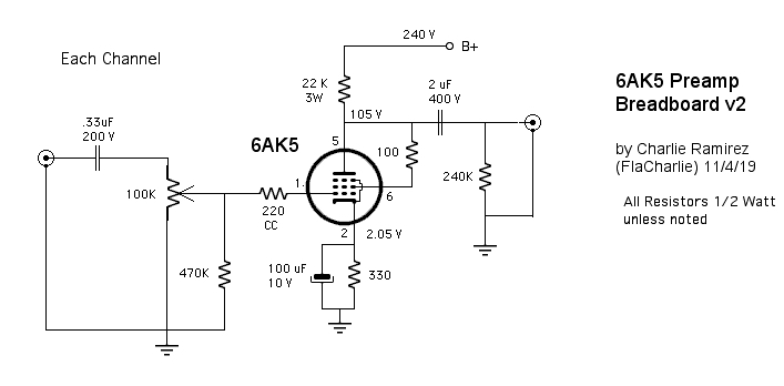

I'm not sure why you're concerned about keeping the same resistor values. If you're going to order different caps it's just as simple to order different value resistors, if that's what is needed.
Again, it's good that you realize that high voltages can be deadly but if you just use common sense you'll be fine.
I believe the wall voltage in Italy is 220vac, right? If you measure it might even be higher since it fluctuates during the day. You've got high voltage inside all of your household appliances and, presumably, you have enough sense not to go sticking your fingers inside them when they are plugged in and turned on.
There are plenty of schematics out there that are simple. No need to calculate or design anything from scratch. The stuff I build is mostly copy and paste. I posted two schematics over at AK. I've attached one of them. I used a bench power supply so this is only the audio portion. Each channel uses: six resistors, two film caps, one electrolytic cap, one volume pot and two RCA jacks. Super simple.
I'm not necessarily suggesting that you use this, just posting it as an example of simplicity. I just threw it together to get an idea of what this tube sounded like with more "normal" voltages. A true buffer using this tube, a 12AU7 or a 12BH7 or whatever, will not be much different.
Breadboarding a design allows you to change things around easily. Sockets like these use screw connectors, no soldering needed.

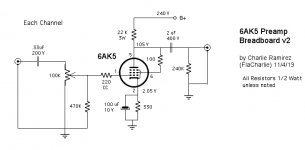

I'm not sure why you're concerned about keeping the same resistor values. If you're going to order different caps it's just as simple to order different value resistors, if that's what is needed...

If you're building using a schematic there is no design involved. No parts to calculate. The design work has already been done.
Pentode wired as a triode is simple. If you look at the schematic I posted you'll see a 100 ohm resistor between Pin 5 (the plate) and Pin 6 (Grid #2, aka the Screen). That's all there is to it. The tube now functions as a triode.
1) I've never built a buffer so I can't comment on any difference in sound. A buffer will not have gain, a preamp will. Some have more, some less, depending on which tube you use.
2) I agree. There are many, many tube types. Part of the fun of building things is that you are not limited to using the same types that others use.
3) Yes, more voltage is needed. Not a problem. A traditional PS uses far fewer parts than the one used in the FX style preamps. They are physically larger, but fewer parts are needed. The larger size just means they're easier to work with because you don't need a microscope and tweezers.

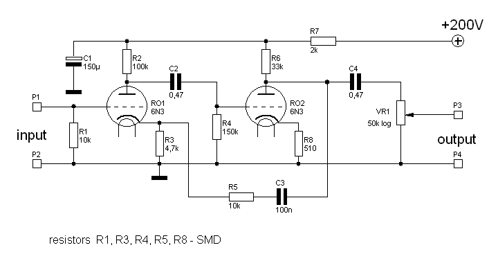

I followed the link you posted and then searched for a schematic. This SainSmart unit is also not a buffer. It's a preamp / headphone amp. Here's the thread I found.
Extra Cheap & Cheerful SainSmart 6N3 Preamp
There's some discussion of the circuit and its problems. Although some posters liked it, the guy who started the massive FX thread at AK has one of them too and in the last post he says the FX is better
i find the same thread myself. I am attaching the schematic from that thread even if i am not sure it is true to the actual unit.
I have bought one. I am going to use just RO1 and take the signal out of the cathode before R5 I guess could even take out R02 ?
Therefore R01 will work as a plain buffer. The lack of a pot at the input will not be a problem at all for my purpose
I do not know about its Z out ... i hope it will drive a normal SS power amp I have one that i like much with a very low Zin=5k Crazy i know.
But really i do not need voltage gain in the preamp and actually i am always fighting with too high gain in the line stages. I do not know why some line stages have Vgain of even 10 times 😱
The buffer should provide that tube effect i am looking for
