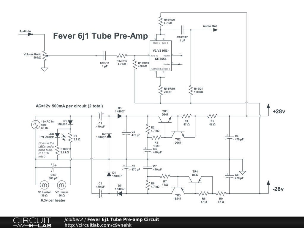

From the pictures in post #11 I can make out that there is a load resistor of 4K7 and that the cathode resistor is 220 Ohm. So it is indeed more a preamp than a 'true' buffer.
If I look at the two schematics I could find with more or less the same set-up, I'm puzzled by the dc appearing at the output terminals. The outer contacts of the output terminals are connected to ground, while the inner/signal contacts of the output terminals sit at -28 V (through the 100K resistors). Would that not be problematic if you connect this buffer/preamp to an amplifier without an input capacitor?
But maybe the schematics I found are not correct and/or don't reflect the buffer of TS.
As I said previously, the device you're listening to is not a buffer, it is a line stage preamp.Starting from the positive listening notes on this small device . . . I dismissed some of my prejudices. In particular with respect to buffers. In short, when well done they can sound very well and perform very well the function of line stages when voltage gain is not necessary (my case). . . . But it made me realize that a buffer can give an extremely musical and pleasant tone to the sound.

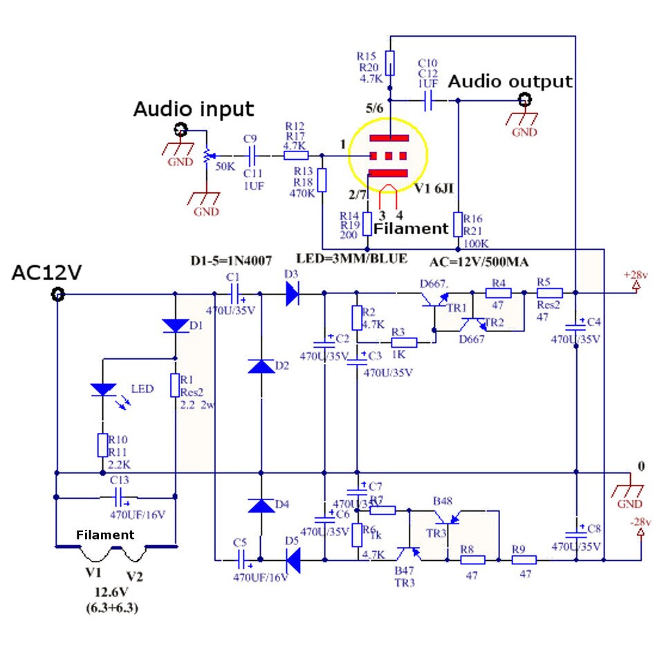

Both those schematics have that last resistor (100k ohm) incorrectly drawn to -28 volts. It should be to the ground. I believe in real circuit it is to the ground, so no problem with actual circuit. However, this is horrid circuit with terrible hum problem. Stay away.
You're right. I looked some more at the pictures in post # 16. I can see now that the 100K resistors (R30 and R31 on the circuit board) are connected to the outer contacts of the output terminals. So no dc at the output.
As I said previously, the device you're listening to is not a buffer, it is a line stage preamp. The Chinese sellers may call it a buffer in their advertising but that does not make it one. It's a single pentode tube, connected as a triode, that takes its output from the plate (anode). A buffer takes its output from the cathode.
Hi ! thank you sincerely for your valuable technical support. Message received. The only tubes i have seen so far are triode ... pentodes are too difficult for me ... to complex to understand. I do not even understand triodes.
the gain seems fine. I can control the volume quite well. But now i am worried about its Z out ... too high for a solid state amp ?
The only buffer i knew of was the cathode follower. Thanks a lot for explaining me all this clearly. Now i am scared ... a pentode must be even much more complex to deal with than a triode.

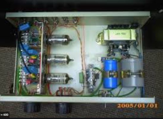

i forgot to mention one thing. In the past i had a tube preamp that i lost somewhere and cannot find it anymore. It was a phone plus line stage called Croft Micro (see pic from web attached). I disliked its construction ... cottage hifi they called it And especially tubes mounted horizontally I prefer them vertical.
Anyway the phono was realized with two ecc83 (they were TFK ... the good ones with the diamond that goes away if you rub it, i.e. genuine i guess)
Not using the phono i gave one TFK tube to a friend for his dac output stage. I tried to get it back but he received me with a shotgun ... he must be in love with that tube 🙄
Listening only cd not a big issue. The Micro line stage instead FWIU is just a single 12au7 wired as cathode follower. I quite liked the sound. Then i read that in some designs intended for the 12au7/ecc82 the more power hungry 12bh7 could work as well and i tried it.
What a change ... the bass came out more powerful and controlled ... the sound was much cleaner Almost solid state sound but very natural ... not etched at all. Loved it.
I was using just the line stage tube with the other two tubes removed, worried about the increase in power consumption of the 12bh7

Actually, the tubes used in the FX are pentodes but the tube sockets are wired in such a way that they are functionally triodes. This is a very simple modification.The only tubes i have seen so far are triode ... pentodes are too difficult for me ... to complex to understand. I do not even understand triodes. . . . But now i am worried about its Z out ... too high for a solid state amp ?
If you look at the "Fever" schematic in post #21 you can see (even though the tube is not drawn in the traditional manner) that the Plate and Grid 2 are connected. Usually, a resistor is used between the two but they seem to have omitted it. A cost cutting measure, I suppose. A 100 ohm resistor is commonly used. The second schematic doesn't show this connection, they just draw the tube as a triode, so it's a bit misleading.

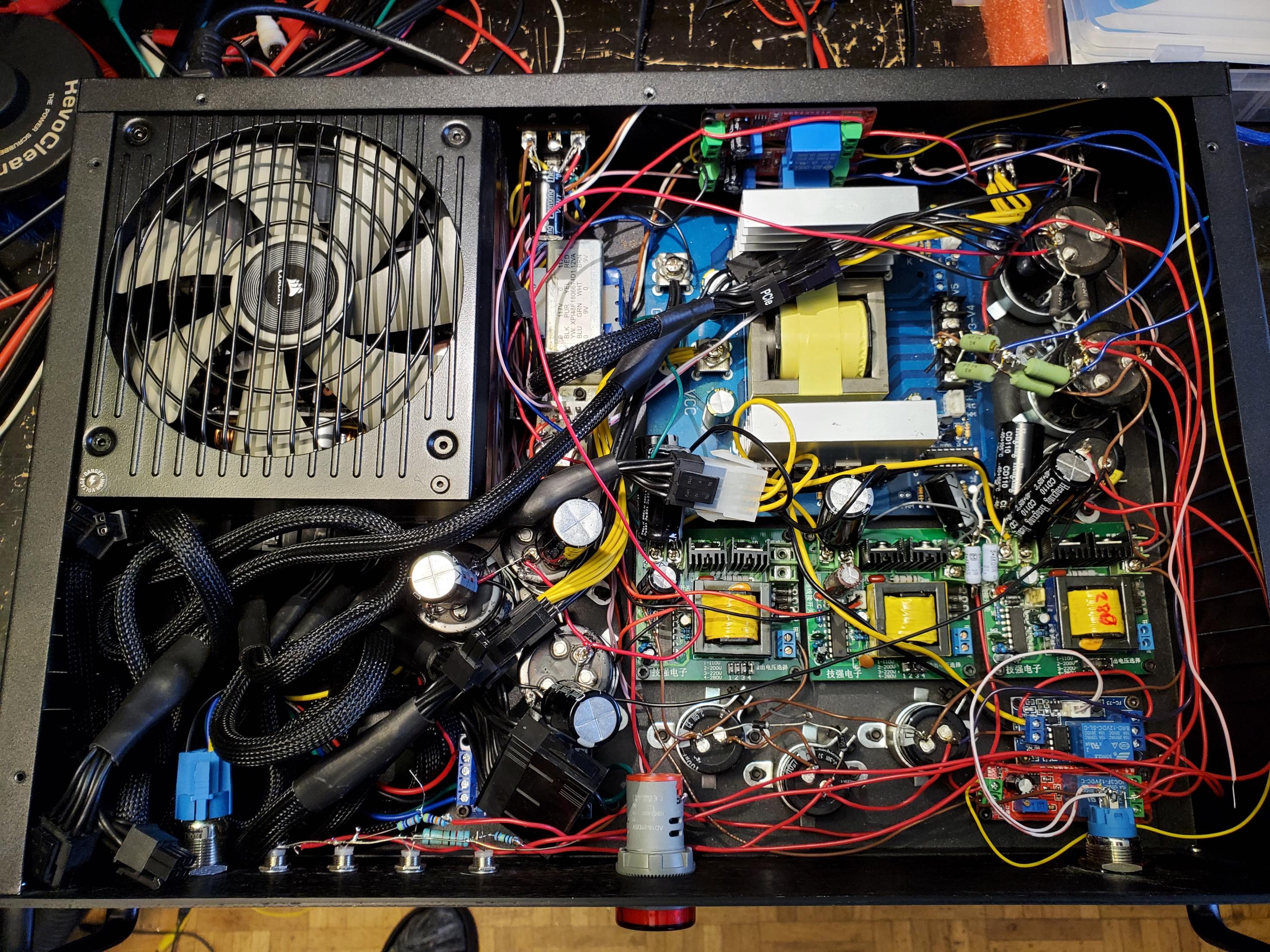

Here's a picture of the main PSU for my integrated tube amp... Output voltages are 280V, 330V, 560V, and -200V (for bias).

The "Fever" schematic was posted earlier and also on the AK thread. The only difference between it and the FX seems to be in the power supply sections. I get the impression that the FX version is much better.Hi ! thank you so much for your extremely kind and valuable reply and advice

I believe others here have built the Fever kit and it didn't get very good reviews. I haven't read the whole thread and I have no interest in doing so. There are other similar threads on here too. Do a search.
A quick search revealed a post which describes mods that must be done to to the Fever to eliminate hum. See Post #85.
The use of a printed circuit board makes it more difficult to perform mods.
6J1 China preamp thoughts
The tube is being fed with the same voltages and uses the same resistor and capacitor values. One would expect the resulting sound to be identical, unless the power supply degrades the sound in some way.
So I'm not sure what you think you will gain, other than the experience of just building something. Unfortunately, that "something" may not be as good as what you have.
Oh, the pot I linked is a stereo pot. But I doubt that using slightly better caps and/or resistors will make much difference if the basic circuit is flawed.
There is very little difference between this preamp circuit and a buffer circuit. It's just wired slightly differently, that's all.
Here's a recent buffer build thread. If you compare the audio sections of FX with this you'll see it's just as simple.

if the preamp circuit is exactly the same the degradation can come only from the power supply design and executionThe "Fever" schematic was posted earlier and also on the AK thread. The only difference between it and the FX seems to be in the power supply sections .... The tube is being fed with the same voltages and uses the same resistor and capacitor values. One would expect the resulting sound to be identical, unless the power supply degrades the sound in some way.
As i do not think that the heater can cause any particular noise (i read that sometimes they are even run with ac voltage) the main suspect is the plate power supply
In my Fx audio unit it looks like a dc-dc step-up converter In the Fever a circuit made out of discrete components.
I much more worried by the preamp circuit than by the power supplies.
