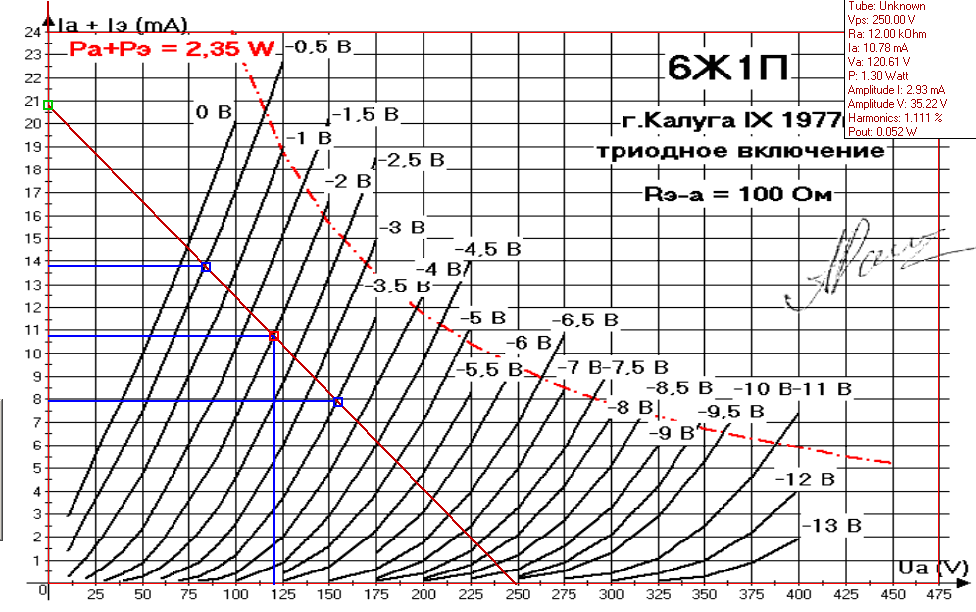

Yes and no. The datasheet curves tend to be less reliable at low voltages where the tubes were seldom used. When I draw the same load line I see the -1V intersection as being closer to 2mA, meaning a 500R cathode resistor. Nevertheless, your measrements do look a bit further off than I would expect. Are you sure you have a 10k anode resistor and not something larger? It's also possible that your valve samples are rather old and worn out!
* Less reliable at low voltages
I tried three 6J1 tubes and got always similar results. How could the plot in the datasheet be produced for low voltages, if it can not reliably be measured?
* -1V / 500R
Your load line can be correct and mine a bit off. As written in the OP, I also tried a 470R resistor. With that I measured 0.75V and 1.6mA. With 500R the voltage should be a little higher and the current a little lower. Still too far from the datashee in my opinion.

(Measurement: Rc: 1k, Uc:1.1V, Ic:0.95mA;....
Should not my measurements be much closer to the datasheet? (Measurement: Rc: 1k, Uc:1.1V, Ic:0.95mA;
Datasheet: Rc 556Ohm, Uc: 1V, Ic: 1.8mA;
Ra: 10k)

I got today 3 pairs of matched tubes (RTC 5654, Mullard 5654, and russian 6J1P).
I just measured the RTC pair with exactly the same setup as in my previous post.
The RTC pair gives me 0.96V / 0.93V across the cathode resistor.
The Mullard pair gives me 0.93V / 0.93V.
The russian 6J1P pair gives me 0.78V / 0.80V.
In comparison my three chinese 6J1 give me 0.76V / 0.76V / 0.8V.
RTC & Mullard came closest to what I expected from looking at the datasheet.
The russion 6J1P & and chinese 6J1 deviate too much from the datasheet.
What did I learn: Never trust a datasheet, but always measure, measure, measure 🙂

Triode connected 6j1 you got from data sheet referred to screen Vg2 @120V, so now Vg2 only 60V, hence the variations. Anyway attached is the plot for 10k loadline, Vg2 120V, it's close to your finding. I think you stick to original first since it sounds good.

You can expect a well-made valve to be within maybe 30% of its datasheet. You cannot expect a valve to follow the datasheet of a different valve, even if many people say they are equivalents. Fortunately well-designed valve circuits are not too fussy about such details.kdre said:RTC & Mullard came closest to what I expected from looking at the datasheet.
Best wishes,
Klaus
Datasheet values for tubes are just average, tubes with exact datasheet parameters are pretty rare, for double tubes are very rare. We can find new tubes with +/- 30% or even +/-40%. Some russian datasheets says the range for parameters, western datasheets vary rare says this. For example Telefunken says they guarantee for E803CC max spread 15% for each section, this means we can find max 30% differences between the 2 triodes in a tube. And this is a special tube, high quality.
Tubes with 70% - 130% plate current are very good ones
Attached examples for 3 tubes 6J1P from a large batch tested by me.
