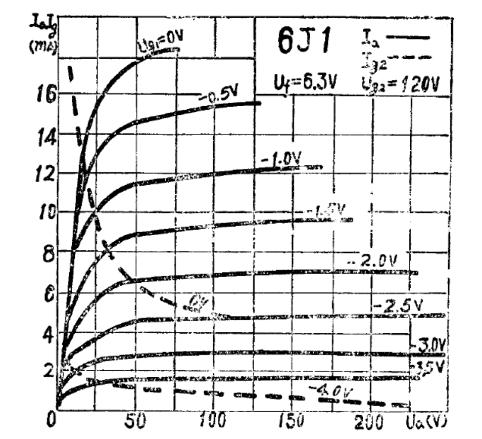

Triode connected 6j1 you got from data sheet referred to screen Vg2 @120V, so now Vg2 only 60V, hence the variations. Anyway attached is the plot for 10k loadline, Vg2 120V, it's close to your finding. I think you stick to original first since it sounds good.

I don't see any mention of Vg2 on the curves Kdre linked to??Kinda confusing, why is there a notion of Vg2 when the pentode is triode-connected...😕
The Raytheon datasheet referred to by the OP shows the pinouts differently.😕
I know... that's why I wondered why koonw brought it up.I don't see any mention of Vg2 on the curves Kdre linked to??

Well the triode is not running at 60V as shown in the datasheet, Vg2 is 120V, 60V would be different data, that is what I meant. You need correct screen voltage to sim correctly, as we derived triode from pentode mode in this case I need a correct pentode plot Vg2@ 60V to derive a model first.
Eh? That's the same datasheet I linked, isn't it? All the ones here seem to show the same pinout too.The Raytheon datasheet referred to by the OP shows the pinouts differently.😕

Triode curves are as given on the datasheet. No need for pentode curves.You need correct screen voltage to sim correctly, as we derived triode from pentode mode in this case I need a correct pentode plot Vg2@ 60V to derive a model first.
The datasheet that I referred in my OP post says G2 and G3 are connected to plate for the presented graph. My understanding is that therefore it cannot be @120V. Anyway I don't understand how G3 can be connected to the plate if it is internally connected to the cathode. Probably a type as others mentioned.

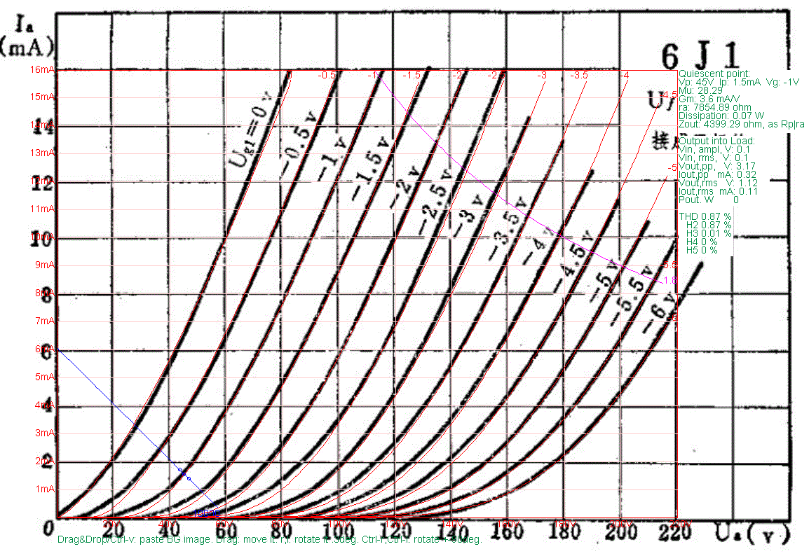

No problem. The model derived directly from datasheet is per attached #2
To sim little bear I got the diagram but no values, so maybe you can label it on sch? I'll sim and see how it's using existing model (Vg2 @120V).
Sorry for asking, but the plot shown in post #2 and this one (post #6) are different. The one in post #2 is for a triode connected 6J1 pentoded. The one in post #6 is for a pentode connected 6J1. Am I wrong with that?
My understanding is:
When connected as triode g2 is connected to the plate. Therefore, Vg2 is linked to the power supply, which is not fixed to 120V, but represented by the y-axis in the plot.

Correct. I'm not sure what Koonw was talking about in post #2. Maybe he mispoke.My understanding is:

Well it's the way triode model is derived. It is possible for more than one triode model to be generated depending on the operating points. So you were given a triode connected pentode do you know what model you have being given? Is it actual test gear plot or derived from Pentode model (without test gear)? Say if derived from Pentode there must a specific Vg2, different Vg2 generate different triode model (correct me if I am wrong). As far I know to sim correctly especially with Pentode model, one must use a model based on very close Vg2 actually used.
Since the modelling is not unique therefore it's possible for different triode connected pentode model hence the variation. This is what I suspected for variation, maybe I am wrong. If you're not simulating it does not matter really.

But his main argument to answer my questions was that I have 60V instead of 120V which is why I measure cathod voltages/currents that are far away from what the datasheet says.
So, if his main argument is not valid, then my questions from the OP are still unanswered 🙂
Should not my measurements be much closer to the datasheet? (Measurement: Rc: 1k, Uc:1.1V, Ic:0.95mA;
Datasheet: Rc 556Ohm, Uc: 1V, Ic: 1.8mA;
Ra: 10k)

You can not derive triode model from pentode model or your model is only accurate at the specified Vg2 AND where Va=Vg2.. There can't be multiple triode-connected pentode model. There can only be one.
Yes and no. The datasheet curves tend to be less reliable at low voltages where the tubes were seldom used. When I draw the same load line I see the -1V intersection as being closer to 2mA, meaning a 500R cathode resistor. Nevertheless, your measrements do look a bit further off than I would expect. Are you sure you have a 10k anode resistor and not something larger? It's also possible that your valve samples are rather old and worn out!Should not my measurements be much closer to the datasheet? (Measurement: Rc: 1k, Uc:1.1V, Ic:0.95mA;
