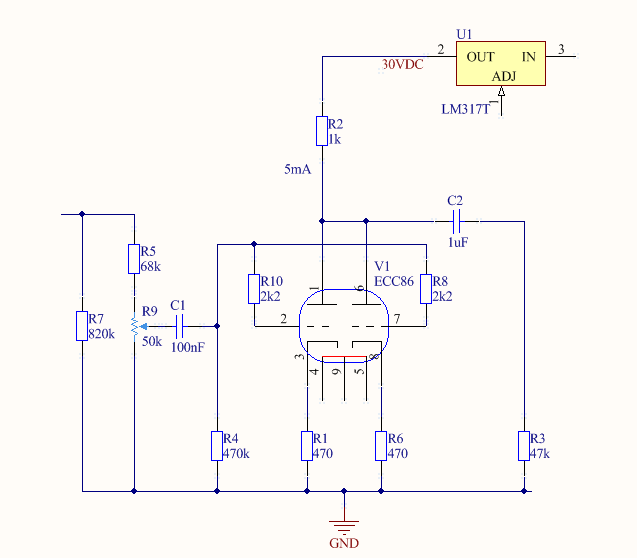

Here is the heater circuit I will use.
Very good, you are using DC on heaters, "tube guys" very often do not do that.

If using DC on filaments, constant current is a great way to go. I usually use AC, but hard to beat a CCS.
I always use DC on heaters, but never with a CCS because of the risk of thermal runaway on heaters designed for constant voltage, it can be done if experimentally determine the steady state current. On the other hand, with just a couple of valves, it should be easier.
AC on heaters is prone to intermodulation, even in indirect heated valves, via the AC magnetic field and cathode-heater capacitance.
Another advantage to use DC is that you can implement a soft-start circuit which prolonge valve life.

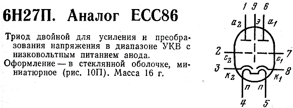

Are you sure? The datasheet say: Pin 9 is to 'Internal Sheild'. But that is not to heater, so maybe you are right.According to Philips data of ECC86, pin 9 is not connected to the heater at all.
So one heater pin should also be grounded.

This is the circuit I have now.
The working current is 5mA - 2.5mA per each of the two parallel triode halves. The voltage gain is around Vgain = 4.
The circuit input voltage will be like 0.5 Vrms, like 0.707 Vpeak. for driving my Chip Power Amplifier at full output.
The output from the tubes will be max +/- 1.15 Vpeak. The voltage at cathodes will be like +/- 0.28 Vpeak.
The trafo will be 30VA 2x24VAC I will parallel 2x24 to one 24VAC output. After rectifier the power supply will be like 33.5-36 VDC
The LM317T has a voltage drop of 2.5-3 Volt So I count on getting 30.0 VDC at the LM317T output.
Will be two LM317T .. one for each channel regulated supply.
Why two ?
I like to build real dual mono. There is one trafo and one rectifier bridge. But two LM317T - one for each channel. The two LM317T will be adjustable via potentiometer for exact 30.0 V output.

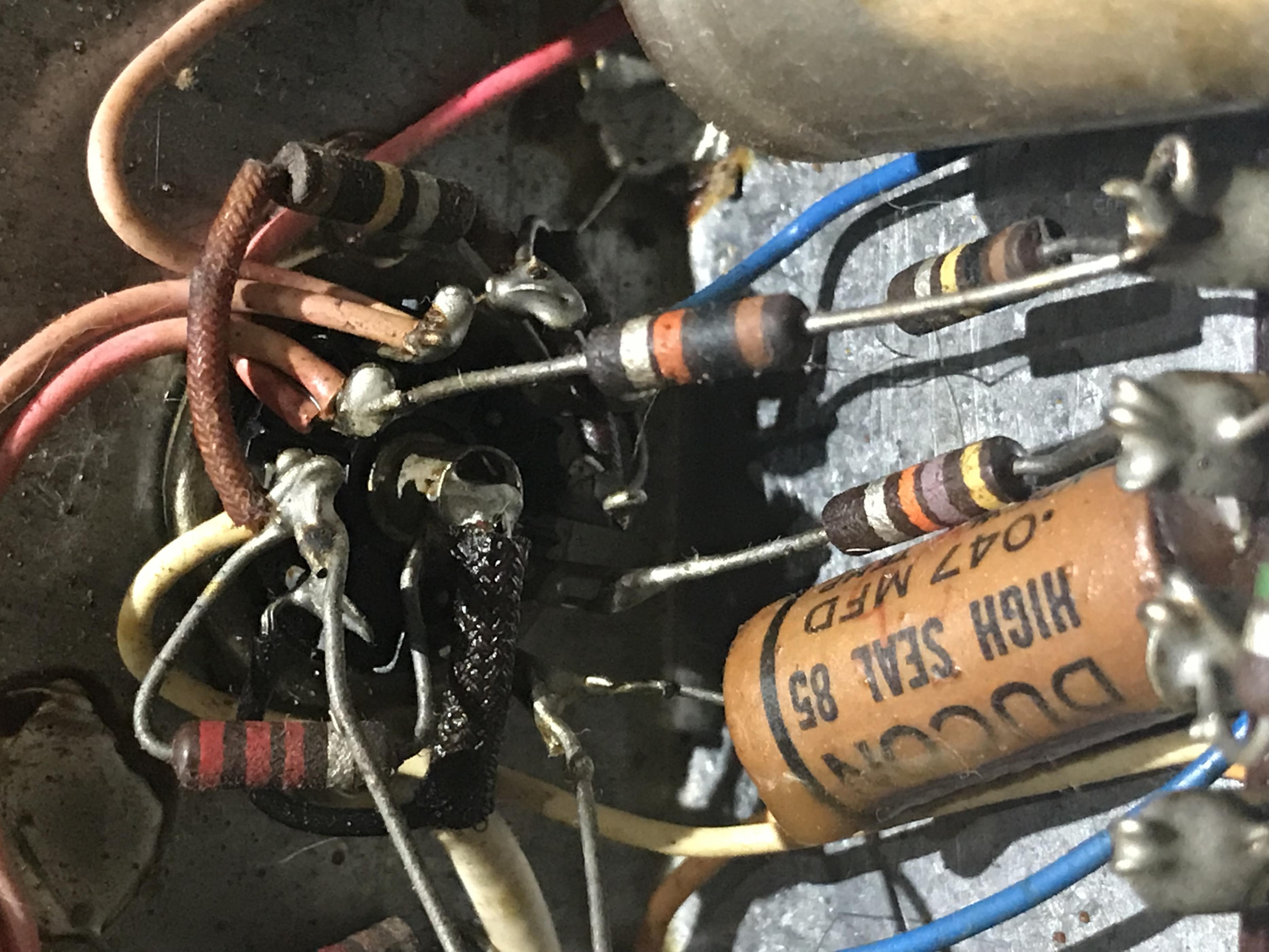

I have a question. In the tube sockets I bought, there is a connection in the middle. But there is no tube pin corresponding to that connection. Why is there such a connection in the middle?

This is the connection to a tubular shield in between the pin contacts.

I could be wrong, but I think this could be used as a place to connect multiple connections, like ground, when doing point to point. I’ve got an old amp with something like this. Hard to see but the line in and a resistor from one of the puns are both connected. Coincidentally the tube in this photo is 6gw8, not 6gm8. Close 🙂

So it seems I should connect pin4 or pin5 to ground. The heater. And also pin9 - the internal shield to ground. And also the mystery connection terminal in middle to ground.
