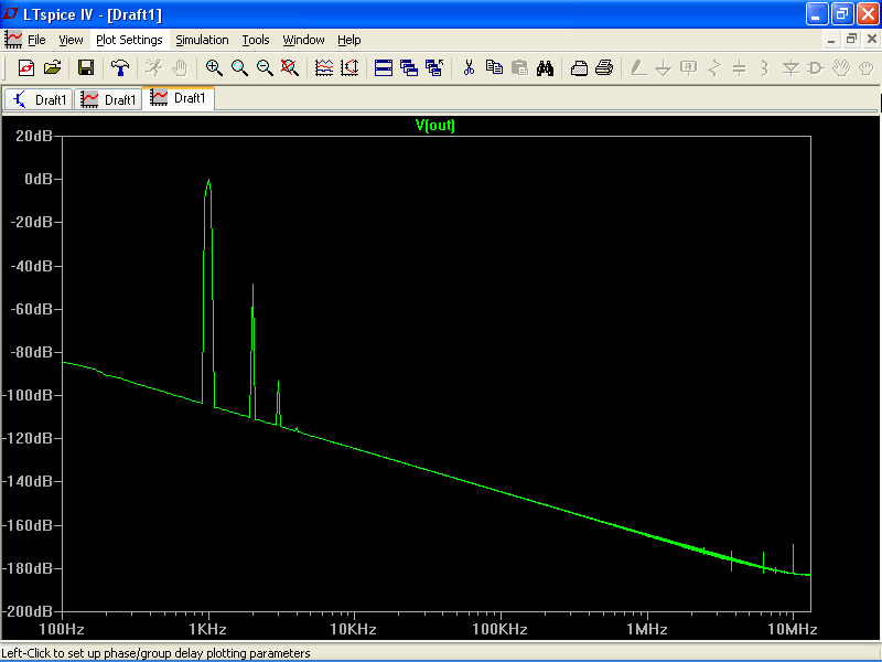

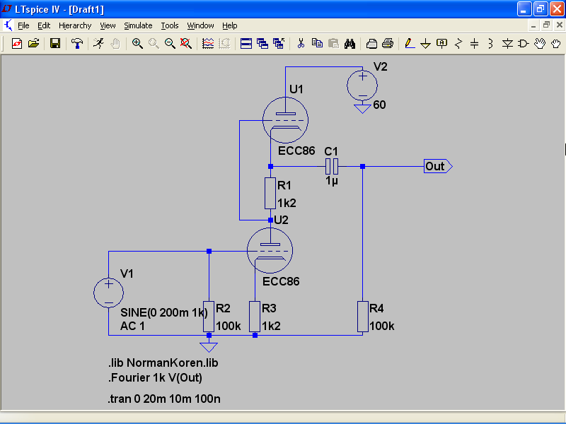

None of the above, an SRPP stage (+B=60V) will have lower THD, mostly second harmonic.
Thanks for that option.
Now, I want a lot of harmonic distortion.
This is why I not use solid state, transistor/opamp, for this project.
I want to get 'tube sound'.

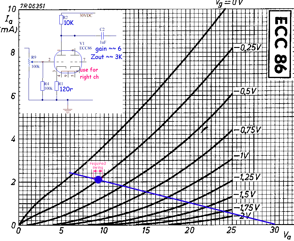

You can do that with one of about any triode, 10K load, just a few volts of supply. THD may approach 5% not-nasty.
Given 30V supply you are likely to be nearer 0.3% THD, not "a lot" but perhaps euphonic.
If you truly want "a lot of harmonic distortion" then you want to dial-down the B+ from 30V down to a couple of Volts. At this power level a 10K pot can turn-down the power until the harmonic distortion reaches "a lot".

Bias the stage 1. to high plate voltage (with cathode resistor) and you get high 2nd harmonic distortion.
Below circuit generates 4.6 % 2nd harmonic distortion at 2 Vpp output level.
Thanks for your circuit.
What is the cathode capacitor for?

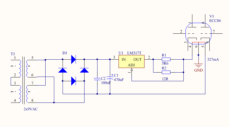

Heater for one ECC86
Here is the heater circuit I will use.
It uses LM317T as a constant current source. The current will be 327mA.
Of course I will use 2 such ciruits. For using 2 tubes in stereo. But only one transformer 30VA 2x9VAC.
