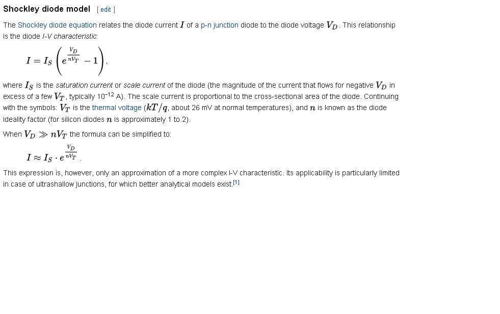

From Wikipedia, this is the diode model:
attachment.php
This is the well known diode equation, that relates I to V in a diode. If you take the voltage derivative of such equation, you will get the conductance of it. And if you get the reciprocal, the diode dynamic resistance. You will see that it is strongly non linear. Then the cathode voltage doesn't respond linearly with anode current creating lots of distortion, like a BJT.
This distorted current to voltage distorted ratio will be amplified by the tube (mu +1) Rl/ (Rl +Ra) appearing in the anode circuit.
I sincerely can't understand why to use a tube amplifier which in turns, will have solid state kinds and amounts of distortion, with the size, cost and power waste of tube amplifiers.
