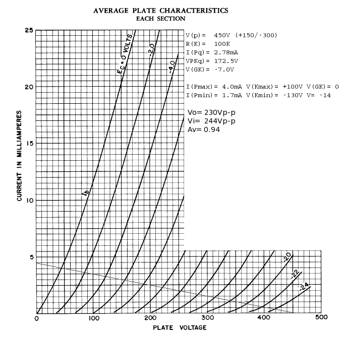

All right, here's what I've got so far. How does it look?
There are a couple of problems there. No way is that LM334 thingy going to operate off less than two volts. You're gonna need a negative supply for that.
You're also gonna have to adjust the resistors in the bias networks. You stated earlier that you want to vary the 6F6 bias from -10Vdc to -30Vdc. This will require 6SN7 currents of:
(300 - 10) / 100E3= 2.9mA
(300 - 30) / 100E3= 2.7mA
From the loadline (attached) that means a Vgk= -5Vdc to -8Vdc, or a total grid voltage of: -15Vdc to -38Vdc. If you give it some leeway, -10Vdc -- -40Vdc, then replace the 2M5 resistor with 860K, and the 250K resistor with a 33K resistor. Keep the 100K adjust pot and its guard resistor, and the decoupling capacitors the same.

All right. It makes sense that the loads would be different for this bias range. A -300V supply seemed daunting at first, but a small isolation transformer with a doubler should be OK. and if the LM334 doesn't like such a low voltage, I might as well just use the -300V supply to feed a nice long tail resistor for the 6SL7's. Maybe 280V to allow for some current draw as well as a decoupling RC filter.
