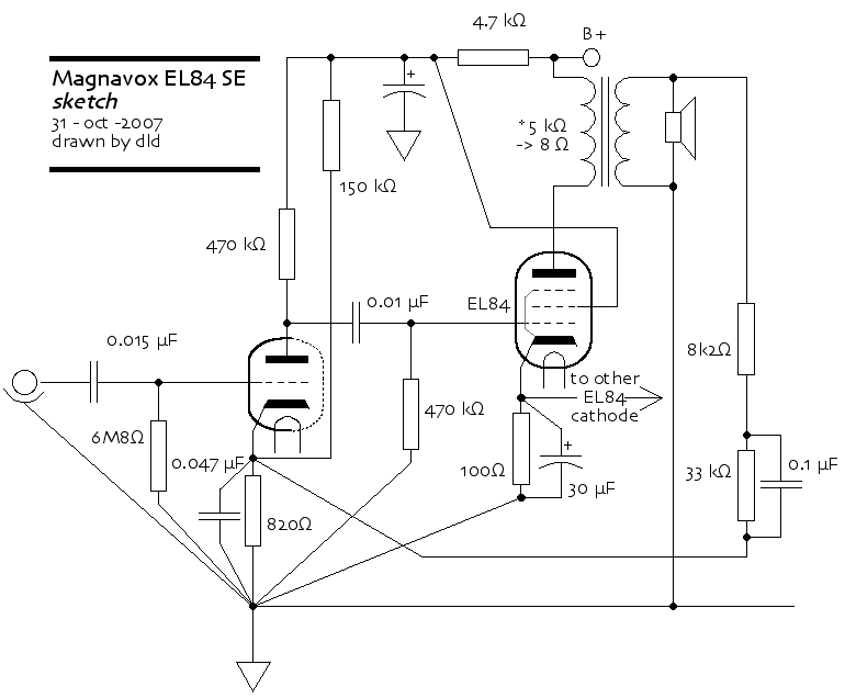

I have found quite a few negative feedback values. From single 6k8, two 6k8 in series, one 20k ohm, and to comples two resistors with one cap parallel to one of those...

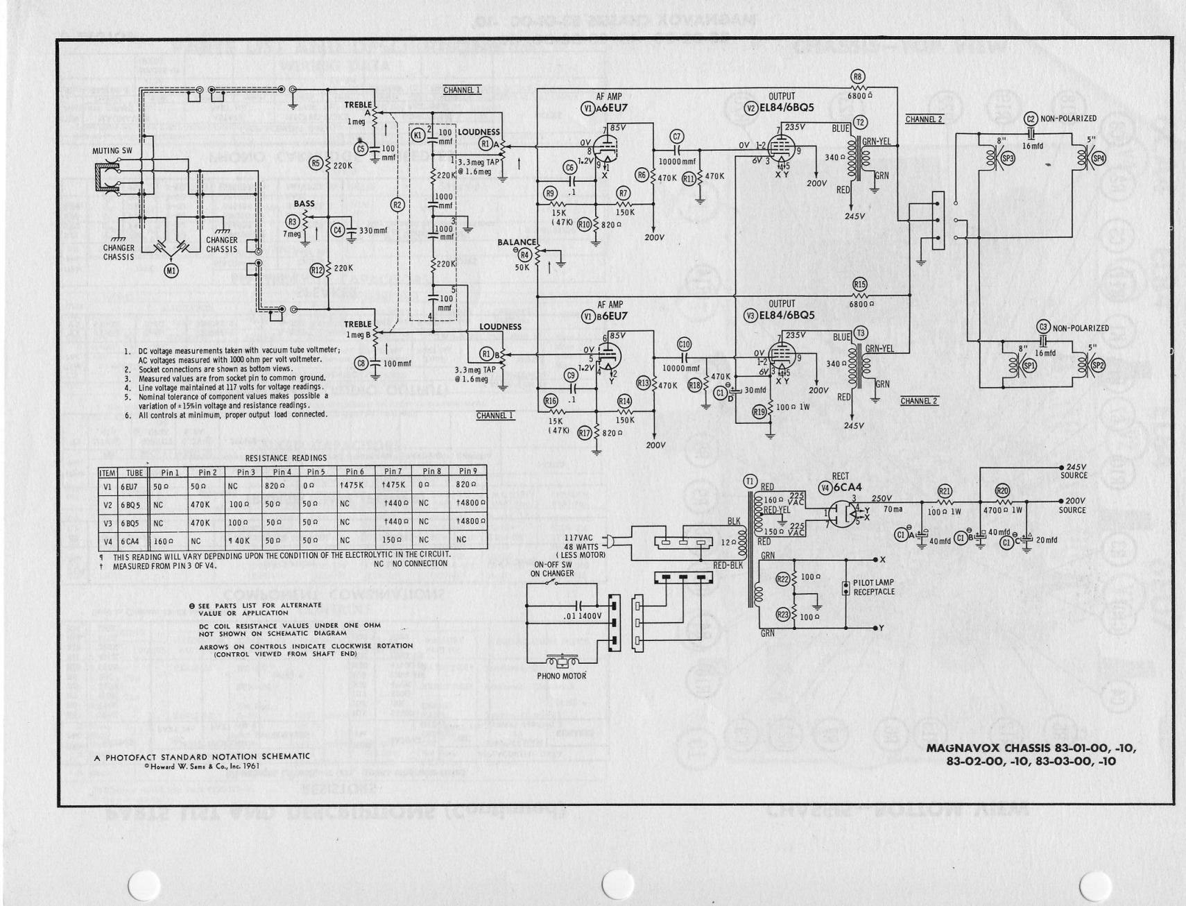

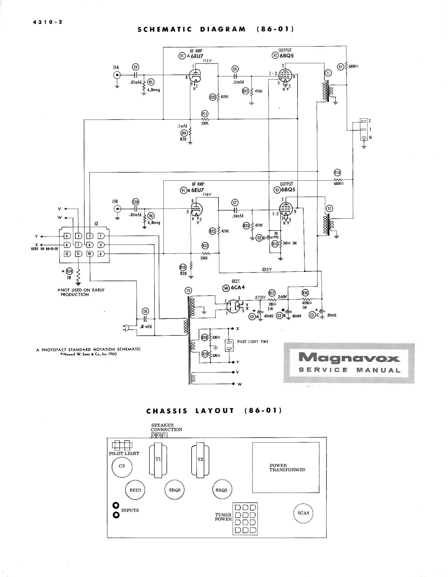

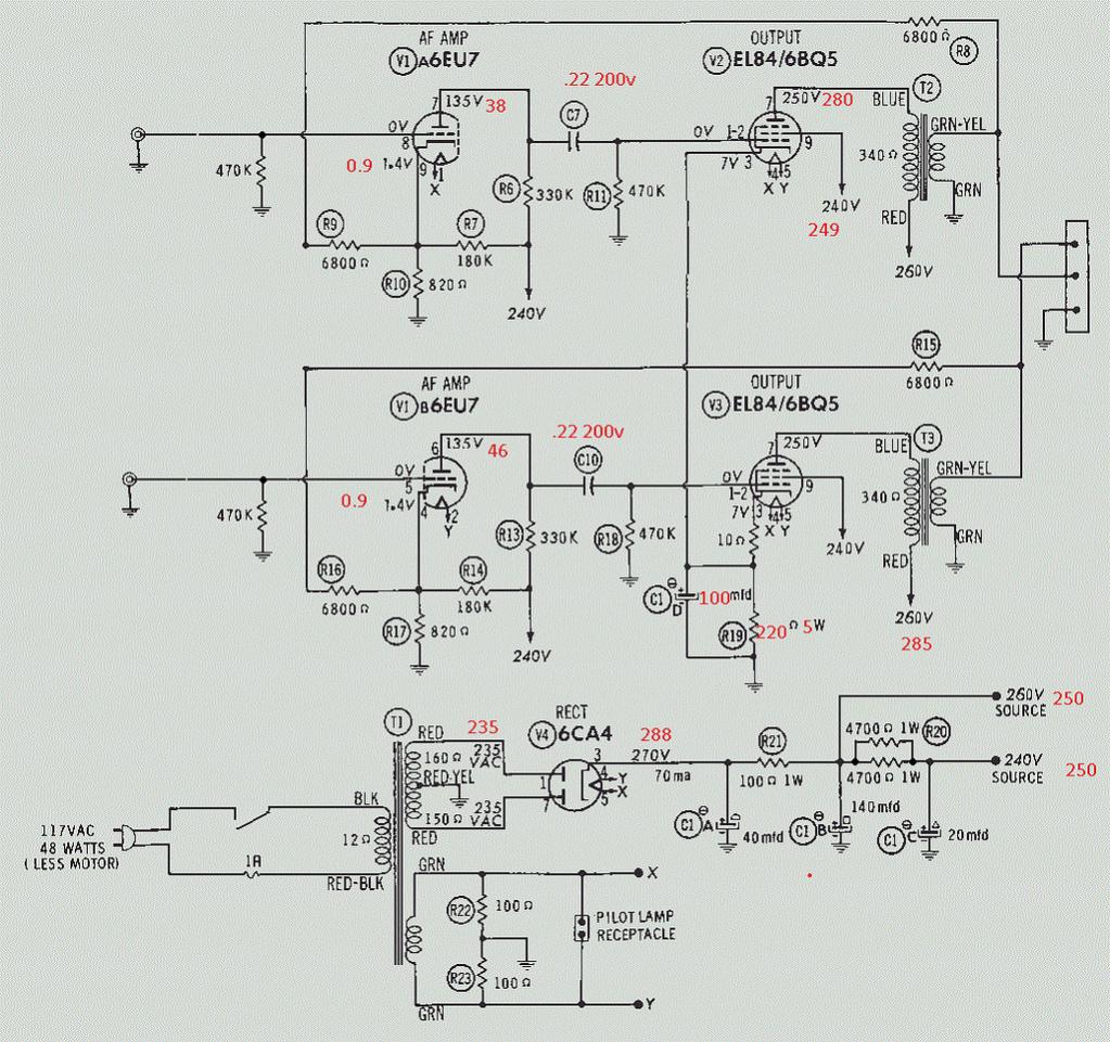

So here are some schematics to start with. Its hard to say what original schematics was, as it was modified so many times. I am however sure it had this complex feedback with two resistors and one cap. It seems to me its there to shape the fr response, almost like in riaa preamp...
Anyway, righ now I have 40k resistor there and it sounds good. I even tried open, and it worked great as well. With one 6k8 resistor it motorboated. I though it would be other way around.

Can you explain what the capacitor role is in that feedback, and how its value changes the resulting fr response? Thanks.
I had one of these 6EU7 6BQ5 stereo SE amps when I was a teen - as I remember it sounded quite good. Since you have the tubes I would run them. (Schematic was 3rd from left - solid design)

Improving the Magnavox 8600
Dave Gillespie did an excellent thread at Audiokarma on rebulding/improving a magnavox 8600 with instructions that average diyers can follow.
The improvements are astounding. He starts with an amp that is only producing 1.35 watts per channel before the onset of heavy distortion and finishes with an amp that puts out 4 watts per channel with much lower distortion.
This is the thread title "Magnavox Flea Power: Getting More Out Of The 8600 Series - A Lot More!"

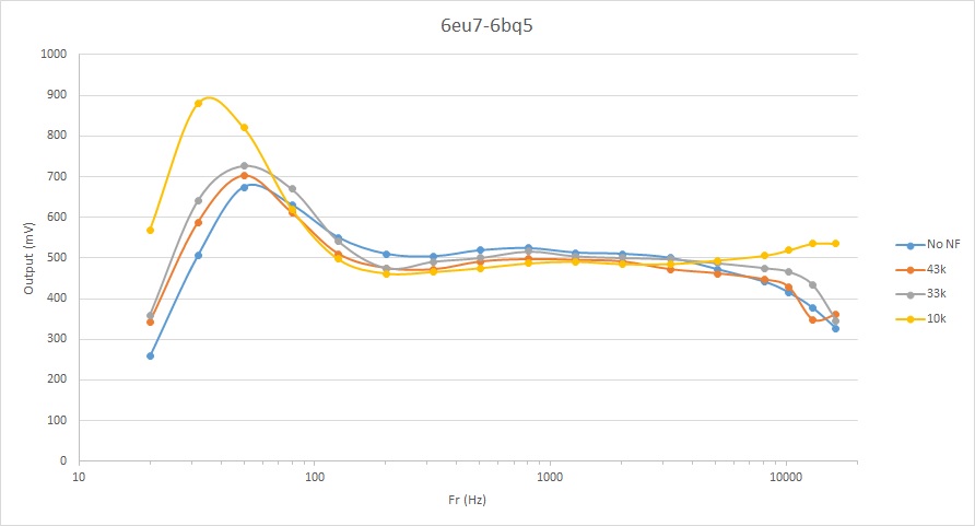

In the mean time, I measured frequency response. With no feedback, with 110k ohm, 43k ohm, and 20k ohm feedback resistor. It measures (and sounds) best at no feedback, or just 110k ohm. It distorts at 20k ohm feedback. And motorboats at 6k8. First of all, it measures pretty badly, that is...its not flat at all. How can something measuring so poorly sound so good. I should measure it in dB, I know, I just took the average voltage from the oscilloscope.

Well, if you can get 4 wpc out of this, leave the 6EU7 tubes in there. The reason I suggested the 12AX7A is because it has the same characteristics and can be run from a 6.3 V heater supply. Additionally, these tubes are easy to find just about everywhere tubes can be found. The 6EU7 is a specialized tube for low noise, lower than the other 12AX7 clan. It is more expensive to replace and harder to find out in the wild. It would sound identical to the 12AX7a. Save the 6EU7 for a phono amp project. It just seems like a massive waste to throw those tubes into a power amplifier where it's very low noise isn't being used. I was very surprised to see it was being used in that amp to begin with. They belong in a nice preamplifier.
Feedback. Your curves don't look right at all. Feedback will progressively flatten your frequency response at it is increased. The main component that determines how much feedback you are working with is the resistor. The capacitor in parallel with that resistor sets the high frequency roll-off point where the response should begin dropping. The larger value of that capacitor will lower the frequency and reduce the phase margin. What you really want to do is have the gain fall to less than unity before the frequency that the phase shift makes the negative feedback into positive feedback (from the value of the resistor). The capacitor works with the resistor in setting this frequency, so you can't just change one without calculating the proper new value for the capacitor in the feedback network. The other very useful trait of feedback is that it lowers the apparent output impedance of the amplifier as well. That increases the damping factor and is one reason why the response curve becomes flatter and extends flat to higher and lower frequencies. As the feedback is increased beyond the ideal range you will begin to see a peak forming at the high frequency end of your frequency response plot. Eventually it will increase to a point where the amplifier oscillates at that frequency.
-Chris
Thanks Chris, yup, something is not right, that's why I said I do not understand that feedback, it should be the other way around. I better check if everything is connected right. But I connected everything as it was in the original amp...hmm.
Gentleman! As I came home and was checking it twice...kidding aside, I found no mistake in circuit, besides, I am listening to it and it sounds fantastic...but, but I realized those fr responses I posted were measured using small 6 ohm fullrange speaker and not using true resistor! So that could most likely explain uneven fr response, right? When I will find some time, I will measure again using resistor, 8 ohm, 20 watts or so. Sorry it did not occured to me earlier.
(still it does not explain why more feedback made things worse...)
Output Transformer Impedance
Did you measure the impedance of the output transformers?
I have seen specs that say they are 5,000 ohms into a 3.2 ohm load. Dave replaced the transformers with ones designed for an 8 ohm load so they would be more compatible with modern speakers.
There are variations among these amps based on the outputs that Magnavox put into the consoles.
I have the 6V6 stereo bi-amped version and high frequenct OTs are for 4 ohm output. I put a pair of Heil AMTs (3.7 ohm measured resistance) on the outputs and get ~4 watts at clipping. Response is -3db at 45khz.

I have just measured the amp with 4 ohm 20 watts resistor, at 0.5 volt output set first at 1 kHz for all the feedback types...this is what I got.
Off course this is after I switched the output wires 🙂 My bad. Now the feedback behaves exactly as it should. Frenkly no feedback, or strong feedback, the amp sounds great to me. Yes, some feedback will be used, I will further experiment, but I am slowly starting thinking about putting it into permanent box.
Now, how about that low frequency hump?
