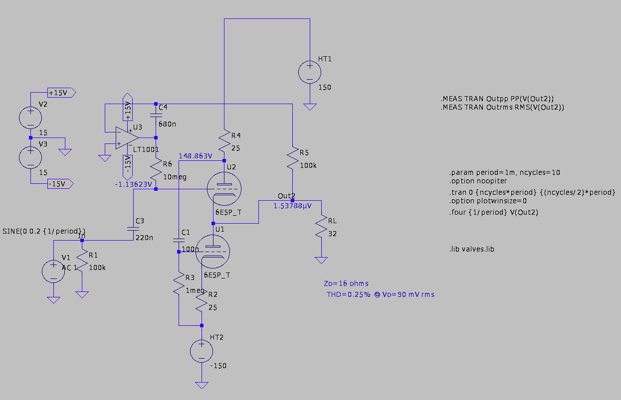

Indeed, the valve stabilised after 20-30min. I managed to get a model very close to Dmitry's.
http://www.bartola.co.uk/valves/wp-content/uploads/2012/05/6e5p-triode-model.png
I may have recorded incorrectly the tracer settings as it seems like the grid start voltage was -2V and not 0V....
Here is the model
http://www.bartola.co.uk/valves/wp-content/uploads/2012/05/6e5p-spice-model.txt

I was looking at the datasheet of that valve and the lifetime is stated 500 hours ?!?!?!
In that case, maybe the Pa (max) is optimistic. Just a thought.
Indeed. However can't comment on that as haven't used it yet.
Interesting to see that there is a close brother of this valve, the 6e6pe. Longer life one with similar characteristics. It's a bit price though, but may be worth looking at this one as well....
Another thing to remember is that if you are using cathode bias, grid current does not start when the input signal peak is equal to the bias voltage in magnitude.
This is because of the feedback from the cathode resistor. In simple terms, when the input voltage is 1.3V peak and the bias is 1.3V, you induce an additional voltage drop in the cathode resistor of (24mA/V*1.3V)*32) = 0.998V !
Of course this becomes a cat-chasing-its-tail situation since the increased voltage drop reduces the differential due to the input voltage.

The arithmetic in your second sentence is wrong, but your third sentence suggests that you know this.

Interesting Lars. Can you please explain the topology, is it an anti-triode configuration?

Haven´t cared to name or define it😉. But anything with "mu" will do.

Well, it looks to me like a gyrator with a mu or anti-triode output (I think Michael Koster named it or referenced it as such), correct?
Same function. Gyrator this time🙂?
Indeed, but I thought that when the output was taken from a midpoint of the source resistor, that would provide the lowest Zout (Zout/2) compared to the gyrator equivalent?
Wouldn't that be the case when taking the output from the pot?
NO, no gyrator at all this time this time. Look at the battery as a signal short. If you take the output from the midpoint, Zout gets higher, not lower. When taken directly from the source Zout will be just a few ohms. When taken from the midpoint you will get a useless ballpark Zout of 30-40ohm. So Antitriode is no option here.
Ops, my fault. I didn't look at the circuit properly. So it's just a gyrator...

Noooo, the second one is NO gyrator, the cap can be omitted😉.
Question is wether the the battery would harm fidelity? No current through it so one could try Lithium cells. Thorsten L. used them in series with signal when adding grid bias. Think he bypassed with a small cap and a large resistor though.
