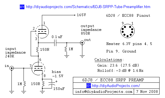

6DJ8/ECC88-SRPP Tube Preamplifier
Ooops forgot the schematic.😱

Either don't use an SRPP or optimize the loading- in a very nice article a few years ago, Merlin Blencowe showed that unlike common-cathode voltage amps, an SRPP will show a distortion null at some (relatively low) value of load. As well, the gain is extremely high for a line amp- he'll probably clip his power amp with the volume control barely advanced.
The schematic has a couple of glaring errors (the input impedance and the bias voltage). You could use a larger cap at the expense of overload recovery time. Or you could substitute a cheap red LED to get near-instantaneous overload recovery, some pretty light, and slightly reduced cost.
He has a clone Aleph X of 100W, what's the correct bias voltage?
I have on hand these LEDs:
1.8V 20mA Yellow water clear
1.9V 20mA Red
1.95V 20mA Yellow
2.0V 20mA Green
2.1V 25mA Greed diffused
Wich one do you recommend?
How can reduce the gain?
The quoted LF point of 1.6Hz assumes no load (not even a scope probe!). I'm not sure where the input impedance of 240K comes from. The output impedance of 850ohms may be correct (I haven't bothered to do the calculation) but it will only apply above about 2kHz with a small output cap. Everything points to this design being done by someone who is new to audio and so ignorant of details.
I built several SRPPs (actually I am using it in my phono and line preamp). Here are my advices:
- You can go up with the B+ until 300V. A 350V filtering capacitor should be used in the PSU then. Good PSU filtering is essential, I use also local decoupling.
- You can eliminate the lower cathode capacitor. Gain will be about 16x, just suitable for line preamp. Linearity is also better. Some like the "softer" sound with cathode capacitor, though.
- To avoid oscillation, a small resistor (220R to 1k) should be soldered in series with the grids at the socket with short leads.
- Output impedance is about 1.2k.
- Input impedance is equal to the grid leak resistor.
- I use 1.5k cathode resistors, anode current is about 5 mA.

-I can go till 300V for B+ but isn't too high?
-If I like cathode capacitor can I use 100uF or 220uF or other value?
-I will use Salas HV shunt regulator for B+, how much current draws the pre?
-OK 220R-1K in series with the grids
-Input impedance 1M?
Hello,
I am in agreement with SY the SRPP is very sensitive to load impedance. Where you take the output of the series arrangement shown will make the circuit no longer SRPP. Move the output to pin number 6. The gain will be ½ the mu of the triode at the operational point of B+/2 for each triode with a cathode resistor of 150R. A gain of ~15 is still way high in my view. Roll in a 12AU7 and see how you like that.
edit: remove the cathode bypass capacitor. This appliciation of series triodes has been around from the early 1940's or late 1930's.
DT
Where is he substituting the LED? for a cathode resistor?
This combo has too much GAIN!
