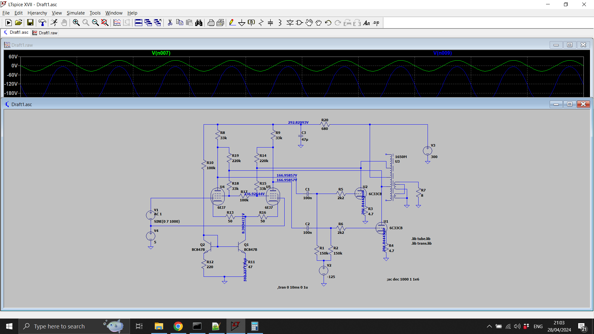

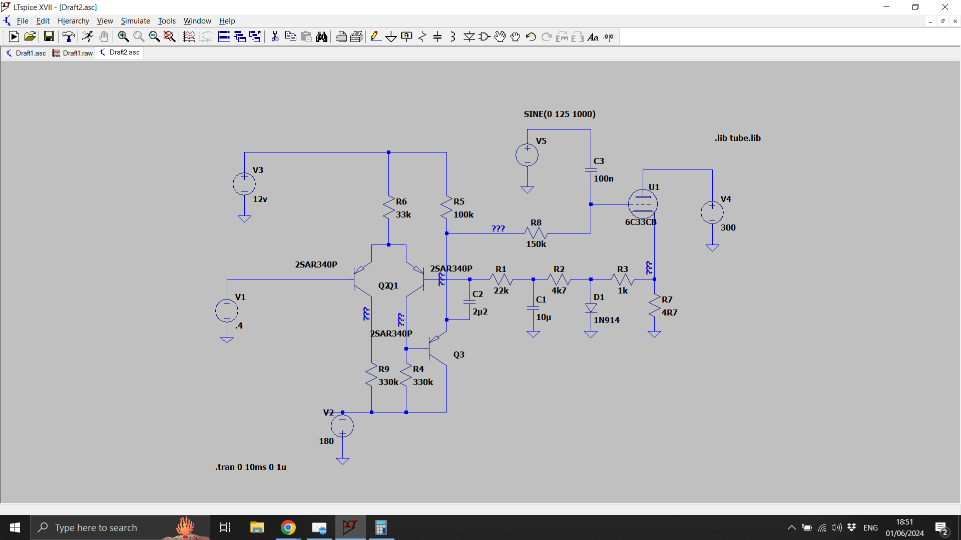

1) Turned round the negative voltage sources so as not to confuse.
2) Is it better to drive the screens with high impedance by increasing R14, R15 or low impedance and use resistors to ground to reduce the screen voltage. What works better when the 6ej7's are not matched? R13, R16 would be a 100R pot for DC balance.
I choose the 6ej7 just because I have a load upstairs and I can match a few. I used them for 10.7MHz FM IF stripe before finding the gain was too high. I now use 6bw7's here. I have 6ba6, 6ac7, ef80, and a few others but don't think they are suitable - all seem lower voltage than the 6ej7 ratings some variable mu.
3) trying to find a spice model of the 6528. They don't seem easy to obtain in the UK. Does look easier to drive. Probably not as visually attractive. Given I have a collection of 6550 amps would be nice to have something look a bit different.
Tried a 12BY7 in simulation. This works too but needs the screen lowering with resistors to ground. Its important to keep R19. Without it the screen goes to near 0V and this causes a much higher saturation voltage on the plate which limits the drive range.
I would guess that driving the screens with a lower impedance would be best, since they do draw some current. You will still need comparable attenuation of the output V.
For matching, the cathode pot should work for balancing gm, but you may still find a DC imbalance. The coupling caps to the outputs should take care of that.

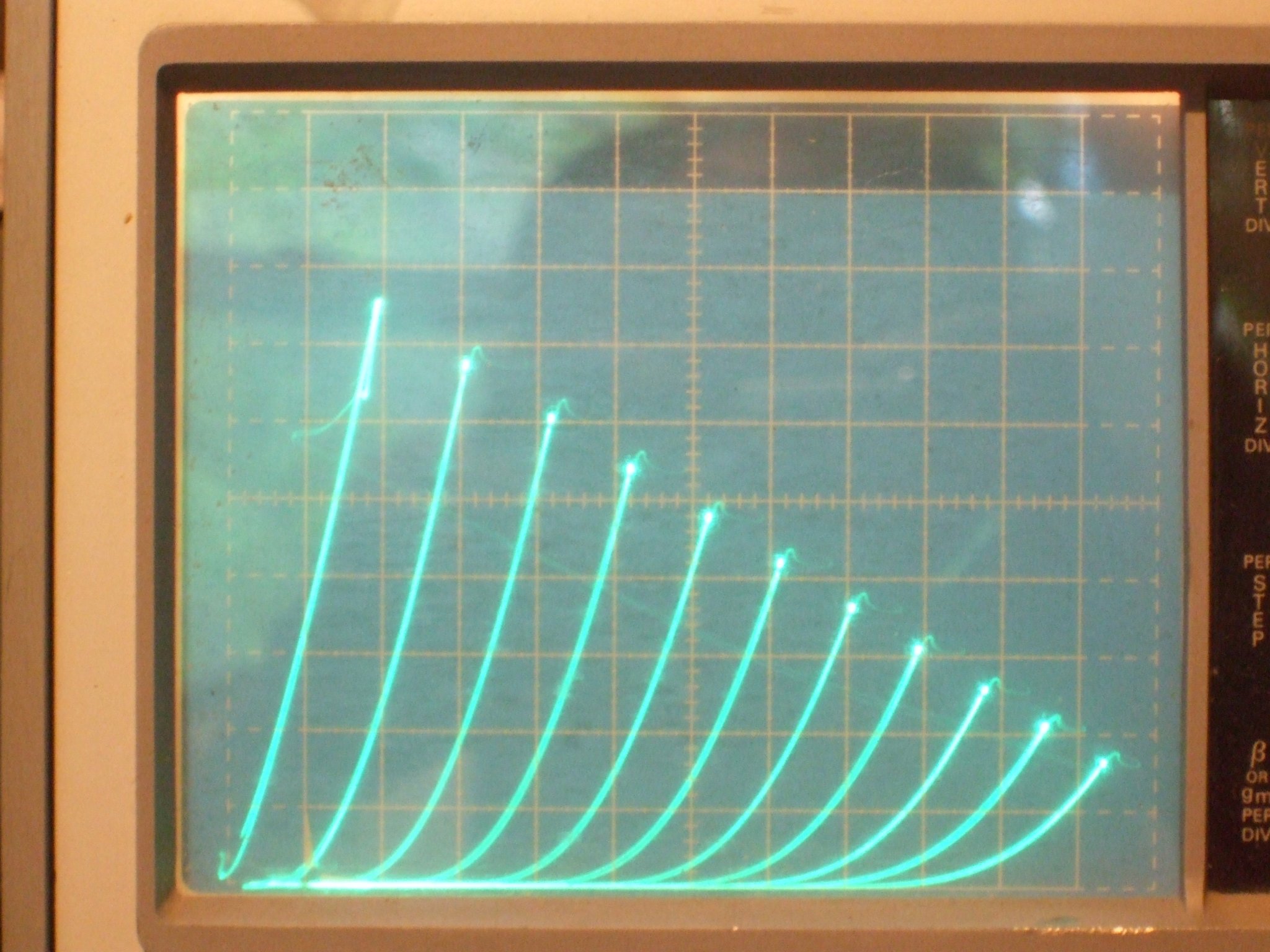

I curve traced an RCA 12BY7A here to see what the triode curves look like. 50V/div horizontal, 5 mA/div vertical, 2 V steps
Some obvious "rollover" in the triode curves toward the HV end, that will have some 2nd harmonic. Not a super triode, but a typical triode.
I don't think I have a 6EJ7/EF184 here to trace. Maybe I can find a cheap one on Epray. One thing I noticed on the EF184 datasheet is that it has a high plate saturation voltage in pentode mode, like 125V. This will limit the output swing some, but not sure if that would be modeled in the Spice model.

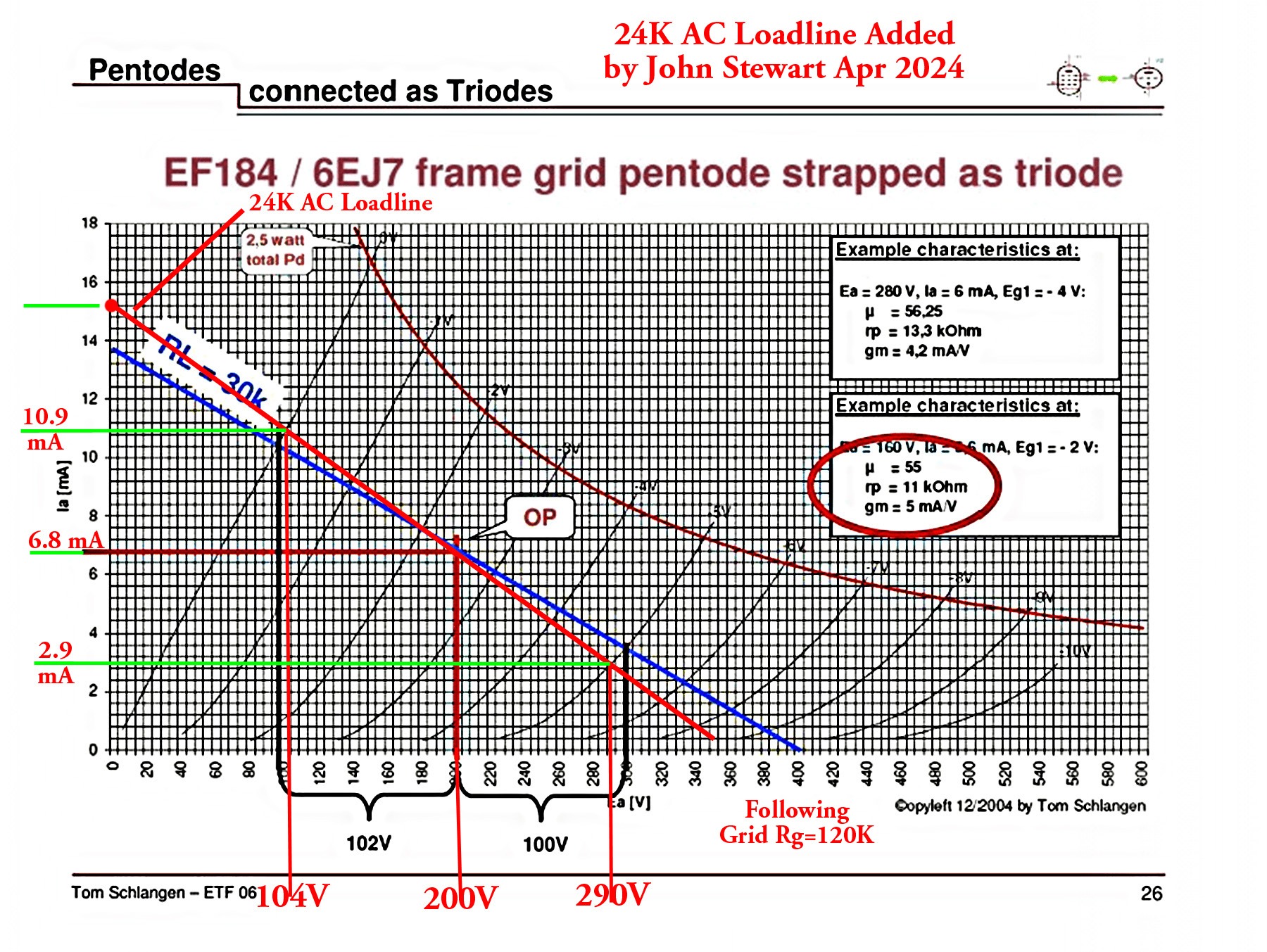

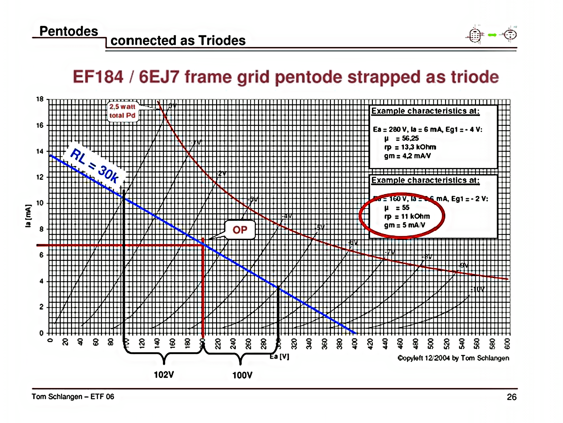

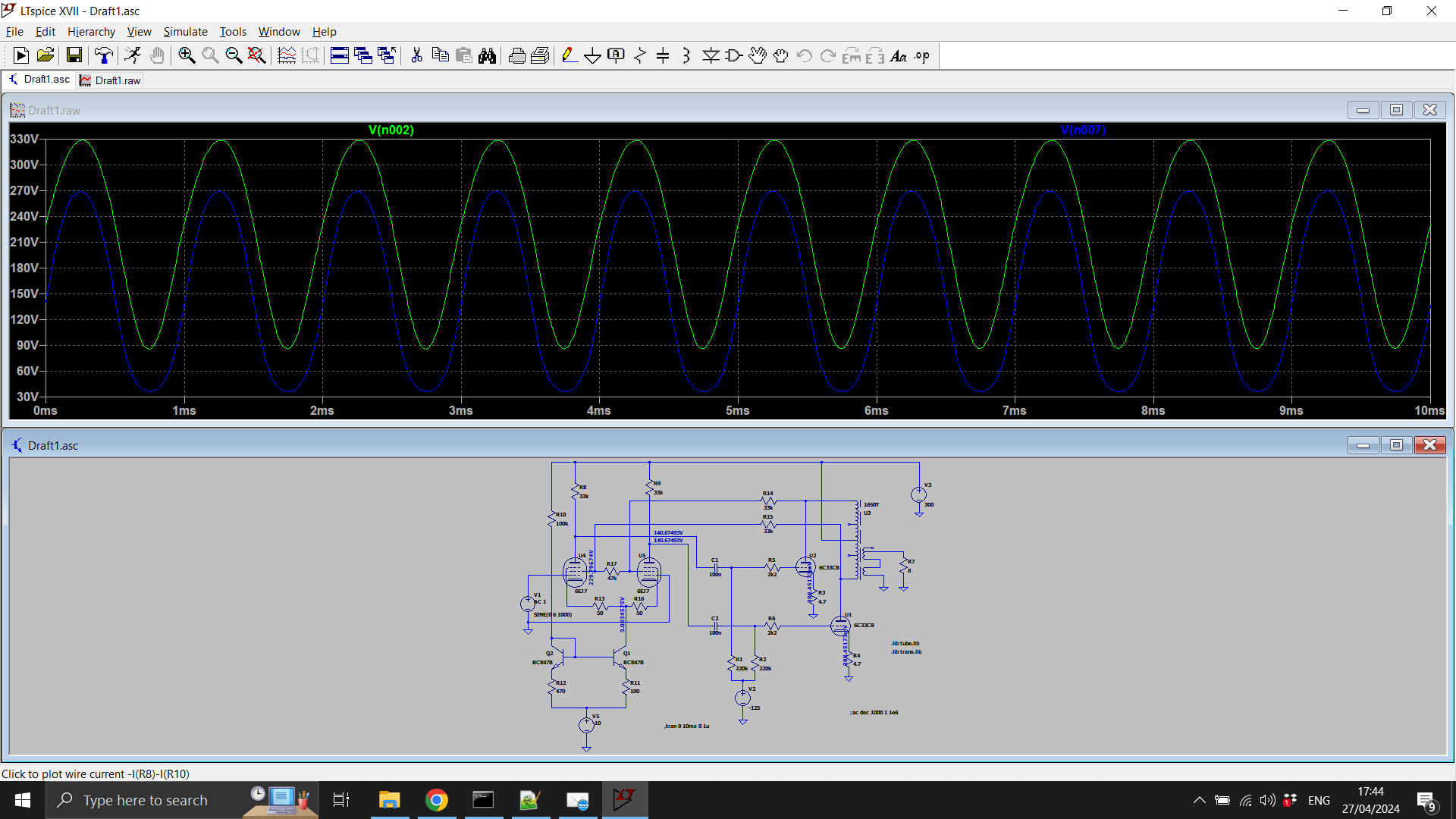

Here is Tom Shlangen's 6EJ7 Triode 30K Loadline adjusted for reality.
In this case driving a120K Rg on the following grid. So 24K load results.
Not as much swing as before & the RHS loses more than the LHS.
That results in increased 2H, altho in this example still looks OK.
220K on the 6C33s grids seems far to high on a tube with a very large grid structure.
I'm thinking 50K max. What do the spec sheets tell us? Perhaps not much.
The 6C33s look like a PS passer tube. In that service not a problem.

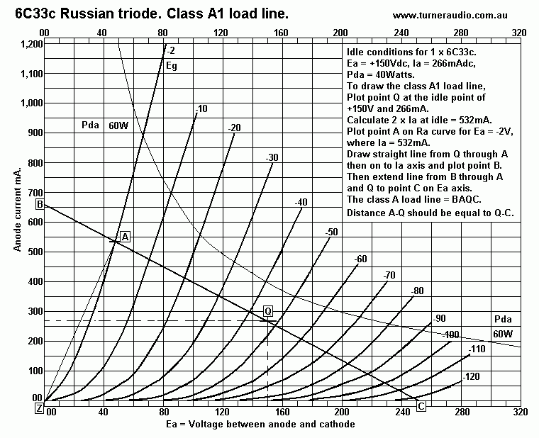

On Patrick Turners plot of the 6C33 Plate Family it looks as though its mu is ~2.5.
Low mu tubes on fixed bias are always in danger of self destruction, due to current hogging.
I watched many years ago as one of the grids in a 6080 melted.
So have always used some cathode biasing as a safety measure. 👍
Can you expand on this? Do you mean when both sides of the 6080 are paralleled, one side draws much more current than the other?
Here is some useful guidance when using low mu triodes in parallel.Can you expand on this?
In regulated PS passer service it is recommended to use resisters in each cathode in order to force current sharing.
The resister in the cathode is (mu + 1) times as effective compared to in the plate side.
The App Note from 1948 tells us paralleled SE operation is not recommended.

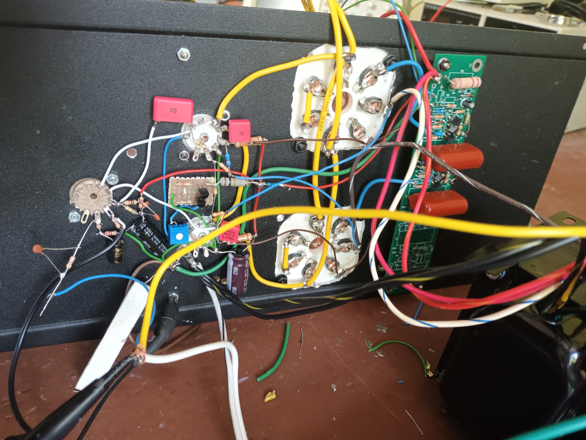

Sorry for the delay.

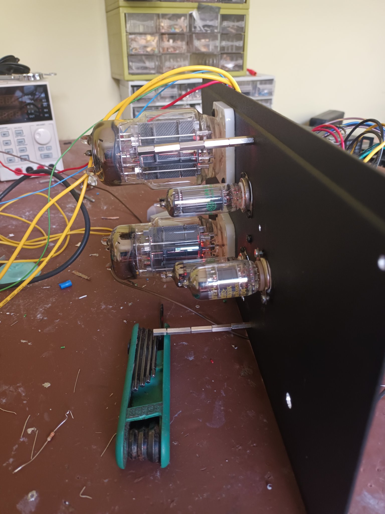

I got some bits and lashed something together just to see. I dropped the bootstrap resistors a bit and applied some GNFB. Matched pretty much simulation. The tubes are running at 70ma each. Power comes in at 90W @ 300V HT, and distortion is about .25% at 30W or so but this needs measuring more carefully. The output damping is much better than a UL-pentode output stage. The OPT is a 1650M with using the 800CT winding. It may saturate at 30Hz I need to check. Such low ratio transformers are more difficult to find.
All in all good result. The plan is to do a proper (stereo) unit the Autumn. I try and take some scope shots in the next few days. the 6C33 is visually quite the beast and puts on a good display. Thanks for the suggestion for the driver pentode JAN 6197-6CL6.
Certainly an interesting alternative to the 6550 amps I've built.

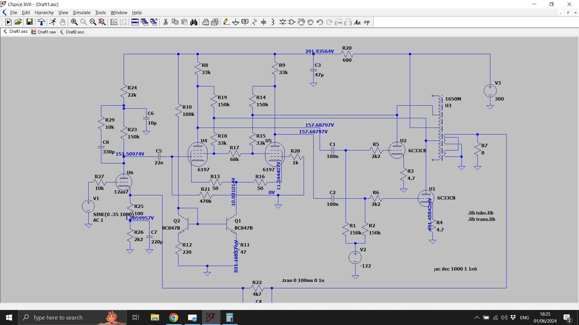

That is a very nice schematic on Post # 37.
Congratulations!
This is Not an Ultra Linear amplifier.
What I do see is:
1. Output Tube Plates connected to what could be considered 75.6% UL taps, in order to get a low load impedance for the 6C33 tubes.
Hammond does not list the transformer as a UL transformer, it is listed as multiple impedance.
But I calculated the UL Tap percentage just for the convenience of those who want to use it like a UL transformer.
2. Bootstrapping from the output tube plates to the driver tube plates, And to the driver grids, with a shunt resistor between the driver grids.
Positive feedback to the driver plate, and Negative feedback to the driver grid.

Distortion @ 1KHz.
With 20V ppk into 8R dummy load (6W rms).
R17 = 0R (no local FB), no GNFB: 2nd -44 dB, 3rd -33dB (very high)
R17 = 68k no GNFB: 2nd -46dB 3rd -44dB (12dB gain reduction)
R17 = 68K, GNFB = 4k7: 2nd >-60dB, 3rd could not measure (23dB gain reduction).
Tried second set of 6c33 but one is coming in at -140V for 80ma, should be -125V so will get replacement.
