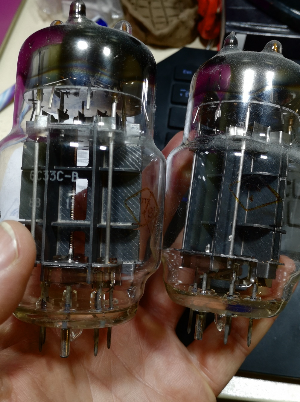

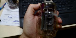

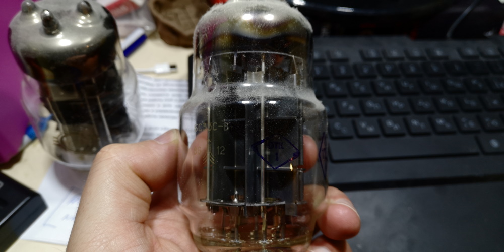

1st one nos tube out of box - on the right you can see square with manufacturing date - 11. 1969
2nd- 3 year used ones - as different manufacture.

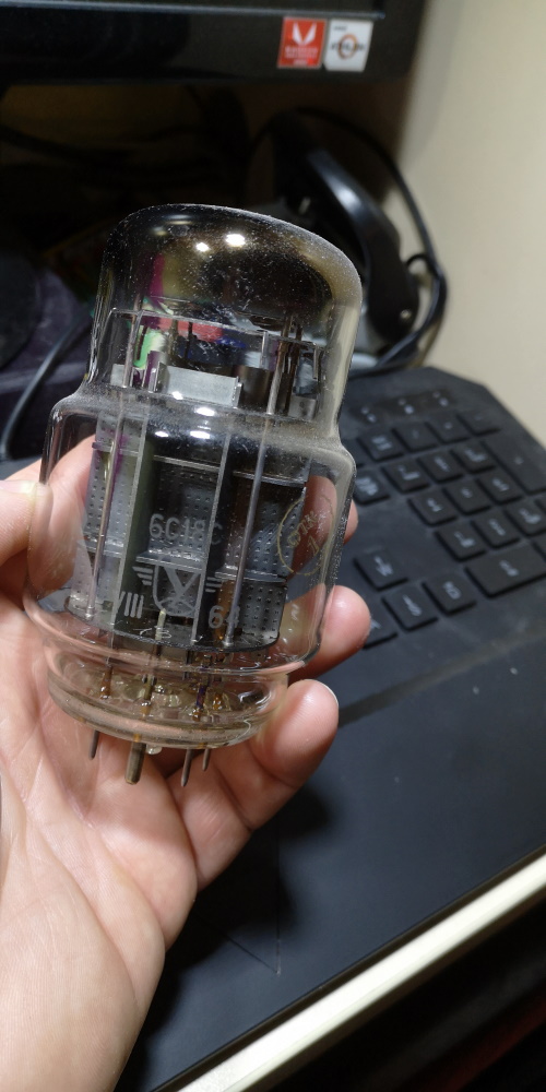

3rd - dusty nos from original paper box - 88 year , as above manufacture .
it is the same manufacture, Ulyanov, they changed their logo at some point.
ok, thank you for clarification - they seems to be have somewhat longer studs or frog eyes on top.

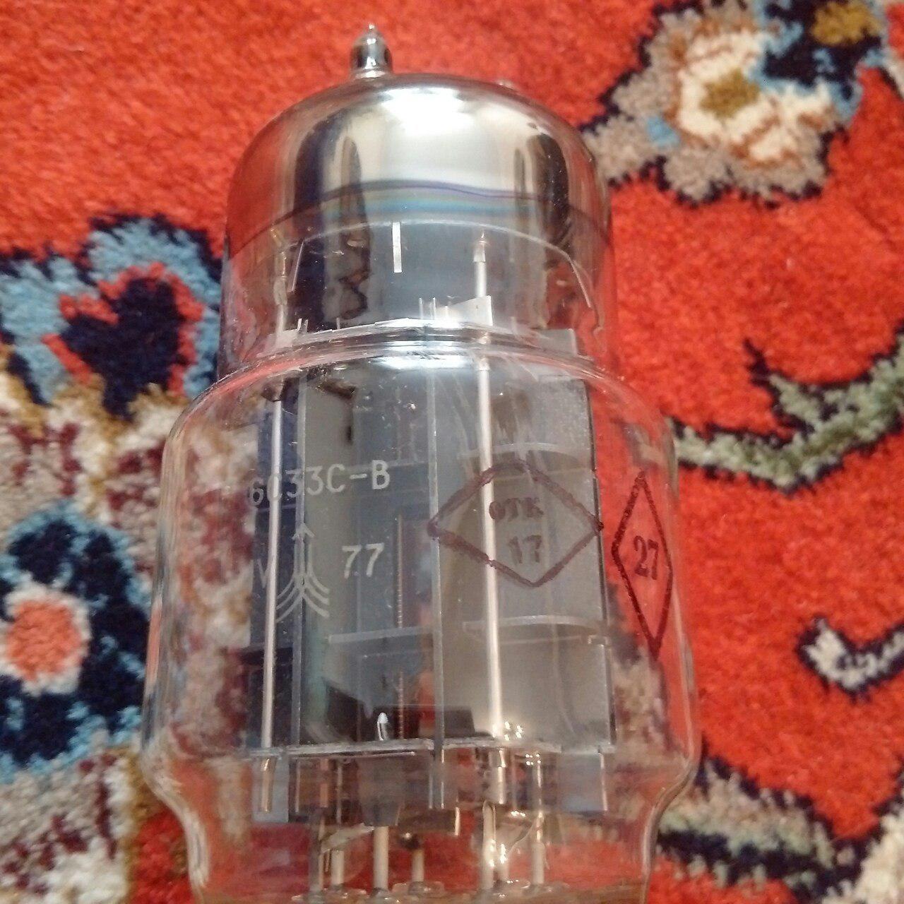

the otk label was clearly purple when i bought the tube,and then after being used it get black

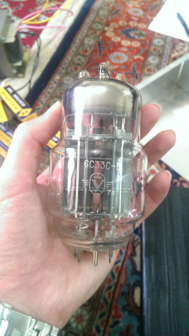

i tested these tubes
but none of them had the manufacture date like your tube!

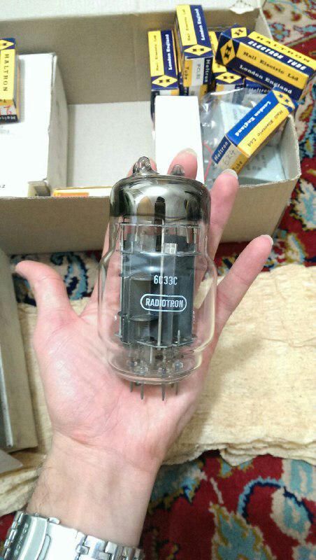

these radiotron seems something of newer production/rebranding...
with old logo i have only these without "ears":
yes
radiotron rebranded,just a logo,no maufacture date and otk label...

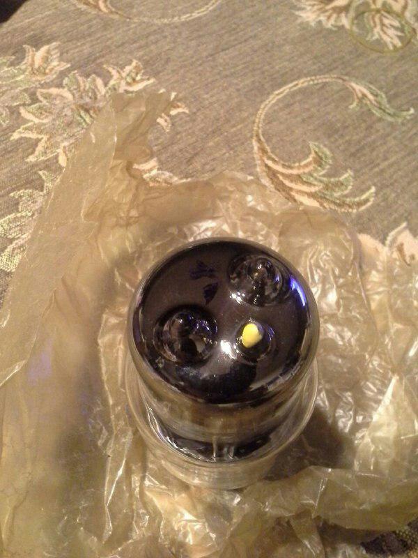

actually i saw a version that i think it was rare and hard to find
it has a point of yellow lac on the top,and after being used it become dark red

Maybe so but clearly the first tube was manufacured 1977
