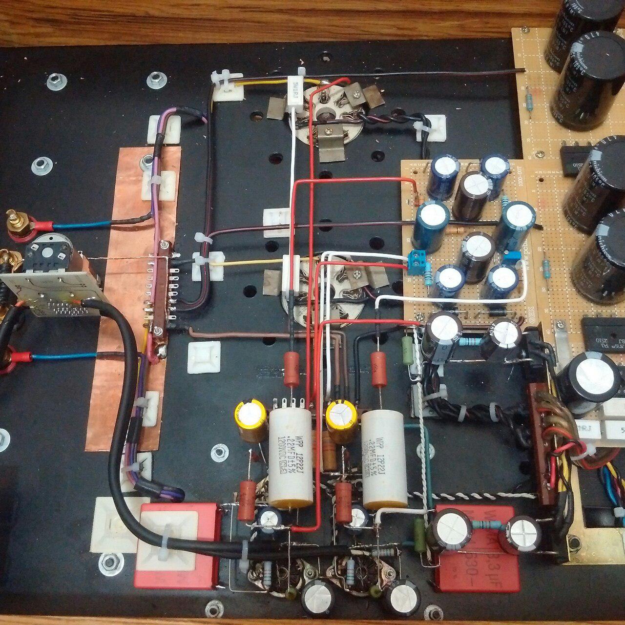

actually I built a 6c33set and it complited about a month ago
i'm so happy,the results were satisfying and very nice
the bias point of 6c33 was 🙁plate voltage:200, current:200mA and grid voltage about -72)
of course 12ax7 srpp for input and pre stage and 12bh7 for driver
but now worry obout the operation point😕
opt primary impedance about 600 ohm and Ei96 core

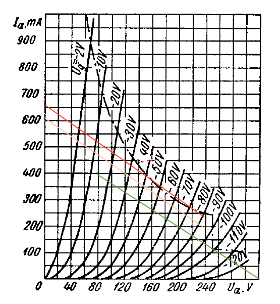

I've only built one amp with this tube so am no expert but by looking at the data sheets you are well above their specified normal Vp but well under their specified Ip and at only 2/3 their max power dissipation. I'd say you don't need to worry.
Data sheet curves with your 600Ω load line.
Green centred at your given operating point. Red centred at the data sheet specified nominal, and Orange is betwixt the two.

i've ploted some parallel load line (600 ohm) before biasing

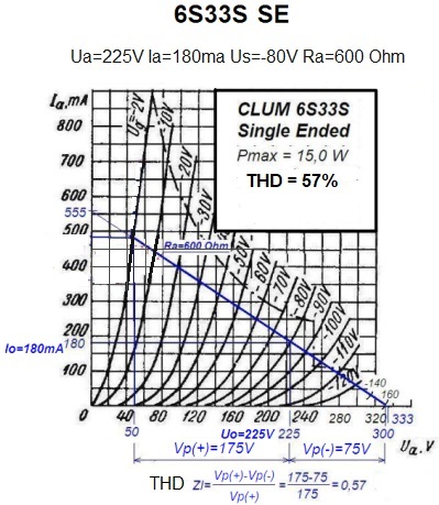

my exact problem was that grid biased on -70
it means that it swings between -70 to zero for positive cycle
and -70 to -140 for negative cycle
but someone said that this tube is not suiatable for this amount of negative swing on its grid(-140)
and this couse that the tube drop in distortion (exactly the cut-off distortion,sth like cut-off clipping but not clipping)
and this confused me😕

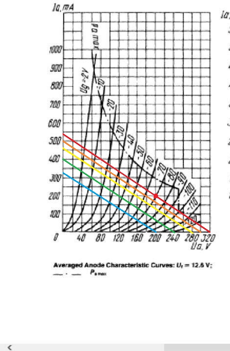

seems that right now i realize that why in many refrences emphasis that its better to bias your tube around center of your load line
i think that i can bias my triode on every point of load line,but the output distortion vary too much
but the main question is that where is the optimum or good point for biasing a power triode????

i attach some pics for u

............where is the optimum or good point for biasing a power triode???? 😕
As Hot As Possible. This gives good power and distortion.
If you have to ride a dog-sled across the Arctic to change a tube, then Reliability may be as important as output or quality. Radar stations on the snow fields may de-rate to 75% of commercial "Max" specs for less stress and longer life.
I think all your plots "work". If the lower power bias won't fill your room, a hotter bias is not much better; you need a bigger amp.

i'm not an Elec eng or technician,i'm mechanic eng but i love the world of tubes
built 3 tube amps,u can see the last one pic in preveous page
