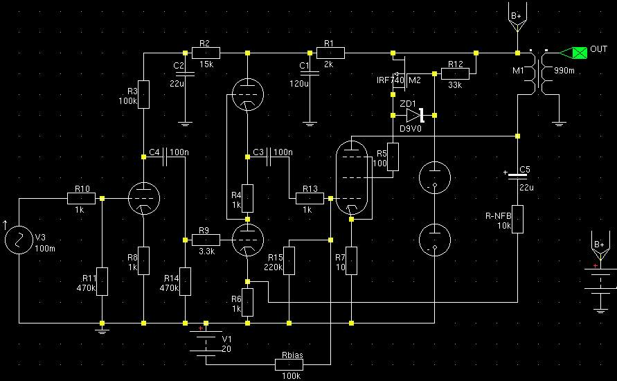

What I did to make it this way was to use an SRPP driver into a GU50 pentode output, and then wrap masses of feedback from the GU50 anode back to the SRPP cathode resistor. If you don't have enough the bass is a bit floppy, so you need loads 😉. This presents a very low impedance drive to the OPT, without the traditional stability issues of GNFB. There is no global feedback.
This idea was based on a thread here by Kuei Yang Wang (Thorsten Loesch) about partial feedback and works a treat 🙂
SCHEMATIC please 😀My SE sounds just fine with AC/DC, Rolling Stones, Dire Straits, Pink Floyd, Black Eyed Peas, Megadeth etc!! It's also silky smooth and subtle with Katie Melua, Sheryl Crow, Norah Jones and classical pieces.

There you go!
Input tube is Bugleboy ECC88, SRPP is 6N2P-EV, Pentodes are GU50, B+ voltage is about 430VDC, bias 45-50mA, screen at 250V.
Electros are bypassed with polys, interstage caps are russian PIOs bypassed by silver mica.

Just the ones that came with the Sweet Peach FU50 amp - for this is a re-working of that:
Sweet Peach-FU50 Tube Amplifier [Sweet Peach-FU50] - $310.00 : DAC,Audio Amplifier,Hifi Amplifier,Tube Amplifier,Hlly Audio, Hlly Electronics
It starts off life with a mundane 6N3/6N1 front end driving a triode strapped FU50, so I put a new top plate on for the VR tubes and others, and built it point to point to my new design.
I did try a few different topologies for driving the GU50, but the only one that really lit it up was the SRPP, and the nicest/liveliest sound was from the 6N2p. What I wanted from the driver was a big voltage swing (The pentode bias is about -70V) and the ability to drive. Then I wanted a large gain of 6N2p SRPP + Pentode GU50, so I could wrap a very tight feedback on it.
A possible mod is to load the SRPP stage to it's ideal impedance - to reduce distortion, but it's good enough as it is for me, I haven't felt the need to mod it further. You can do this because it is driving a pentode, not a triode so there should not be too much load there to drive bar the capacitance.. which is sort of what SRPP was designed to drive IIRC.
This leaves the input tube wich must be protected against PSRipple and has no feedback, so it's very 'rollable' and tweakable. I ended up on an ECC88.
BTW the top SRPP triodes are in the same envelope off a separate 6V transformer - a small potted one I picked up for about £10, so cathode/heater voltages are safe even when the SRPP is pumping a big signal.

Can you take a look at my schematic: http://audioproject.net/pdf/15wse.pdf.

I reckon so, but it would be quite a different schematic!
Which of the schematics in your link is the favourite?
TBH I'm better with concepts than implementations so I'm sure there is room for improvement in my schematic. Eliminating the coupling capacitors by using different/multiple power rails would be one idea. A shunt regulated supply another.. I'm listening however to 'Lilac Wine' sung by Katie Melua and the dynamics and fluid sound is very fine!
My philosophy would be to up the overall gain, disconnect the global feedback and stuff it into the driver tube via a big high voltage (poly/elec-poly bypassed) capacitor - but you knew that already 😉. Schade feedback works in the same way of course - giving a nice low impedance drive to the OPT. Schade with an SRPP driver would be interesting - you'd need a resistor network to load the SRPP and decouple/convert the output to the next stage so the schade FB could actually work and not fight the low impedance drive.
My view (after my experimentation) is that Thorsten was right: The OPT should not be in the feedback loop, and that lowering the driving impedance is the best/better way to get the most out of a given OPT. In my case it gives an apparently cheap and feeble SE the guts of quite a pokey beast!! Of course it's helped by using the superb GU50, a tube of remarkable quality.
In my experience you can play about quite a bit with tubes, operating points, load lines etc and they all behave well. The only issue I ever had (not an issue for your tubes I think) was with VR tubes oscillating, and I could only escape that by buffering it with an IRF730 MOSFET. It was worth it to run the GU50 in pure pentode mode though 🙂
Your schematic has been cathegorised as "SMART" by the man who build my OPT's. And he knows a few things 😛.
