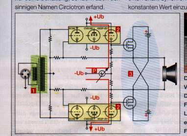

Hello!
I got the magazine and here is the block diagram. Driver stage is EC86, CV6189, and 6S3P-EV in series, no circlotron. No coupling capacitor is used in the whole circuit. The transistor type of the circlotron power stage is not mentioned, just that they are identical.
Greets, Oliver

Some news for the circlotron fans: The new circlotron power amp from Thorens (valve circlotron driver stage, transistor circlotron driver stage) is the new reference of the German Stereoplay magazine.
That amp is basicly a rip of of my amp i posted 2 years ago here on these forums.
The idea to use a ECC86 as a input device is not new. I hade that idea 3 years ago but I have not had the time to build it.
See post 49 in this thread.
