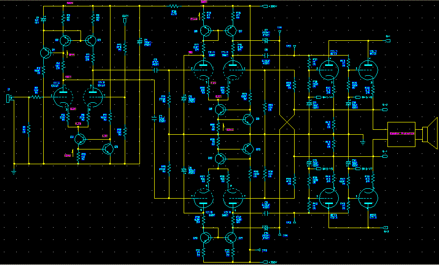

I don't have a version of mu circuit diagram that I can post yet, only handwritten.
As you may remember I don't use a circlotron but an inverted Futterman circuit.
Basically I use the same circuit as I have on my WEB site here http://www.tubetvr.com/otl.html that is used in my earlier amp but I have introduced cathode followers to drive the output tubes , the cathode followers are DC coupled to the output tubes. So it is a very simple circuit but with good performance, distortion is 0.03% at 1W and 0.3% at 1dB below clipping, (clipping defined as the point of 1% distortion), I use higher feedback than you, around 20dB
Regards Hans

I have now posted a schematic diagram of my high power OTL here http://www.tubetvr.com/otl.html (bottom of page) together with some measurement results.
Regards Hans

Dear Hans,
Thanks for your information. You have owned a nice website.
Seems the output state is not works as a cathode follower, isn't it?
Regards
Patrick
Regards
Patrick
Yes, it does due to the feedback from the output to the cathode resistor of the phase splitter, this was what Futterman invented even though he made a mistake. Futterman thought that due to the feedback both output tubes should function as cathode followers but actually with the original Futterman circuit both output tubes work as ordinary cathode grounded stages, by shifting the drive signals to both output tubes this is corrected and both tubes work as cathode followers giving the lowest possible output impedance for 2 tubes.
That both tubes give equal signals and that the circuit is balanced is evident from the amount of 2nd order distortion which is as low as 55dB below max output power without any feedback, this is as good, (or better?) as can be achieved by any other OTL circuit including the circlotron.
Regards Hans
