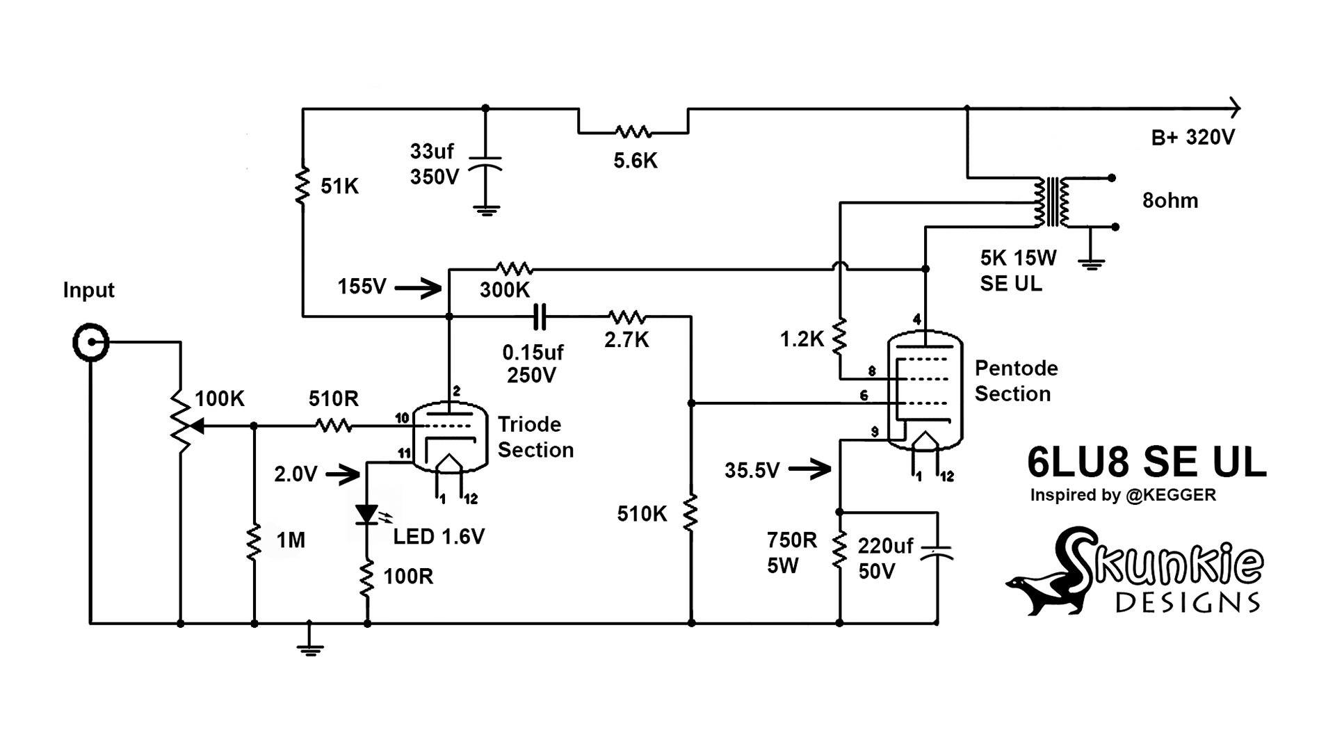

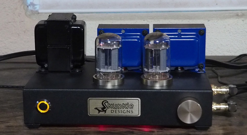

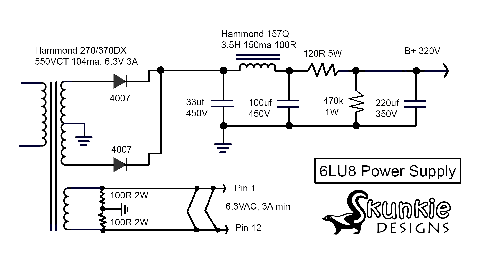

If you want more power from a "spud" amp, try this 6LU8, a Kegger inspired unit I also built. With the 15W GXSE Edor iron, this amp performs very close to what an EL34 amp would do.
https://www.skunkiedesigns.com/6lu8

I built the 6LU8, it is very good. It is my main music listening system. They drive my 89db sensitive speakers to quite good listening level in my 16x19 media room..
