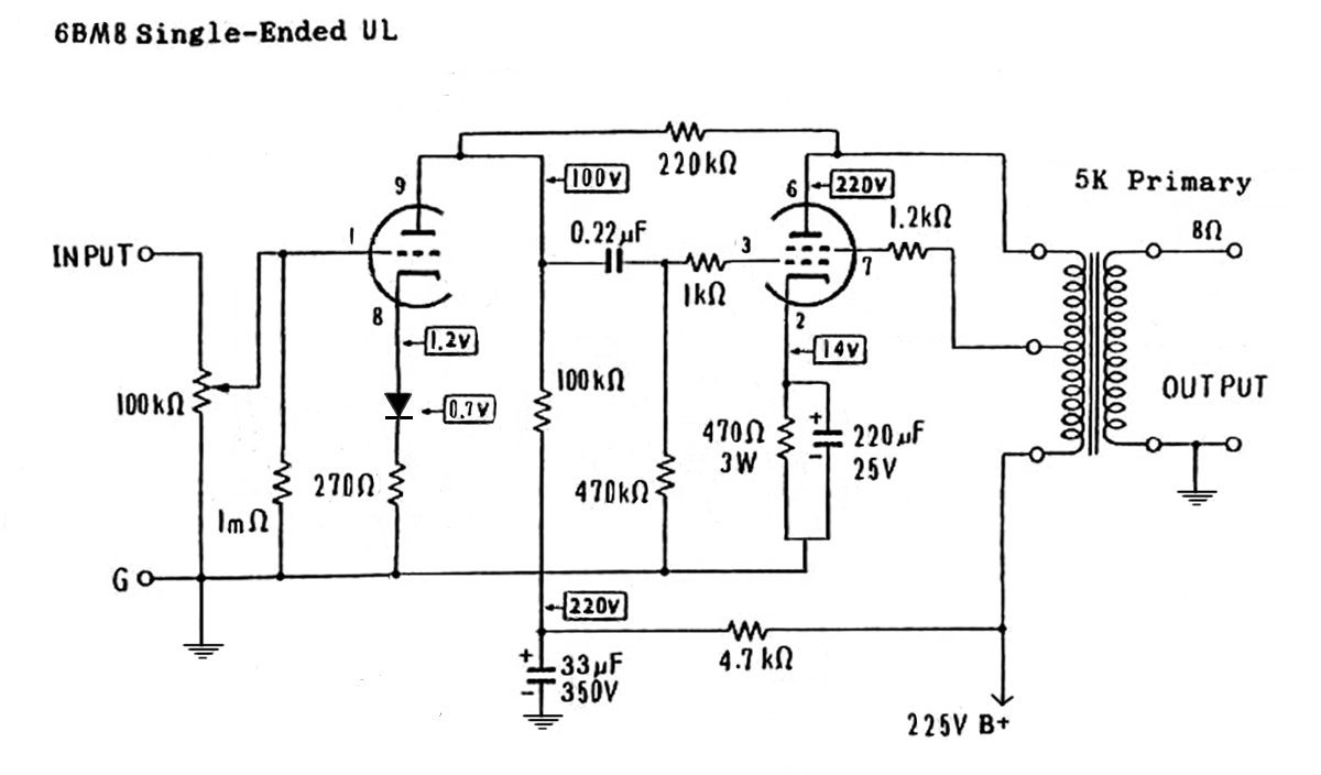

Just gonna say when I was building my 6BM8 amp, the LTspice crowd found all sorts of "This isn't going to work" things, and said I was using the wrong OT etc. It' works great, and more important sounds good. Testing with various impedance OT, the 5K one gave the best overall performance. What all these computer simulations don't do is show you what a design will sound like playing music.

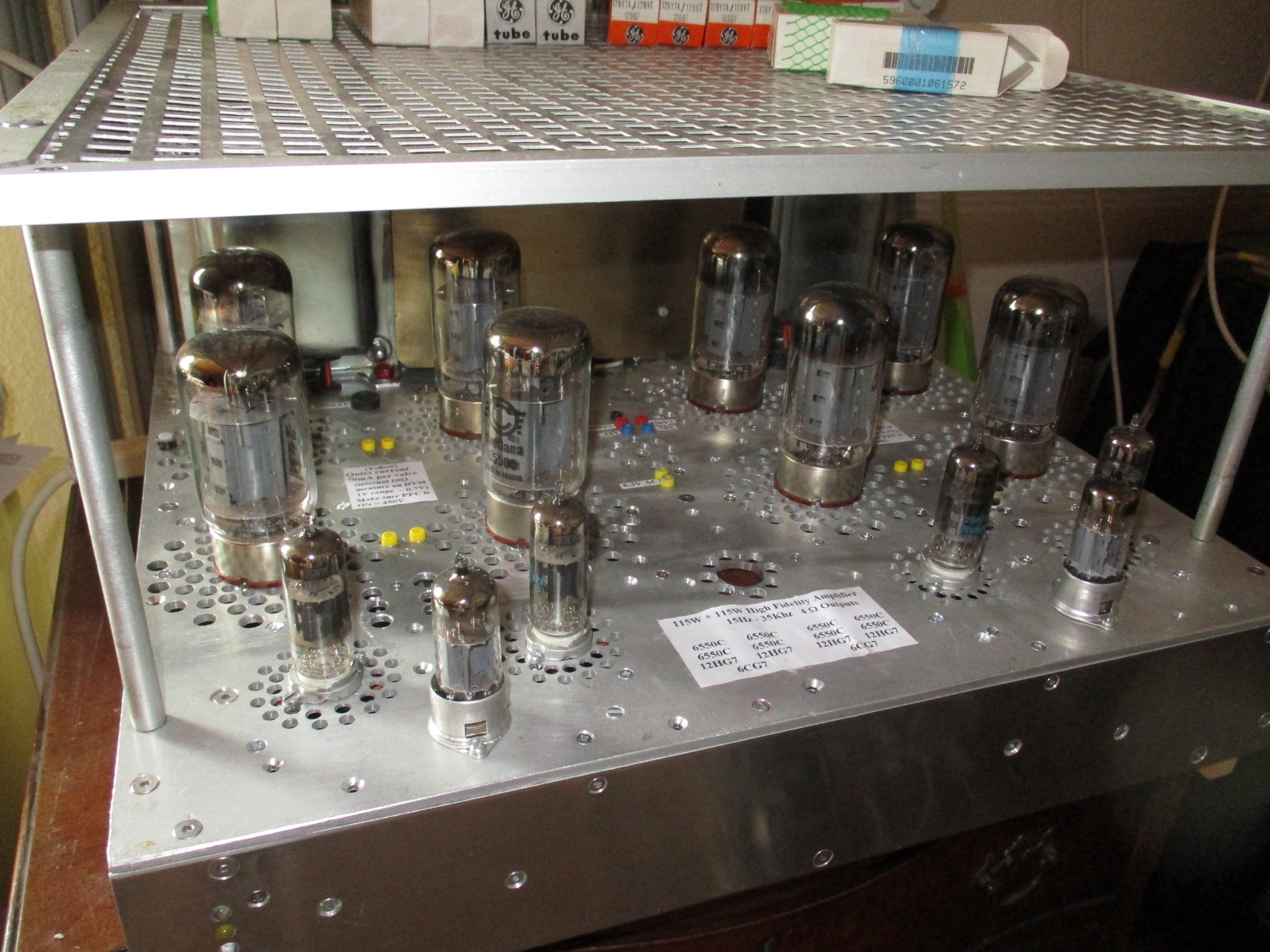

Good man.......there is nothing wrong using SMPS but there are knowledge caveats. I´ve been doing this for 60 yrs. The original 2x250W UL amp using KT90´s derated in pic to 2x115W using 6550C´s has a hard switched converter and there is no noise or hash, so long one understands the pecularities of RF. The superb characteristics of the power supply and using a fairly strung driver stage can sound the amp somewhat strident, but since one´s hearing response curtails with age, the definition is excellent.I have absolutely no problems with SMPS in a tube context. Properly shielded, they deliver the goods. As I've been designing SMPS for a living for over 40 years, I know whereof I speak.

Well the 1 milliohm load resistor on the input grid might be one of the things! Presume that's a misprint for megaohm (M)? It reminds me of a gotcha with Spice, in that it treats 'm' or 'M' as milli, you have to say 'meg' or 'Meg' for mega, can lead to very broken simulations if you fail to notice this...Just gonna say when I was building my 6BM8 amp, the LTspice crowd found all sorts of "This isn't going to work" things, and said I was using the wrong OT etc. It' works great, and more important sounds good.
Yeah - my PSpice installation has a problem with "M" in any form, so instead I feed it 1000k, 10000k, whatever..

Well, I am going to try the 1.6 mA LND150 parts first and see how they fare - again, I'll be measuring, but with a gain-phase analyzer, with the twin goals of sorting out both the compensation and Zobel values. What works for you may not necessarily work for me, as the triode half of the Soviet 6BM8 is kinda anemic.

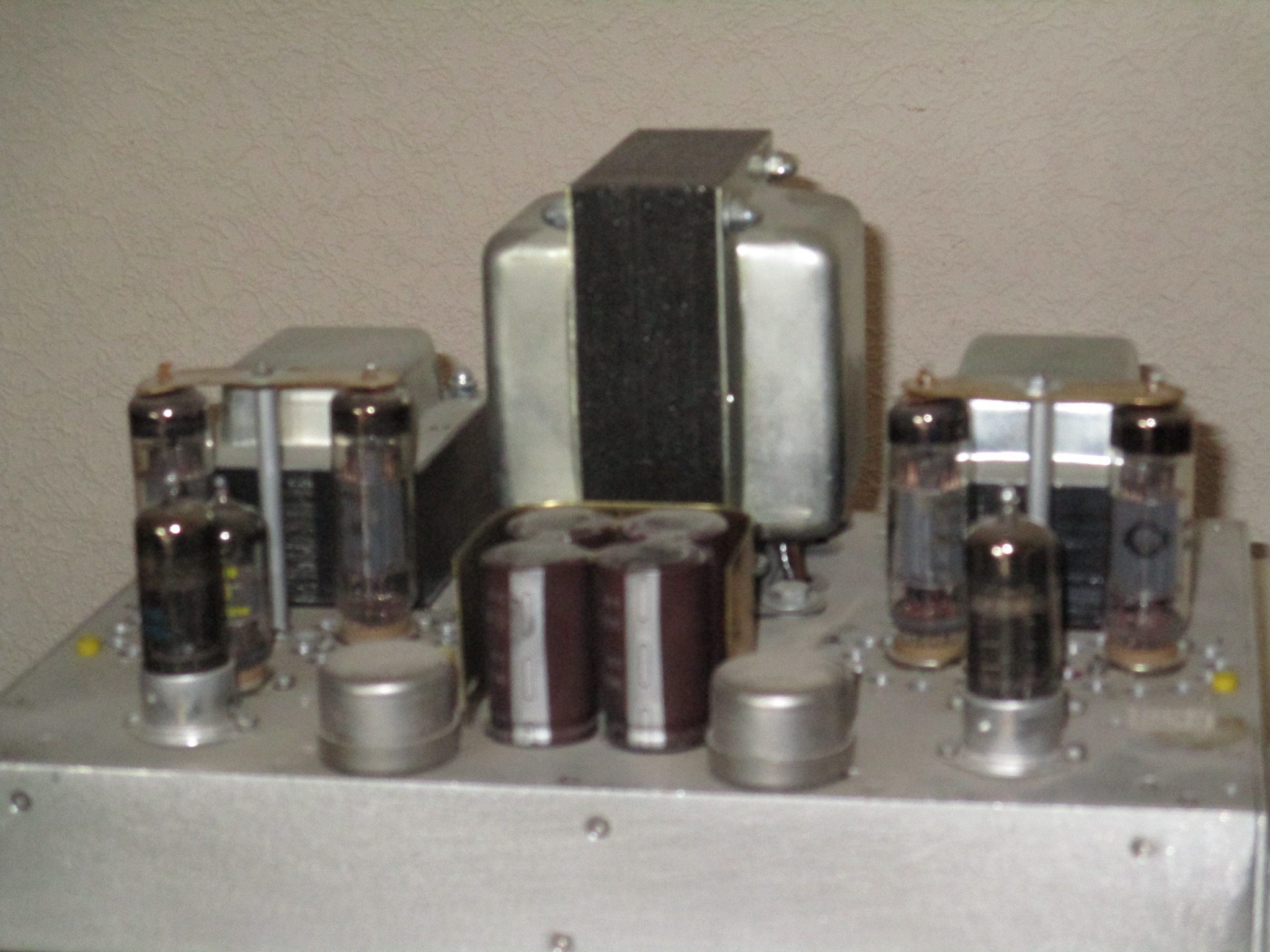

I found the same, the triode sections rather a disappointing performer when it comes to distortion. I spent much mettle on it, perhaps too much that in the end I changed the whole circuit to fixed bias operation resulting in a 9W+ 9W amp for 275V B+. It is capable of more. I abandoned the triode section and instead used an ECC88 as a cathodyne for a much better distortion performance that shows 0.05% at 9W for 20dB global nfb. It is an excellent sounder. The original o/p transformer used 20% UL taps whereas I got Sowter transformers now 40 years ago to provide 40% taps.as the triode half of the Soviet 6BM8 is kinda anemic.
The original 7W Mullard article which used the triode sections as a paraphase phasesplitter quotes less than 0.5% thd with 21dB global nfb. Naturally, one has to bear in mind the sales attractiveness that the original circuit was crammed into the smallest record player space that was common in the 1960´s designs.
I really ought to get alot of my earlier literature and designs stuck in ledgers from the late 1950 era tidied up and published.
The pic shows a pentode also in a first stage for MI as well as balanced input transformers.
Over the decades, by comparion to my other power behemoths that I designed, I can thoroughly recommend this easy small amp for HiFi with flexibility in either fixed or auto bias. It will astound many criticical listeners.
