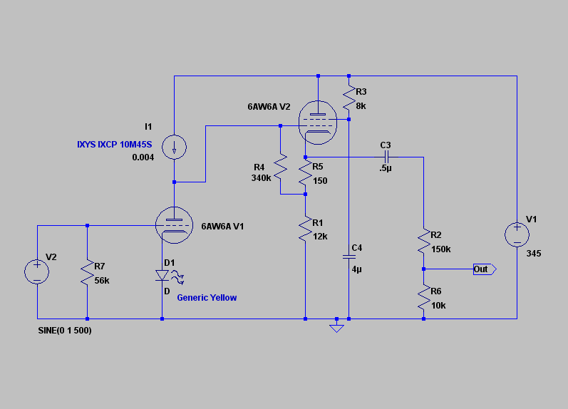

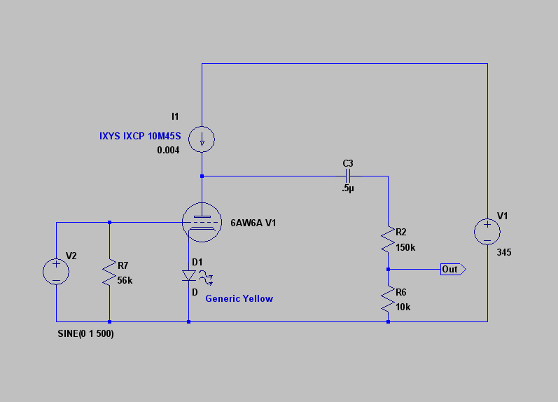

The 6AW6A – a single envelope high mu triode/pentode – met all the criteria. The experiment was simple. First, measure the triode half CCS-loaded and driving a resistor typical of a following stage's grid, in this case 160k ohm. The second half entailed buffering the triode's output with a cathode follower. In effect the triode is almost completely unloaded in the second.
The first circuit was:

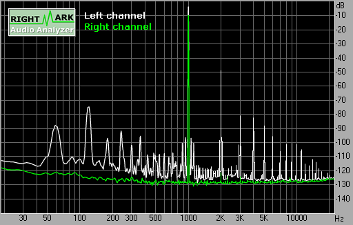

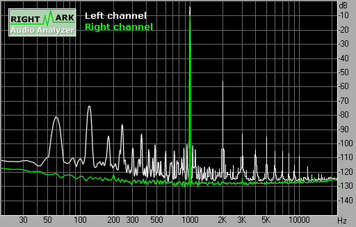

The 6AW6A's dirty harmonic profile made it a perfect candidate for the task. The results were surprising, at least to me. 160K would seem an easy load yet the CF cut the second harmonic almost to a third and slashed the upper harmonics in some cases by 15 dB. RightMark gives 0.18% THD and more incredibly under 0.2% IMD for the second case, even with the obviously dirty supply (a Titan Plus medical supply.)
A couple more observations, I spent a fair amount of time trying different cathode loads and operating points on the base CCS triode looking for the cleanest harmonic profile. The cathode follower however was a quick calc with no optimization. The design numbers targeted a 325 Vdc B+, however it was necessary to raise it to 345 to gain sufficient headroom. The second harmonic level wasn't much affected by the change but a upper ones saw a drastic reduction. A raw THD meter wouldn't have caught the difference but I'll lay odds an ear would have no problem. It's a possible clue to some of the bad reputation of CFs, without listening it's impossible to say.
Since this tube doesn't hold much promise I don't intend to spend much, if any, more time on it. I'm really interested however in examining further the split between voltage gain and current drive at an amp's front end. Next stop: a 6C45-pe followed by a either the same as a CF or a big output pentode as possible 813 front ends.
I bet it would've worked even better if the second half had actually been a pentode cathode follower. You needed to return the screen bypass capacitor to the cathode instead of connecting it to AC ground. What counts is the screen-to-cathode voltage. By not connecting it to the cathode, the screen voltage will actually vary even if the screen DC voltage-to-ground does not. The way it's set up, the pentode actually operates more like a triode since it's effectively a screen driven circuit.

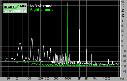

Thanks all! Miles, I understand your reasoning but not why it's 'more pentode'. From Kimmel's paper you're right and I obviously have some remedial reading to do. Following up on your suggestion, with the 8k ohm screen resistor the harmonic profile showed a nulled second harmonic and a wack of 3rd through ~ 7th, in my experience the signature of second harmonic cancellation. Sure enough, with the output superimposed on the screen it was being driven above/into the plate. Increasing the screen resistor to 33k ohm and raising the B+ ~350 to compensate did the trick. The distortion spectrum is shown below for the same operating conditions.
If I was a vague earlier the design of the original CF was rough at best - a few quick numbers and a minute with the plate curves - and the choice of tube literally random. It was intended as a proof-of-concept to determine how much even the slight current of driving ~150k ohm affected upper harmonics. As it was the original 'semi-pentode' appears to have been close enough. The new circuit changed little. THD is now 0.25% instead of 0.18%, suggesting the CF of the first circuit had slightly higher 2nd harmonic and a touch of cancellation occured. I'm certain a properly calculated design would likely yield better results. Next step is learning how to do just that.

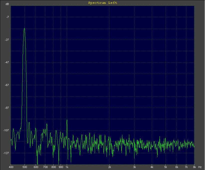

One more for fun. In the distortion spectra below an IR LED became the triode section's cathode load, the current through the CF lowered to about 7 ma, a small film cap went interstage (with these operating points the two stage voltages don't match) and the level changed to reflect use as a pre-amp, about 12 V p-p. Massive overkill for the application. A single second harmonic is visible above the noise at about 80 dB down, respectible for a no-GNFB, single tube, relatively low output impedance stage. I might have to tune the CF for direct coupling and look at building this one, even if I don't need a pre.

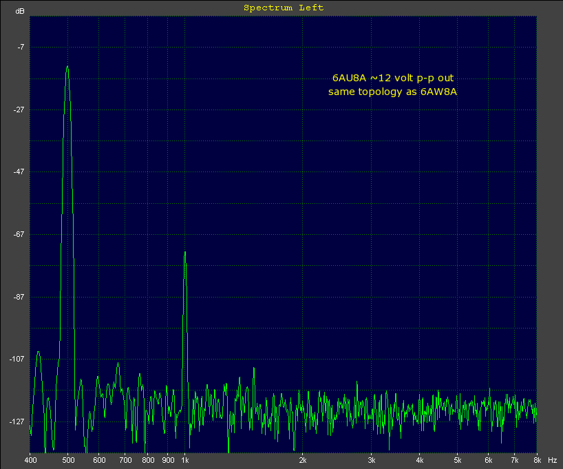

Thanks for the idea, I discovered a pile of 6AU8A in my stock. Same pinout, trades higher triode power handling for lower pentode. Time to warm up the jig.
And there it is. another quick design hack, another single-tube two-stage doing ~ 0.1% near pure second harmonic at 12 volts p-p output. This time the 6AU8A. Very promising topology.
