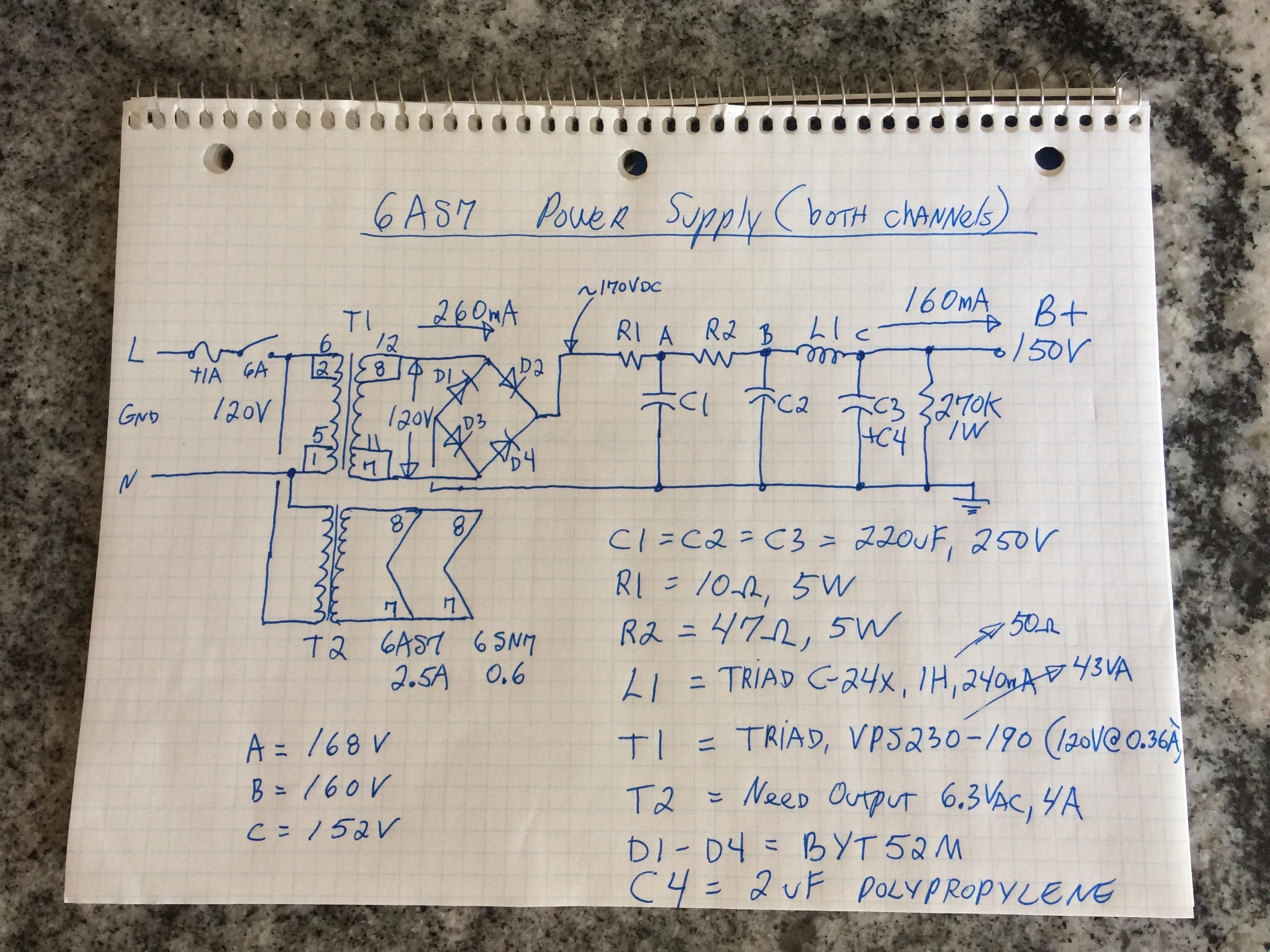

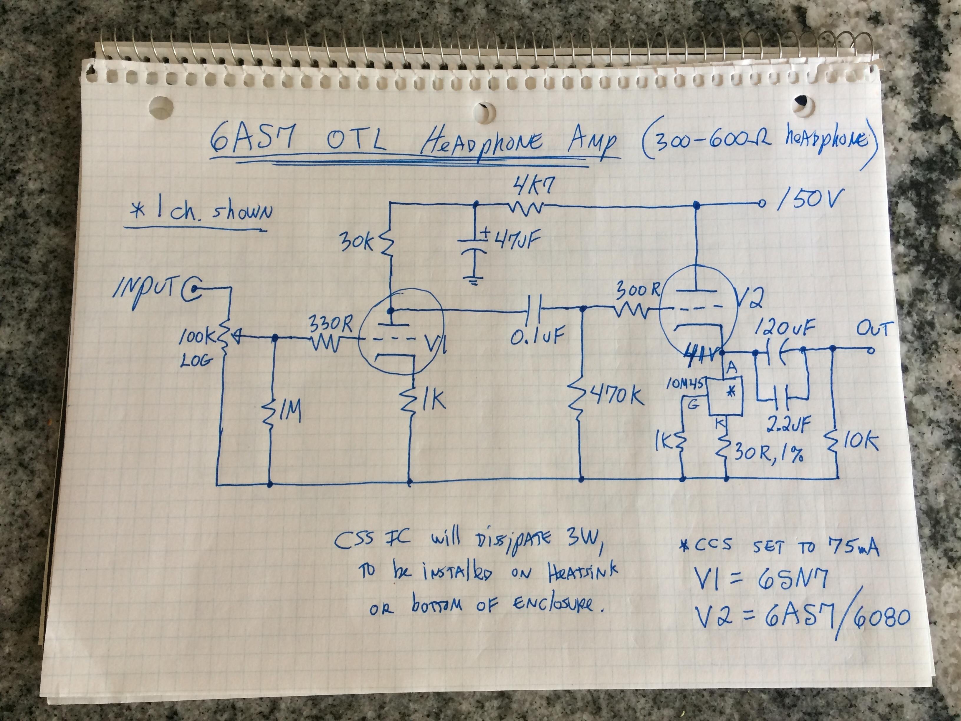

Hi
Attached is the latest schematics including the power supply. Nothing fancy but with the choke I’m hoping it’s gonna be dead quiet.
Thanks for your help!

Yeah, I didn't say "I don't like capacitors", it's more a statement of the complaints aired here frequently. OTL circuits aren't typically the place for capacitor-phobia.
Hi
I’ll wait a few more days and if there’s no more comments / changes or further recommendations I’ll start ordering the components.

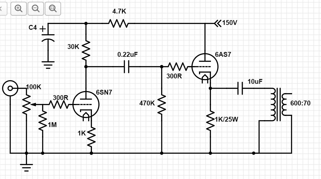

Can the headphone output on this circuit be used as-is for a line level output? So this circuit can serve as either a headphone amp or a pre amp? I wanted to use a switched headphone jack where when you unplug the phones the signal will be routed to RCA jacks on the back, when you plug in the phones those jacks disconnect (or short).
Would I need to attenuate the headphone level down to be a 2v line level with a few resistors?
I think it should be fine as a line amp too, I see no need to attenuate it.

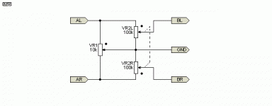

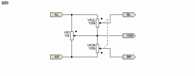

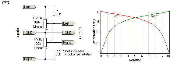

A balance control?
In planning for another headphone amp... In the past I've had bad experiences with head amps without a balance control when the tubes are slightly out of balance. So for this one I do want a balance control. Rod Elliot (Elliot Sound Products) has some great info but which one of these would you implement for this particular project? A simple single linear pot or a dual linear-dual-pot-center-balanced arrangement? I know there will be some loss, but this amp will be used with my DAC so its not like I need a whole lot of gain.
Your preference? Simple or Dual weighted (or something entirely different)?

....A simple single linear pot or a...
That plan does nothing if the source impedance is zero, and near-nothing for low source impedance.
It can make sense in some all-tube systems, but you need to think about it.
