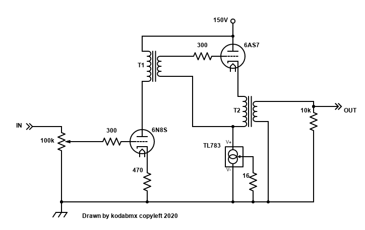

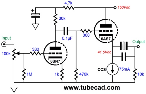

I am in desparite need of some help. I would be very appreciative of anyone who can help me solve a problem with hum.
First, some background. I built the following headphone amp and it works perfectly, no hum.
Nobsound 6N5P+6N11 Vacuum Tube Headphone Amplifier Board DIY KIT Single end Class A Amp|Amplifier| - AliExpress
Next I got more ambitious and built the following headphone amp:
A Single-Ended OTL Amplifier for Dynamic Headphones. – HeadWize Memorial
This headphone is almost identical to the first. The amp part I built is exactly as in the Headwize link. The power supply for the filament is identical to the one from aliexpress. The high voltage power supply is a custom based on a bridge rectifier, followed by 47uf cap, followed by 50 ohm voltage dropping resistor, followed by 330uf cap, followed by 50 ohm voltage dropping resistor followed by 47uf cap. I have separate transformers for both filament and high voltage. The negative of both transformers is connected to circuit ground. The high voltage supply is on a separate board. The filament supply is on the same board, but on the other side of the board. the filament transformer is about 2 inches from the 6AS7.
The problem is that the Headwize amp has a severe hum. The hum is the same no matter what the volume is set to. The hum starts about 30 seconds after power on. If i turn the power off, the music continues to play for a few seconds without any hum. Also, I tried using 4 D batteries for the filament supply and the hum went away.
I have tried everything I can think of to solve this problem with no success, so as I said in the beginning I would greatly appreciate any help I can get. I used high end parts in the Headwize amp, hoping to have a better sound than the aliexpress one.
Just a novice reading up to start my first amp project. Your DC filament supply is in theory not causing of hum.
Is your filament power ground directly connected to a common ground point?
"The negative of both transformers is connected to circuit ground." do you mean this:
"the primary connects to the two AC leads and the secondary to the bridge AC input, the negative of the bridge output is the circuit ground"
