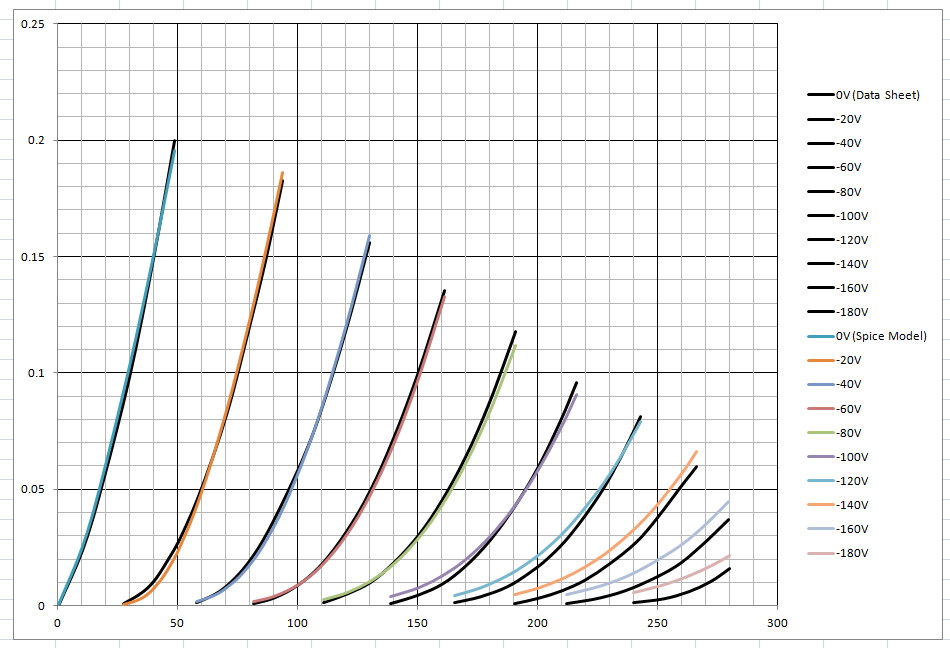

Color lines at 20V spacing vs Svelanta datasheet:

I determined these values for the Koren model using jackinnj's method (Graph Grabber creates a csv file for Excel's solver function to work on)
mu 2.666592541
ex 1.322510698
kp 8.257298215
kg1 488.0839349
kvb 51.7599108
Errors are small in the region of most interest, Vp from zero to 200 volts and Vg > -100 volts. At high Vg and low Ip, the error is larger.

Yes, Jack's excel solver is another good choice, I wish people would stop using Koren or Munro's models, since they are usually not that accurate. They were the pioneers of tube SPICE models, but there are better tools and models these days.

Here is the model using Richard's optimized parameters:
.subckt 6AS7 A G K
+params: mu=2.666592541 EX=1.322510698 kP=8.257298215 kG1=488.0839349 kVB=51.7599108 VCT=0.00 ccg=6.8p cpg=11p ccp=2.3p rgi=2k
RE1 E1 0 1MEG ; dummy so node E1 has two connections
Ee1 E1 0 Value {(V(A,K)/{kP}) * log(1 + exp({kP} * (1/{mu} + (V(G,K)+VCT)/sqrt({kVB} + pwr(V(A,K),2)))))}
GIP A K Value {(pwr(V(E1),EX) + pwrs(V(E1),EX))/KG1} ; Norman Koren's
R1 G 5 {rgi} ; for grid forward current
D1 5 K DX ; for grid diode action
CM1 G K {ccg}
CM2 A G {cpg}
CM3 A K {ccp}
RF1 A 0 1G
RF2 G 0 1G ; prevent floating nodes
RF3 K 0 1G
* .MODEL DX D(IS=1N RS=1)
.MODEL DX D(Ron=1 Roff=1G Vfwd=0.75)
.ends

SPICE Netlist Warning in schematic RefDes 'u1, u2', element 'ee1': Use of log() is ambiguous, simulation will treat this as ln() in this case. See the "Mathematical Expressions" section in the Multisim SPICE manual for details
Just keep peeling back the spice directives until you have something which doesn't yield these errors.
And with regard to any data capture regimen -- you've got to eyeball the data -- this is what those Asiana pilots didn't do, they relied too heavily on their instruments and didn't bother to look out the window.
fwiw, there are some triodes that, by virtue of their construction, don't lend themselves easily to simulation. and with regard to tubes, the variability is so high that what you simulate may not come as close as you'd like to reality.
working on tetrodes and pentodes at the moment.
You can embellish the error modeling by only allowing values in the region of safe operation, i.e. set up a test such that the error is zero if the I(observed) * Vak > Maximum Power Dissipation.
Also -- helps if you have a lot more datapoints in the "region of most interest".
