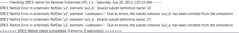

Well Multisim does not like curve captor's spice models or your model. I'm starting to think Multisim has it's own version of spice and that it does not like any others. All I know about SPICE is that it is like VHDL for simulation of analog circuits(that is all college has taught me about it so far) so I'm not knowledgeable enough to debug the code. I think it is best I give up on simulating the outputs as I have already wasted more time then feel having a complete simulation of my design is worth to me right now.
In case your curious this is what Multisim thinks of your model...
------ Checking SPICE netlist for Reverse Futterman OTL 1.2 - Monday, July 22, 2013, 5:02:23 PM ------
SPICE Netlist Warning in schematic RefDes 'u1, u2', element 'dx': Unknown model parameter 'ron', this parameter will be ignored.
SPICE Netlist Warning in schematic RefDes 'u1, u2', element 'dx': Unknown model parameter 'roff', this parameter will be ignored.
SPICE Netlist Warning in schematic RefDes 'u1, u2', element 'dx': Unknown model parameter 'vfwd', this parameter will be ignored.
SPICE Netlist Warning in schematic RefDes 'u1, u2', element 'ee1': Use of log() is ambiguous, simulation will treat this as ln() in this case. See the "Mathematical Expressions" section in the Multisim SPICE manual for details
======= SPICE Netlist check completed, 0 error(s), 5 warning(s) =======
Error message from simulation: doAnalyses: Timestep too small
Error message from simulation: tran simulation(s) canceled
I was able to fix the log () errors by changing log () to log10 (), but the other errors remain. Some of the CurveCaptor SPICE code errors in multisim are nothing more descriptive then 'time step is too small'....Seeing that almost makes me think the code is fine, and Multisim is just giving me the finger to tick me off...Or somehow locked out of successfully adding components not in the database on my version.
Yes, incompatible SPICE syntax is one of the most irritating problems with circuit simulators, different vendors all have their own preference of which variant of the SPICE languages that they use. The issue you are having may have a simple fix by changing the following two lines:
.MODEL DX D(IS=1N RS=1)
*.MODEL DX D(Ron=1 Roff=1G Vfwd=0.75)
"Time step too small" seems to be an issue with the convergence, this requires some tweaking of the default values in Multisim, perhaps other users will have a better idea of what to do...
