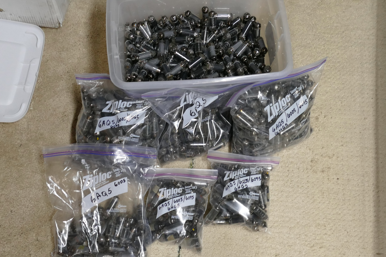

I have long stated that the 6AQ5 was limited to 10 to 12 watts of power output, and melted a couple dozen tubes to find a way past this limit. I have had several hundred 6AQ5's in a box for over 10 years because I believed that, but........

So haw can we do this with a 6AQ5?
I set out to find one possible recipe with the following criteria. Maximum power output, per tube plate dissipation limited to 15 watts, slightly over spec, but the amp must run at full power without tube glow in a dark room for an hour (tested with two different tube sets). Idle dissipation should be 5 to 8 watts per tube. Screen grid dissipation below the 2 watt spec for all operating conditions, load and B+ voltages could be anything, but commonly available OPT impedances should be chosen.....
I got my desired results at 400 volts of B+ with a 6600 ohm OPT and 200 volts on the screen. The control grid is driven positive for power outputs beyond 8 to 10 watts. Idle current was set at 17.5mA or just over 7 watts per tube. THD is 0.2% at 100 mW, 0.4% at 1 watt, and rises to 2% around 30 watts. On one set of tubes the screen dissipation hits 1.9 watts at 35 watts out, while the other set is at 1.6 watts at 35 watts out. Plate dissipation is right at 15 watts per tube for a plate efficiency of 53 to 54 %.
Both sets are sucking 3 to 4 watts per tube when pushed to 40 watts out, and the THD is over 10%, so most people would want to turn it down. Extended sine wave operation at 40 watts provoked mild screen grid glow in one tube and a pale redness on the plates in a dark room on three tubes. Plate dissipation was 17 watts per tube.
My guess is that 310 volts on the plates with 200 volts on the screen is OK, but monitoring the screen current during initial testing is needed to avoid over dissipation in the screen grid. The higher plate voltage I used actually reduces the screen current. This is all load dependent, and you didn't specify a load impedance. Higher impedances tend to reduce average G2 dissipation, but may raise it during clipping.
