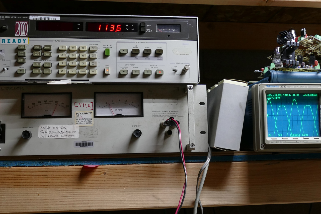

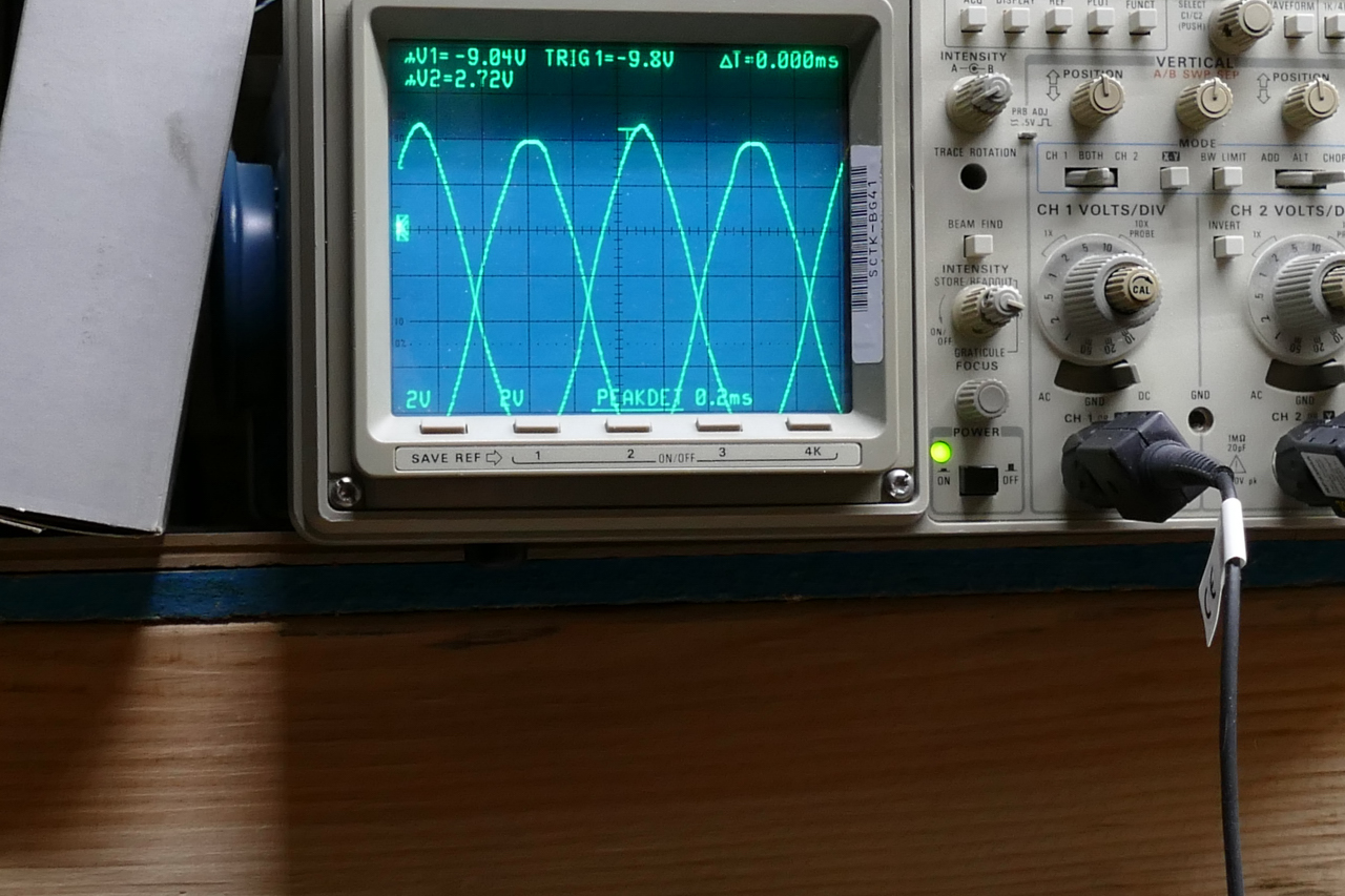

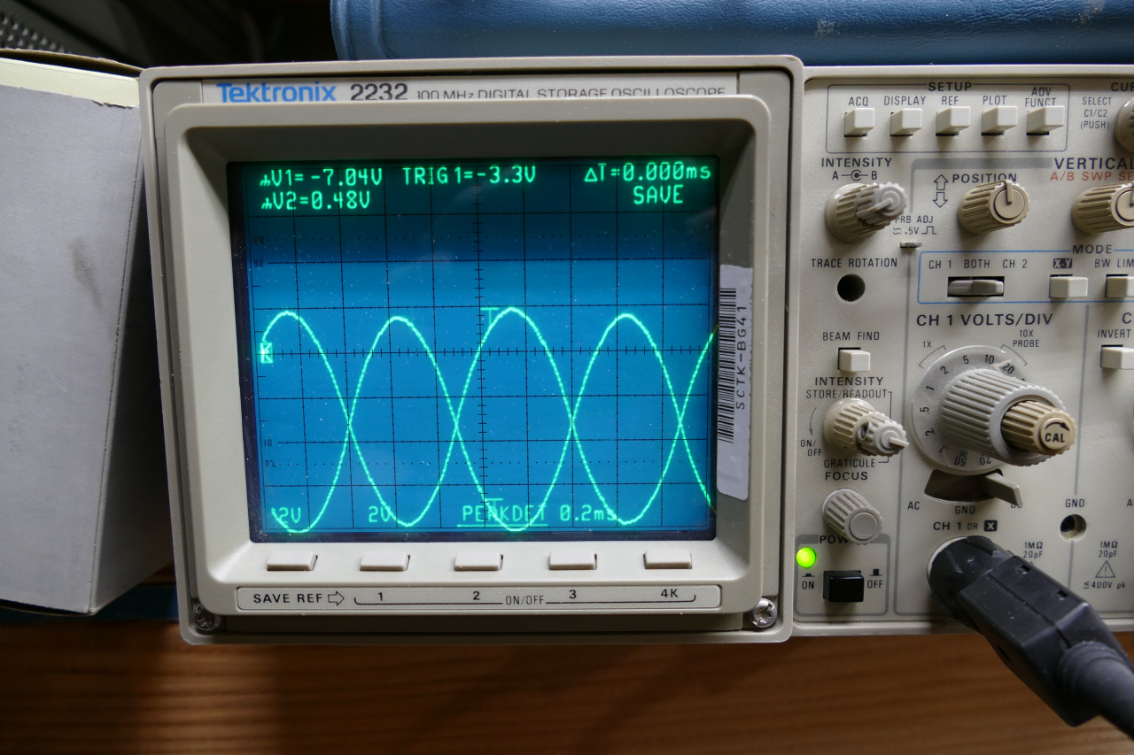

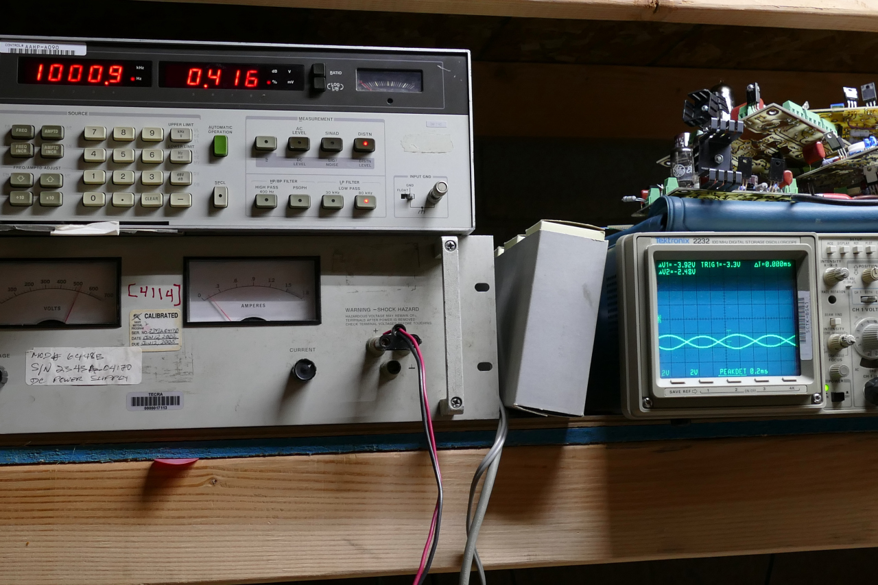

It is easy to see this process by sticking a small 1 ohm resistor in series with the cathode of each tube in a push pull amp. Then observe the cathode current waveform by connecting a scope across each resistor. You can see one tube turn off while the other is being driven. Then move the scope probes to the grids and look at what the drive signal does to get there. I couldn't find any cathode current pictures, but I did find some grid photos when I attempted to drive the grids out of some 6L6GA's.
The first picture show the drive signal at 60 watts out feeding a 3300 ohm OPT, about half what's recommended for a 6L6. The drive is a fat sine wave and one tube is obviously weaker and requires more drive. The grids are already being driven to +20 volts at this point.
The next picture is at over 100 watts out. The drive to both tubes is being distorted by the feedback loop in order to correct for mismatched and overloaded tubes.

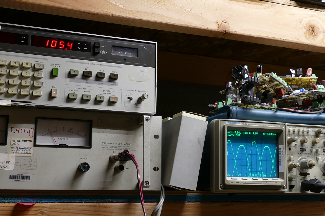

Next is the picture of the drive at 105 watts output just before it blew up. The THD out of the amp was under 5% but the drive signal to get there is ugly and different for each tube.
New cathode resistor, try again. THD is .4% power output is 10 watts.
Crank it up.....113 watts output on 525 volts of B+, real ugly drive, blew up again, game over for that night.
