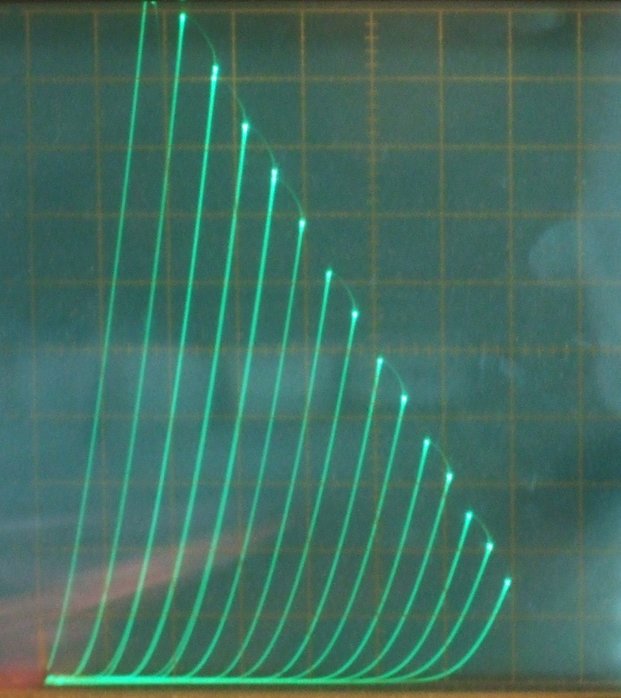

The 6AQ5 is emission limited by its lowish powered heater and tiny cathode. Even when pushed to the limit in A2 or AB2 it will not saturate its plate below about 40 to 50 volts, and that is the limiting factor in power output. Even within these constraints, but otherwise ignoring all other specs, I have been able to squeeze 20 watts from a pair on 340 volts of B+ without blowing them up. This assumes average music, not sine waves or over compressed dance music played well into clipping.

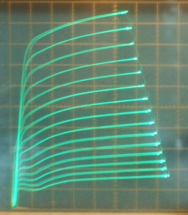

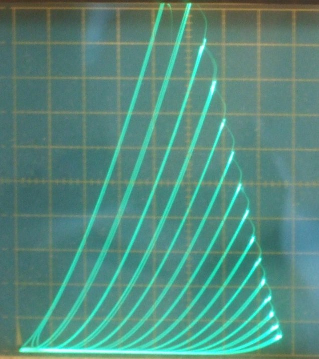

My testing shows that 10 watts is no problem and red plate doesn't start to show until 15 to 18 watts on most tubes. That's the first bit of good news. I stated that there are a wide variety of these little 5 watt tubes, and they are all different. The plates on any that I have abused are all good for 10+ watts, but they are not all created equal. I briefly mentioned the cathode capabilities when discussing the 6AQ5 and its 2.835 watt heater. As you mentioned the 50C5 has a 7.5 watt heater in a nice fat cathode. That turns out to be a good thing. That hot fat cathode puts out zillions of electrons. When driven hard in A2 or AB2 the 50 C5 can be saturated down to 15 volts or so putting them in TV sweep tube territory. What does this do for us, hoe about 25 to 30 watts from a pair of 50C5's while cranking out continuous sine waves at 2 to 3% THD , or anything else for hours without melting or even looking upset about it. Here the SCREEN GRID is the limiting factor the screen grid voltage spec should be respected. My testing was done with 120 volts on the screen, but 340 volts on the plates. The plate dissipation is under 10 watts per tube, but the screen dissipation touches the 1.25 watt limit somewhere between 28 and 35 watts depending on the tubes. This was done with continuous sine waves. Higher power could be acceptable when used with average music.

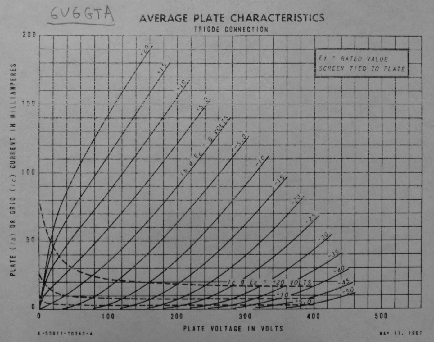

Note the published curves for the 50C5. The GE spec sheet that I have gives curves with zero G1 volts at various values of G2 voltage. Note that the G1 = 0 and G2 = 120 volt curve goes well over 150 mA, and the "knee" is around 25 volts at 120 mA. This is the sign of a tube that will exhibit good efficiency, especially when G1 is pushed positive (A2 or AB2).
I have not tested the 34GD5 since I don't have any. The suggested operating conditions for a class A radio is 35 mA on 110 volts, considerably less than the 50C5. The curves top out at 100 mA with zero G1 volts and 110 G2 volts, with a rather rounded knee. My guess is that this tube is also emission limited with a 3.4 watt heater, and may not be capable of the extreme power levels that I have seen from a 50C5.
On paper the 35GL6 with it's hotter 5.25 watt heater should do better, but I couldn't get more than 20 watts from a pair. The 60FX5 was also a disappointment. I suspect that some of the tubes that were optimized for "low drive requirements" give up power output capability to get high Gm.
The odd surprise in my testing was the 32ET5. These have a wimpt 3.2 watt heater, but a newer cathode coating formula. These babys can crank out 25 watts per pair on 340 volts into a 6600 ohm OPT.......8ut wait there's more.....I decided to sacrifice a pair in the name of since, so I set the power supply on 400 volts of B+, screen voltage 150 volts, load 6600 ohms, and hit the go button. What happened? 40 watts per pair happened......no big bang, no glowing plates, just lots of power. After about 10 minutes a pale red golo on both the plates and screen grids could be seen in a darkened room. This power level is probably safe on music, but who want's to push the tiny tubes that far. Measured plate dissipation is 13.6 watts per tube, but the screen grid is 1.8 watts per tube.......So, turn the knob to the right.......turning up the drive yielded 45 watts per pair, but a visible glow was on the plate and a rather obvious glow came from the screen grids. Measured plate dissipation was 17 watts and the screen grids were eating over 4 watts each....don't go there!
As with any operation beyond the specs YMMV. I have been way beyond the specs without blowing a single tube. You might not be so lucky.

1) 6JC5 in triode mode, 50V/div Horiz., 20 mA/div Vert. 4V steps (Mu around 7)
2) GE datasheet triode curves for 6V6GTA, 5V steps (Mu 9.8)

1) 12L6 triode mode 50V/div Horiz., 10 mA/div Vert., 4V steps
2) 12L6 pentode 50V/div Horiz., 20 mA/div Vert., 1 V steps, 125Vg2
