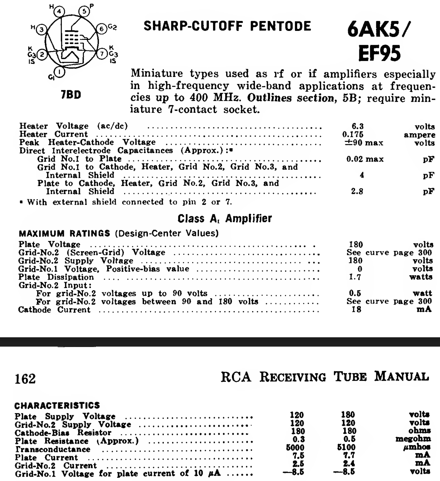

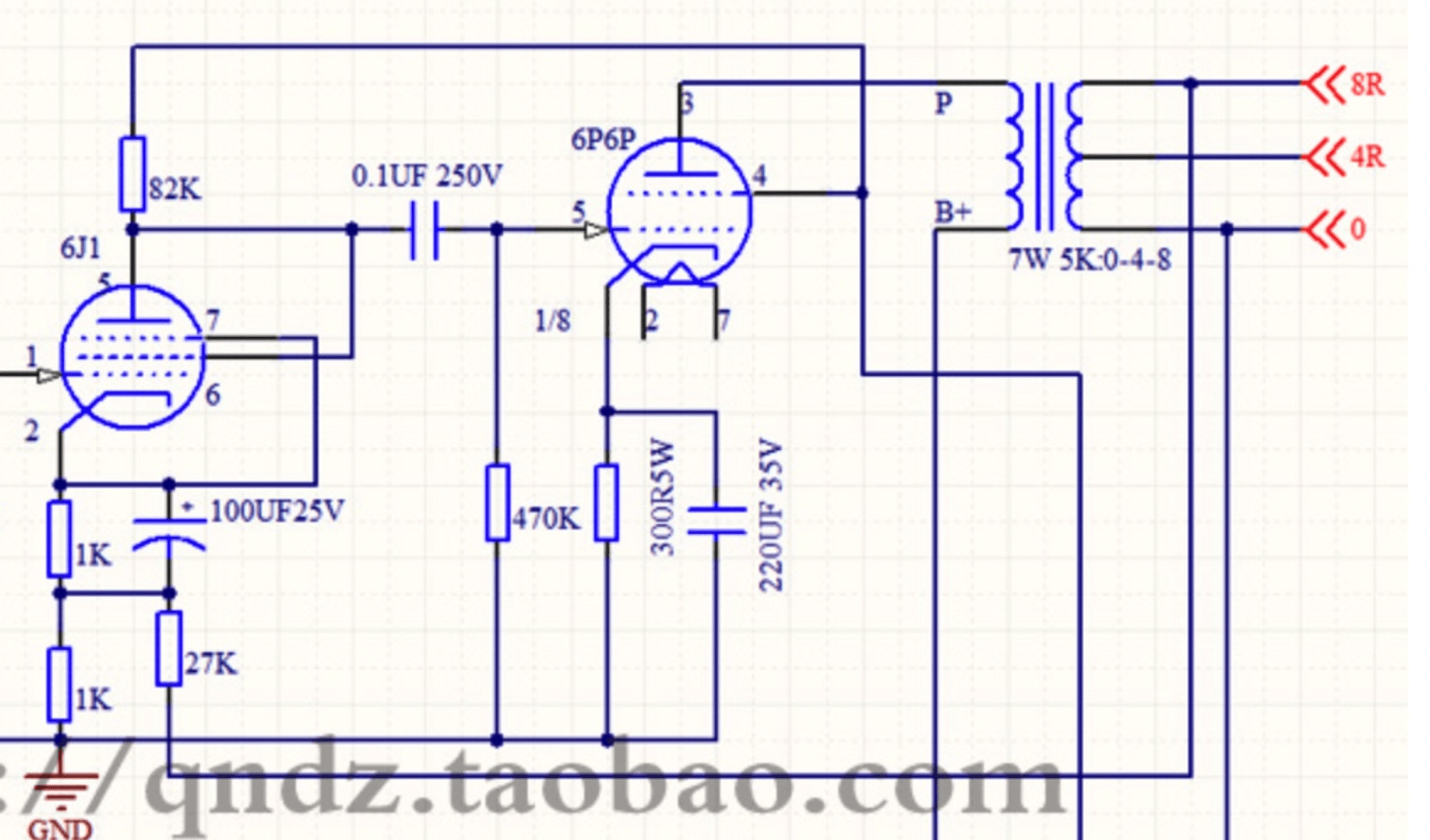

I have a bunch of 5654 tubes and some EL84's so would like to make an se triode amp using them. However, looking at this China circuit board which I bought and assembled, and sounds really good, the resistance values around the 5654 seem awfully high. Looks like a total of 2K for the cathode resistors when typically it seems around 470 ohms is normal. Measured voltage at the cathode is 3 volts, which I suppose is about right. The supply voltage to the plates of the 5654's is 225 volts with 20 volts dropped by the 82K plate resistor. Using ohms law that means the plate current is less than 1ma. This makes no sense to me.

Can you send more complete voltage readings?
What is the B+ to the 'top' of the output transformer secondary?
What is the voltage at the cathode of the output tube?
Are you using a 6P1P as the output tube, or something other than that?
Great, that all looks sensible.
It looks like the 6AK5 (6J1) is biased pretty cool. Plate current is only 1.5mA. The 6AK5 plate+screen current runs through both the 1k cathode bias resistor (bypassed by the 1000uF capacitor) and the 1k resistor 'below' that, to ground, which also is the bottom half of the voltage divider setting the level of NFB.
Granted the actual Ip+sg of the 6AK5 is actually a little less than 1.5mA because the (very) small amount of current through the NFB voltage divider adds to the Ip+sg of the 6AK5. But I think Ip+sg = 1.5mA is close enough.

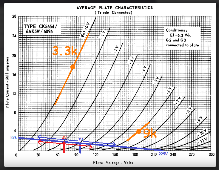

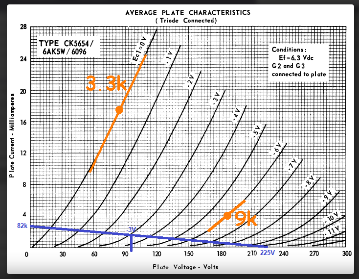

This is the loadline I see for that 6AK5-triode input stage:
You could probably change the value of the 1k cathode bias resistor if you really want to. The NFB is set by the 27k/1k voltage divider, which operates outside of the 1k//1000uF cathode bias network. I'm not sure what that would accomplish, since the chosen operating point looks on the warm side of central on the loadline already, and you don't want to run the input stage into grid current prematurely.
I'd say unless you're motivated to redesign the amp for yourself, you might as well enjoy it as is. Unless, of course, you find it lacking in some way...
rongon I've been messing with the value of that cathode bias resistor, changing it to 500 ohms instead of 1000. That reduces the bias to 2.5 volts which sounds more pleasant to me. Looks like that puts in in a more linear portion of the tube if I am not mistaken.
Don't forget that biasing the input 6AK5 hotter means it will not be able to swing as many volts into the output tube and into the negative feedback loop.
With the 6AK5 biased the way it was stock, it can swing +/-60V peak, which is 5X the peak volts needed to drive the 6V6 to clipping. The remaining gain is available to drive the negative feedback loop, which means there's up to 14dB of NFB possible.
If you increase the bias from -3V to -2V on the 6AK5 cathode, the plate current only goes up by about 300uA. However, the available voltage swing from the 6AK5 plate is cut in half, to only +/-30V peak. That's now only 2.5X the peak volts needed to drive the 6V6 to full power, which means now there's only 8dB of NFB available.
I figure distortion from the 6AK5 due to grid current will become significant when the input signal swing drives the 6AK5 to about +0.5V on the cathode (-0.5V bias).
With the 6AK5 roughly center biased (blue line with arrows labeled "-3V") you can see that the grid voltage can swing -2.5V from -3V down to -0.5V.
But if you change the bias voltage to -2V, now the input can only swing -1.5V from -2V down to -0.5V. That is a significant reduction in available output signal voltage from the 6AK5-triode.
As you can see, you can increase the current through the 6AK5 by reducing the value of Rk, but that has consequences other than simply running the tube hotter. Have you spent much time drawing load lines for various triodes, to get a feeling for how changing Rp and Rk changes the available output swing and other characteristics of a triode stage?

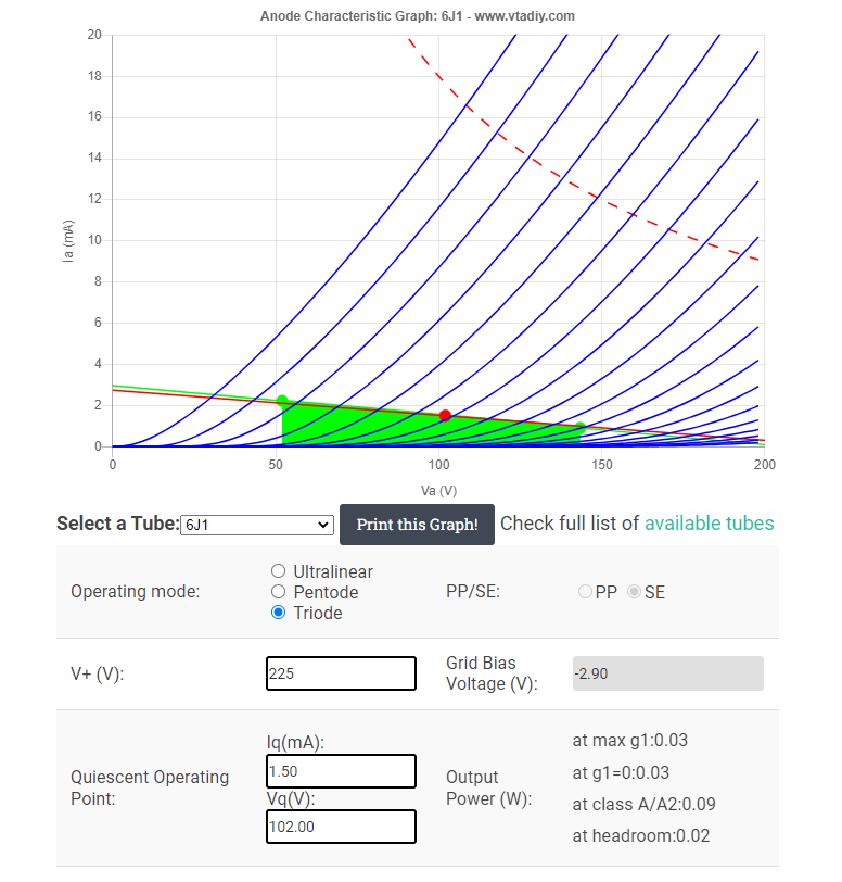

You can get a feel for this by playing with this neat online loadline calculator:
https://www.vtadiy.com/loadline-calculators/loadline-calculator/
6J1 is in the list of available tubes, and you can set the tool to triode too.
